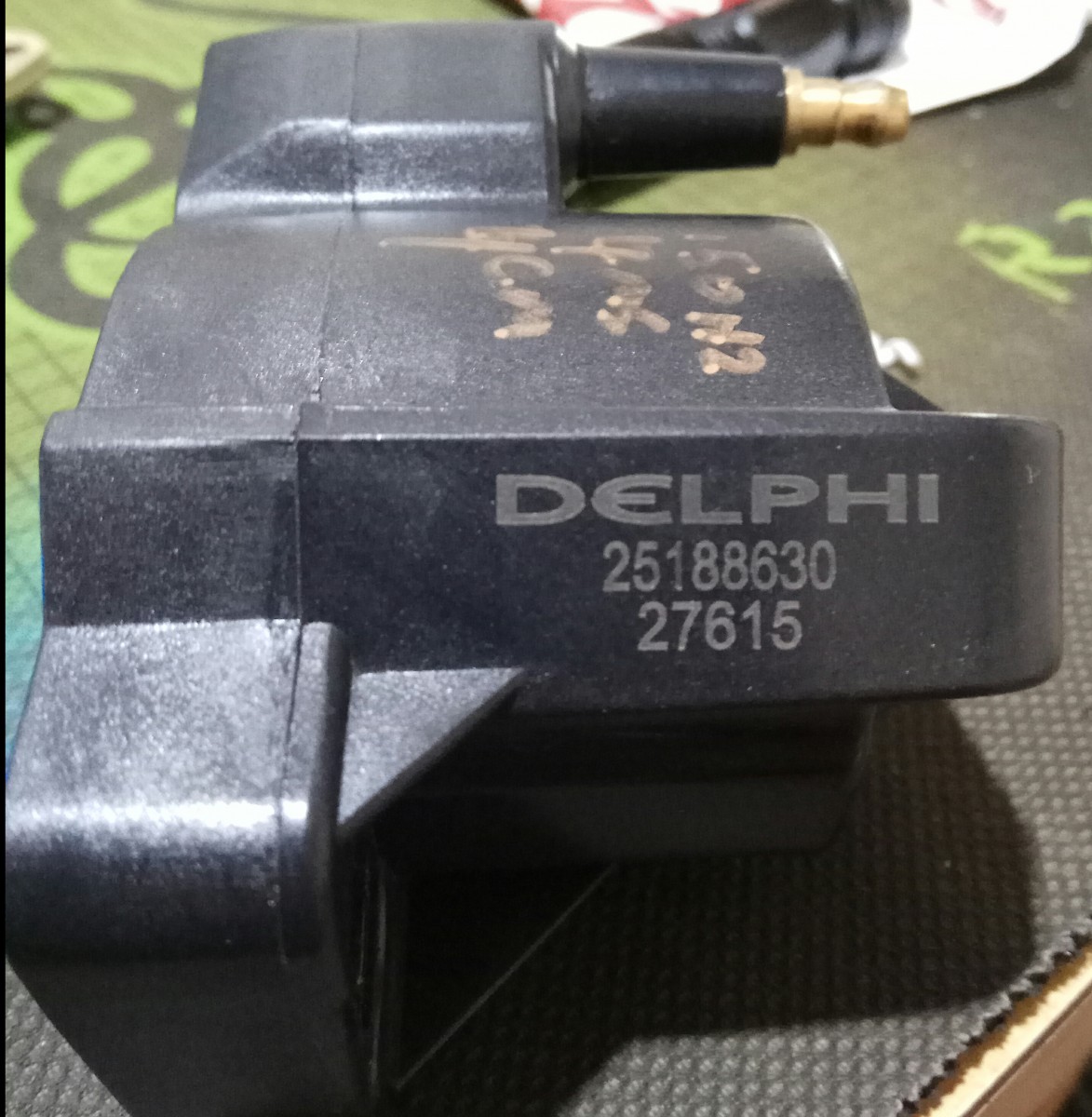

Updated the results on first page, looks like my delphi coil was not genuine, i got another one which has Delphi stamp on the side with the GM part number, the other one was identical but no stamp on the side which performed the same as stock, but this genuine part performs the same as the lowest MSD coil, i need to get a couple more i think and some new MSD's to test, but it's all starting to cost lol i think ive done what i aimed to do and some more, also tested LSX coils, im not sure which model specific it is but its used OEM GM so ive put the part number in. Ive updated the graph to include used/new
- Posts: 4853
Re: Coil Pack Testing
Here's the genuine Delphi coil with the 45mm result, grey bottom like old OEM ones and gold posts

I think there's only 2 LS style coils from GM. LS1 and anything later LS2 3 7 98 etc all ran the same from what I've come across.
