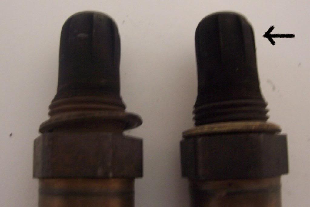

Thanks Holden202, the battery was disconnected when the new sensors were installed…apart from a possible transmission issue (may just require a service), the beast is back on the road…both O2 sensors were in a bad way, the malfunctioning one (arrow), badly “carboned up”….both replaced
the spark plugs were also replaced for similar reasons….the right bank were in bad condition after just 20000k (these are GM replaced by Bosch), engine running very rich…mainly the right bank
the connecting wire to the left hand O2 sensor also appeared shorter, even though it is oem, held away from the hot transmission by a spare wire lying around (arrow) and also the new sensor in exhaust manifold (arrow)…
The new sensors installed, the engine was checkd using a carman scan tool and all found to be fully operational…
