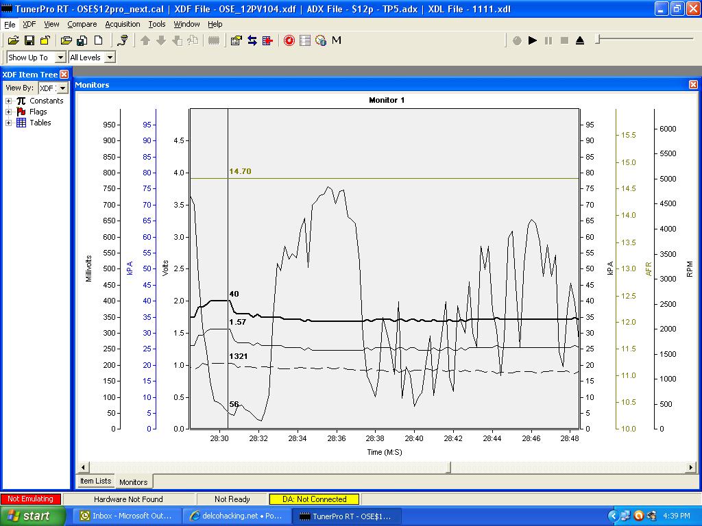

heres a log of my o2 sensor

Interesting, my o2 sensor may be not as crazy as I thought. Everything I read or see describes a pretty clean sinewave pattern & anything else is considered a dud. Even on a steady cruise I would not call my pattern a sinewave, just cyclic with the period shortened or extended depending on how steady the load.
Have a genuine 2 bar MAP as a reference that I have used on occassions but logs for it do not show dramatic difference to diy. Have logs for all three that show min kPa seen as: factory 1 bar is mid 20s, factory 2 bar high 20s & diy mid 20s. However easy enough to change & see what happens.
I get high 30s, low 40 kPa. What is typical value for idle?

30-40kpa at idle depending on idle timing...
you need to change your monitors so they display in different colours, too hard to read whats what there.

Your O2 sensor does not seem to be getting that many cross counts compared to a healthy one. What sort of cross count numbers are you getting? I would be going back to a pre-ve learn cal, turn VE learn off and log the BLMs.When using VE learn do what yoda69 suggested and disconnect the carbon canister, it will skew the learn a fair bit.
If you want to compare yours to the genuine, hook up both MAP sensors and log them. Use either sensor on the normal MAP input and then use the wideband input for the other. Change the wideband config in the cal so it does no conversion and in scannerpro change the widband calc to that of a 2 bar MAP sensor. Overlay both sensors on scannerpro monitor and see how close they are.

VL400, lots of good suggestiions I will work through but need some help.
With the o2 count question. I get numbers 1, 2 or 3 but they just appear random & then resets to 0 for longish periods, never a consistantly high count number. Is count value = number of o2 transitions in a given period.
May be if I confess that o2 sensor is original some 390,000 km old, you are going to say "change it". Have read that o2 sensors can go slow when they get old, not necessarily fail out right. Could be my problem as although sensor cycles <300mV & >600mV, it still may not be giving good feedback.

o2 cross counts is the amount of times it swings from rich to lean, the higher the better, and the less there is the more lazy your sensor is .....
i've seen stable cruising show 10-15 cross counts so if your not getting somewhere near 10 you've probably got a dodgy sensor......
