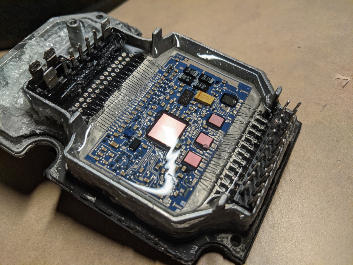

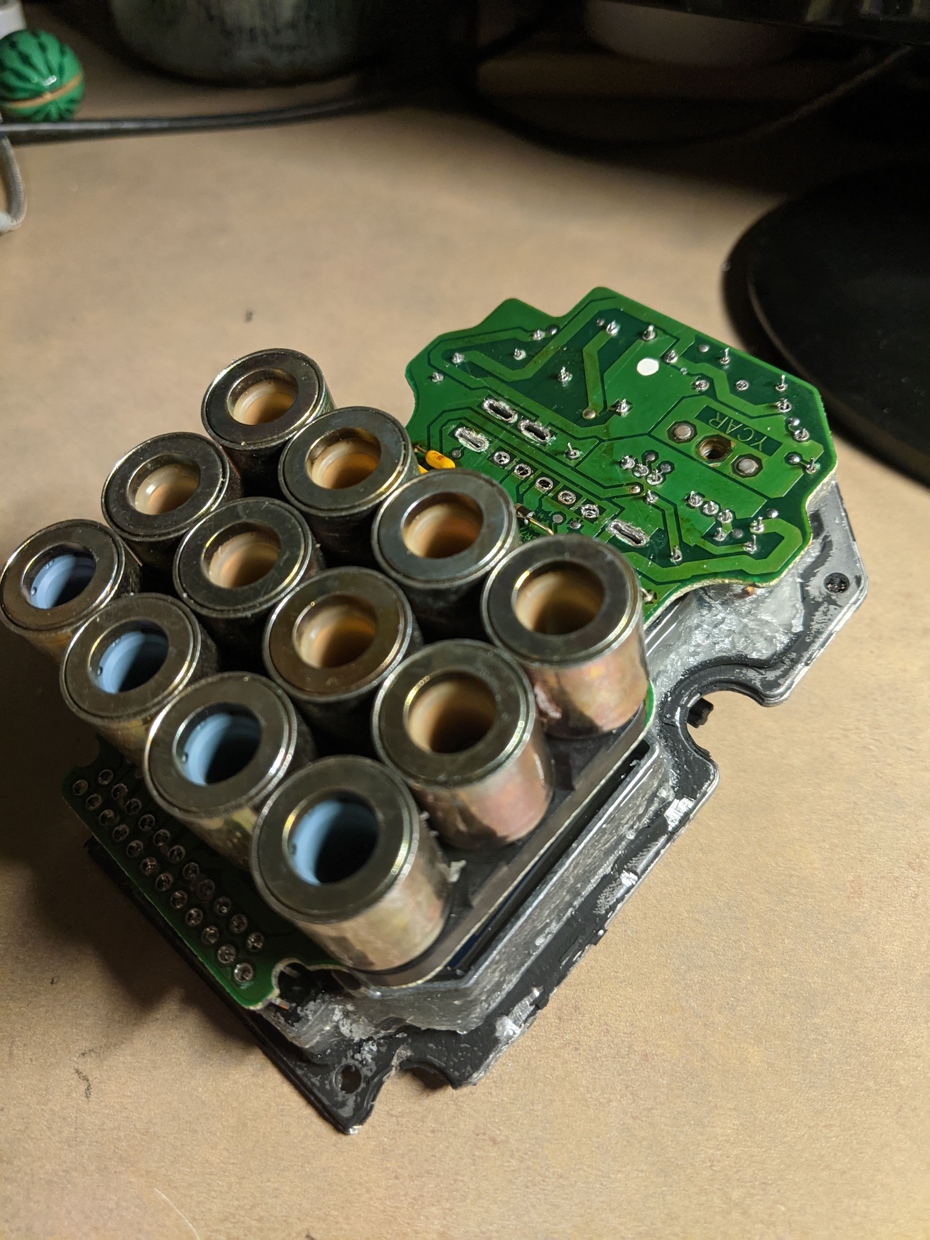

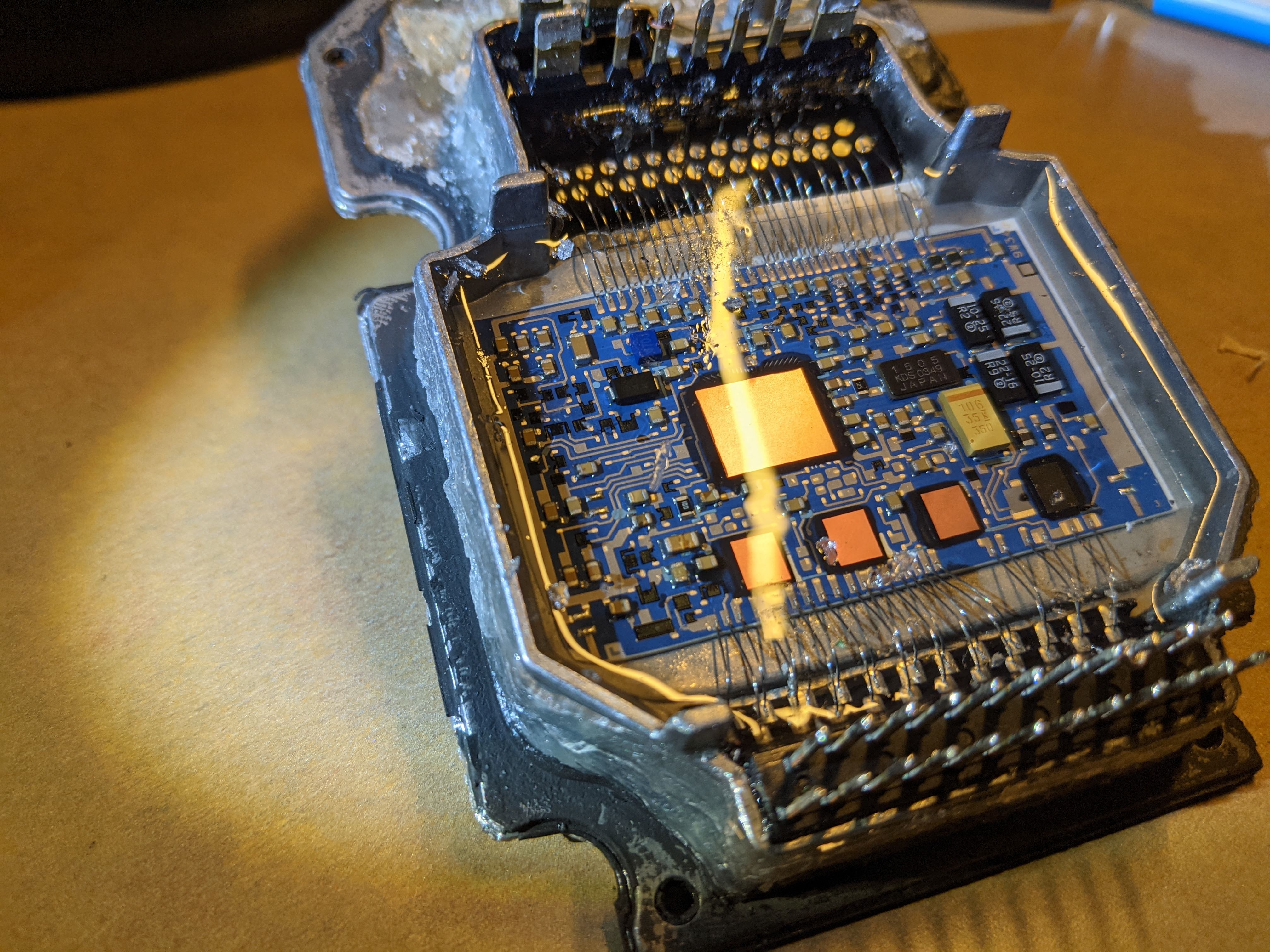

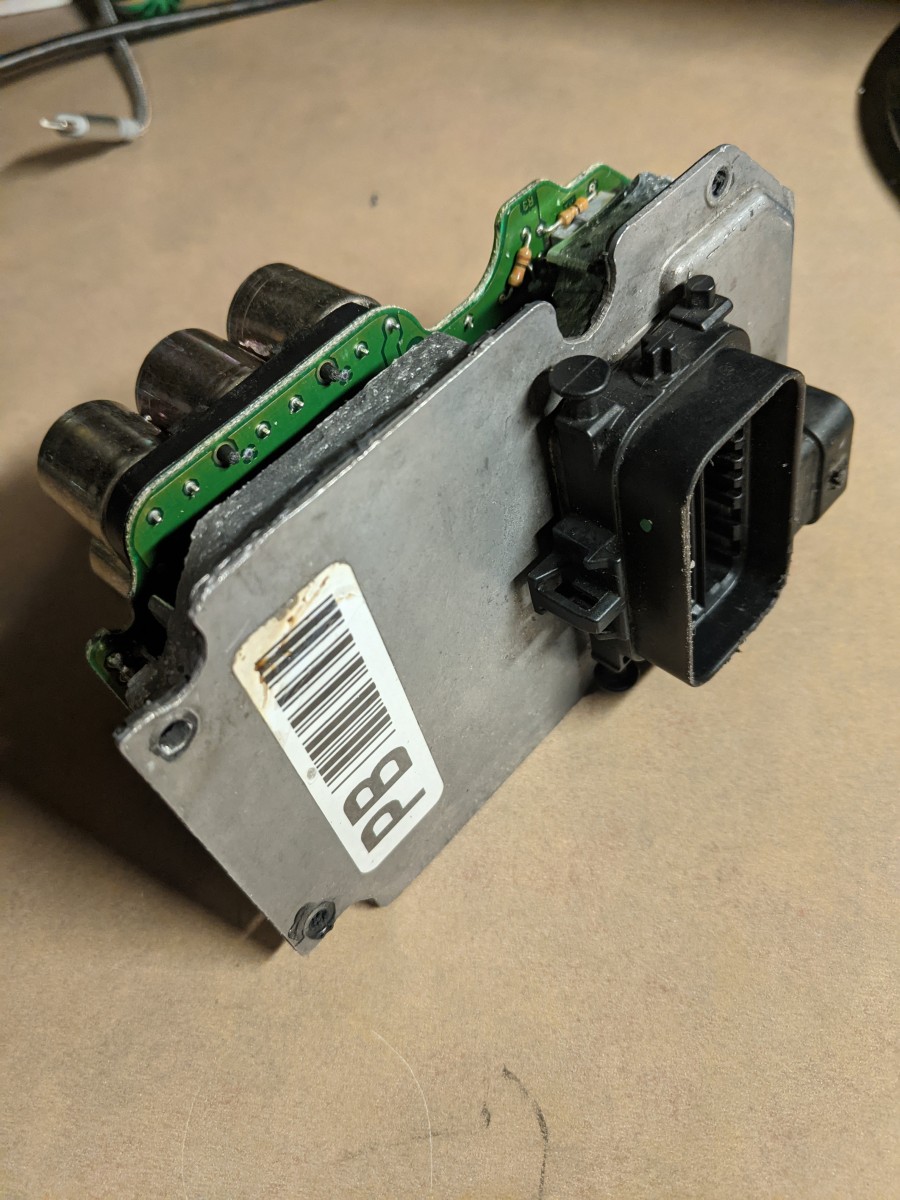

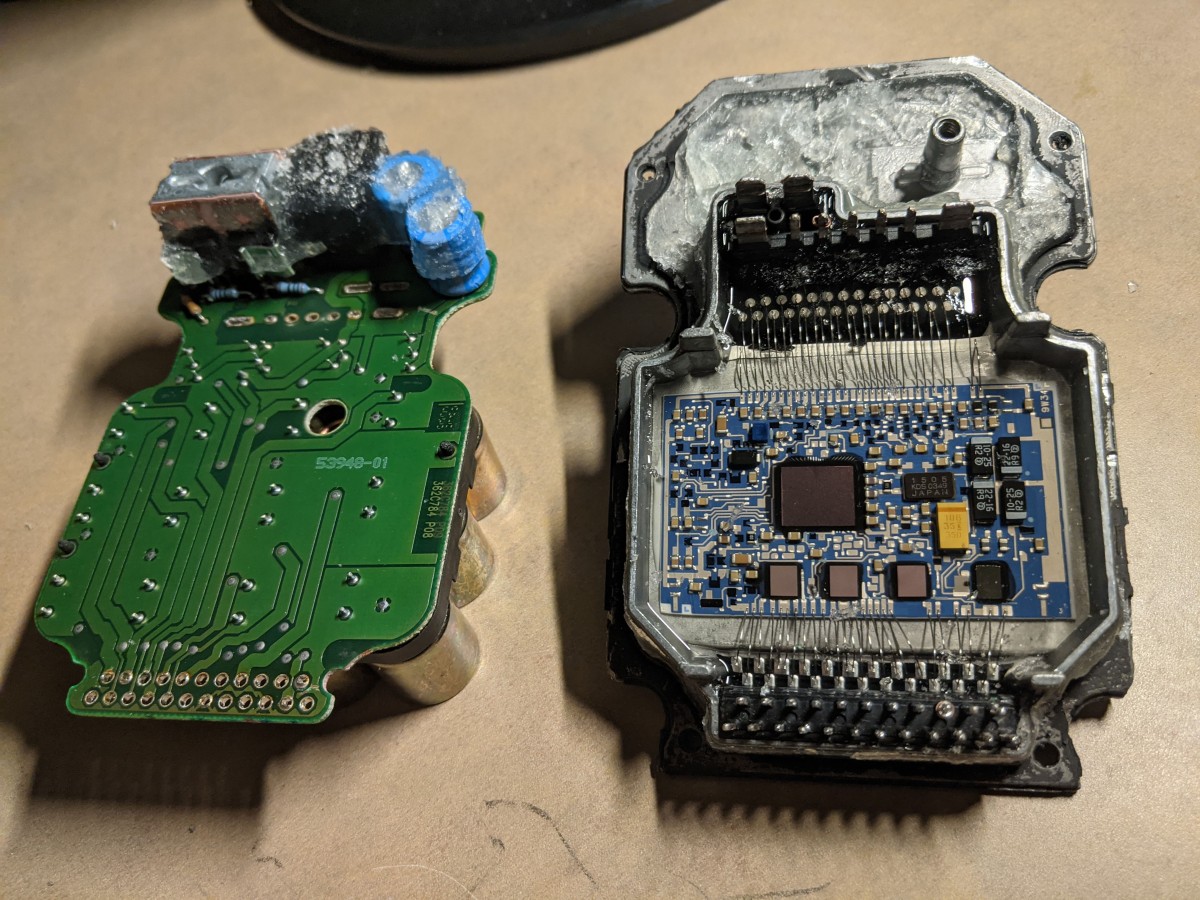

Good news: I took mine further apart
Bad news: the CPU chip has a cover glued to it, so there's no much new information
I had hoped to find a chip with a visible ID that would lead to a data sheet, but no such luck.
And the whole thing is encased in a clear goo that is almost liquid. I poked in with a pick and tried to pry the cover off with no luck. I suspect that the black stuff around the edges is epoxy.
Close-up of the CPU board
CPU board
CPU board
Underside of the solenoid board, and inside of the CPU board.
Outside of the EBCM
Outside of the EBCM
Upper and lower boards, after desoldering.

Well that is interesting... Now I'm wondering how hard it would be to actuate those valves then... Is the only option for us to design a new board that controls that actuator board? Those look like bond wires suspended in the potting material? I'm not sure what those would be. Very interesting.

I hate modules that have that bullshit wire bond stuff. The T42 TCMs and E55 ECUs also use them, I could never identify what the chips were.
Posts: 4810
Re: ABS Hacking
2nd that potting is good for waterproofing but that's it.

In-Tech
Posts: 785
Location: California
Re: ABS Hacking
Post by In-Tech »
Would those be toroid's for signal conditioning? The other side of the board is very similar to the insides of the MEFI controllers with the goo and the tiny wires from board to pins.
