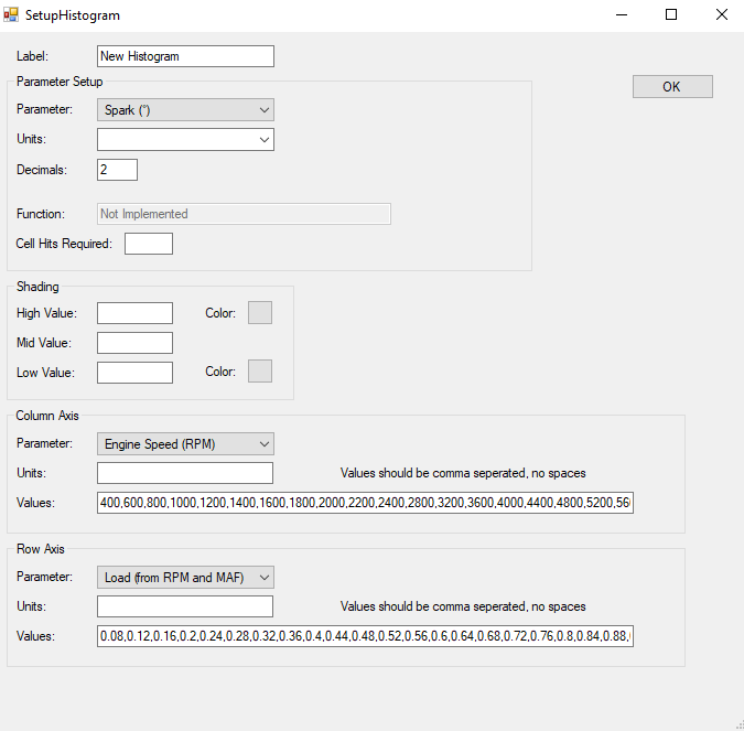

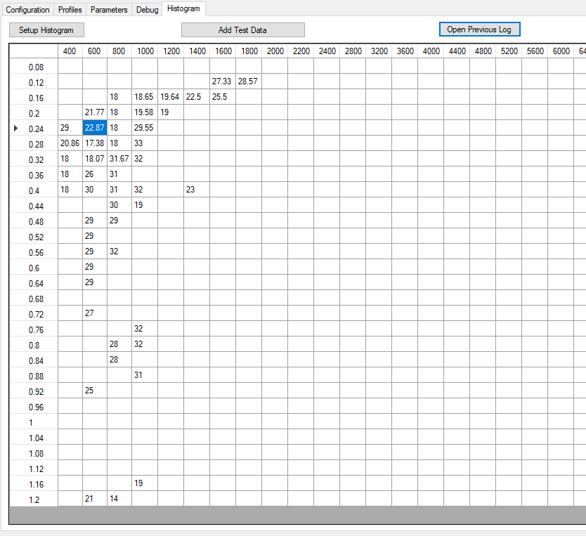

Hi all,
I've been working on creating a histogram page for PCM Logger, similar to what HP Tuners has. Right now I have it adding values to the histogram when the UI updates. It can also read in a previous log file .CSV and display the values from that. It supports column and row or just column tables.
Right now, to select what cell to place the value in, it just picks the column and row value that is closest (PcmHacks/Apps/PcmLibrary/Logging/Histogram.cs:97). Is this how HP tuners and other programs do it?
When you open the Setup dialog, either by opening a CSV, or when setting it up to log in real-time, it gets the available parameters and displays them for the user to select. You have to specify the column and row header values. HP tuners dialog box was the main inspiration (Though I've never used HP Tuners, just based on a youtube video).
I still am working on some bugs and beautification. I want to be able to color the cell based on the value, but DataGridView doesn't support colors with Alpha values for the BackColor property. Apparently the WPF DataGrid does, so I'm going to look into using that inside of a WinForms application.
I also want to add the ability to save and load the setup to a file similar to the LogProfile. I also need to add the row and column labels
I uploaded the code to the histogram branch on my github fork of the project. I will make a pull request once I feel its close to being done. https://github.com/nsafran1217/PcmHacks/tree/histogram . My code is based on the develop branch.

Just thinking out loud here:nsafran1217 wrote:I still am working on some bugs and beautification. I want to be able to color the cell based on the value, but DataGridView doesn't support colors with Alpha values for the BackColor property. Apparently the WPF DataGrid does, so I'm going to look into using that inside of a WinForms application.
A lot of the value of DataGridView is in its support for different data types, and user interactions like editing cell values, resizing rows and columns, etc... If you're content to just render numbers, you might consider dropping DataGridView entirely, and just do all of the rendering yourself using WinForms graphics APIs. Then you can do whatever shading you want - just draw a colored rectangle, and then draw text over it. Use a nested loop to render the whole grid, and a couple more loops to render the X and Y axis values.
The catch is that if you want users to be able to interact with the grid, that sort of thing takes work. But it might be sufficient to just draw it.
I hadn't thought about adding log-viewing features to this app, but now you've got me thinking that was a huge oversight. Not everbody has Excel, and not everybody who has it wants to deal with that complexity. So I kinda like the idea of adding a "View Log..." button on the main tab, which would open a file-picker dialog, and after the user picks a file, we'd would open a tabbed dialog that has the log contents in a simple grid, plus additional tabs to show histograms and whatever other ideas we can come up with - scatter plots, line charts, etc.
Is that something that people would use?

That's a good idea. I'll start down that path after I get the profile feature finished. I spent 3 or 4 nights trying to get WPF DataGrid to work, but I just can't figure out the data binding. I was able to get it to display, but I never could change colors. I've never worked with the graphics APIs, but they are probably easier than WPF DataGrid. And probably faster than a datagridview.NSFW wrote:dropping DataGridView entirely, and just do all of the rendering yourself using WinForms graphics APIs
I still wanted to have the ability to copy out of the table, so maybe I can have a DataGridView window open that just displays the values. Or have a datagridview where you can paste the table from your tune, then do some math on those values based on the histogram table.
I think having log viewing capabilities built in would make tuning with PCM Logger and TunerPro more accessible to people. I imagine some people would get a CSV file of data and have no idea what to do with it.

Just added "Paste special" -function to UniversalPatcher, so you can paste values from histogram.
And literally just added, need testing and probably fixing...

Setting cell color in datagridview:
dataGridView1.Rows[r].Cells[c].Style.BackColor = Color.FromArgb(alpha, red, green, blue);
Edit. Or:
dataGridView1.Rows[r].Cells[c].Style.BackColor = Color.Aquamarine;

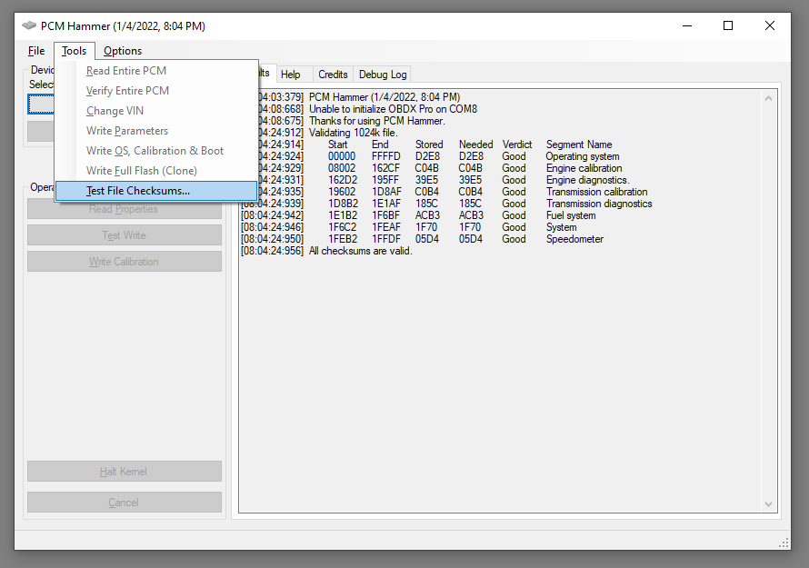

New features in the pipeline for the next release:
- if you add a logging parameter that the PCM doesn't support, the app will tell you so, rather than just reporting 0.00 for that parameter (working on my desktop, not checked in yet)
- a new menu item to test checksums, without connecting to a PCM (checked in)
Under consideration for the next-next release: Don't even show unsupported parameters in the list. I'm open to ideas about how to do this. I lean toward this approach:
When the logger connects to a PCM, it gets the OSID and looks for file with a name like "OSID.pids.xml" - if the file doesn't exist, it tries every PID and saves the a list of supported PID to the file. This process would take a while (hopefully just a few minutes but I really don't know), so it would be good to collect these files and check them in. If the file DOES exist, it would just use the file to filter unsupported parameters from the list.
