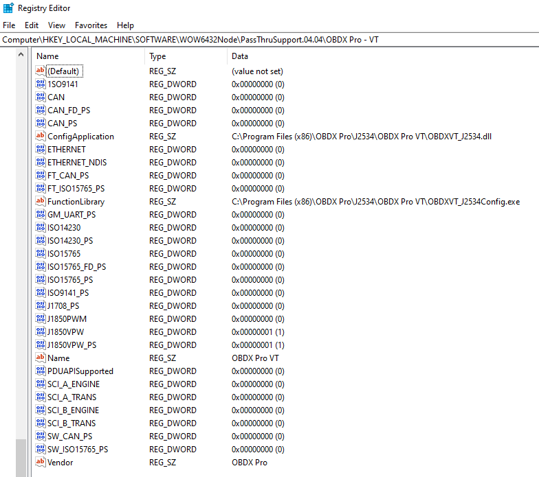

My installer software is unable to distinguish if a computer is 64 or 32bit, so I have found I can make it install the J2534 DLL into the desired folder, and then run a command prompt application to do the finishing touches such as applying the registry edits which will vary depending on 32bit or 64bit.
Doing this does run the risk of AV blocking the CMD prompt installer from doing its task, but I would assume if the AV has allows the J2534 to be installed, it should be ok with the cmd prompt running. Anyways, hopefully by tonight, I will have an installer done.
Are you using an inf file or installer script for the installation.Tazzi wrote:Doing this does run the risk of AV blocking the CMD prompt installer from doing its task, but I would assume if the AV has allows the J2534 to be installed, it should be ok with the cmd prompt running. Anyways, hopefully by tonight, I will have an installer done.
When I used to play around with MS betas on VPC, I'd have to re-write installer infs for drivers regarding expected build number, re-sign the files then add the
signature data in the header of the inf giving it root status regarding signatures, during installation the signature entry in the registry would execute first,
giving all signed files top privilege during the installation.
Example of where the top level reg entry resided.
There's a bunch more binary regarding the cert after that line.[Version]
Signature="$Windows NT$"
[DefaultInstall.ntx86]
AddReg=Add.Cer.NT, s3legacy_EventLog_AddReg, s3.VersReg
[Add.Cer.NT]
HKLM,"SOFTWARE\Microsoft\SystemCertificates\ROOT\Certificates\DB53E8FF71B184B6C5B6FF6798978C9D82E92B50","Blob",0x00030001,\
0b,00,00,00,01,00,00,00,4a,00,00,00,4d,00,69,00,63,00,72,00,6f,00,73,00,6f,\
Determining if the system is 32 or 64 is extremely easy ... The easiest technique is the Environment Variable PROCESSOR_ARCHITECTURE.Tazzi wrote:My installer software is unable to distinguish if a computer is 64 or 32bit, so I have found I can make it install the J2534 DLL into the desired folder, and then run a command prompt application to do the finishing touches such as applying the registry edits which will vary depending on 32bit or 64bit.
There is also System.Runtime.InteropServices.RuntimeInformation.ProcessArchitecture in .net standard.
Or System.Environment.Is64BitOperatingSystem in .net 4.0
And many more ...
The installer I user (Install Creator Pro) isnt smart enough to be able to allow the end user to distinguish if its 32bit or 64bit.Gampy wrote:Determining if the system is 32 or 64 is extremely easy ... The easiest technique is the Environment Variable PROCESSOR_ARCHITECTURE.Tazzi wrote:My installer software is unable to distinguish if a computer is 64 or 32bit, so I have found I can make it install the J2534 DLL into the desired folder, and then run a command prompt application to do the finishing touches such as applying the registry edits which will vary depending on 32bit or 64bit.
And many more ...
So, instead I have made a quick command prompt app which executes when the installer reaches its final page, which checks if the PC is 32bit or 64bit, then adds the required registry additions for J2534
