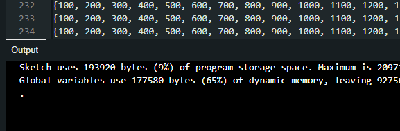

For the hell of it, I tried again.
Arrays are 65 * 129 now.
I must have missed something before.
Noise looks the same. Memory usage is still fine. Replaced 600 with 300

Not sure what I did before where 64x128 wouldn't work. But 129x129 blows through all the RAM lol

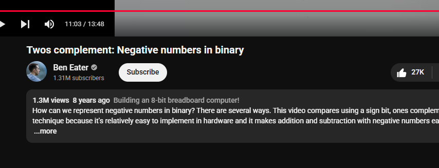

Was wondering how to do an array of bytes as my fractional fixed point numbers while allowing negative values. Apparently simple answer is, you don't. So those arrays of 8 bit values will be stored as 32 bit values... whatever, moving on.
Debated with myself whether to do + and - for spark. Going to keep going with spark and fueling using the same code for everything. Multiply by a fraction.
https://www.youtube.com/watch?v=4qH4unVtJkE This guy's stuff has been quite a help with understanding the low level stuff.

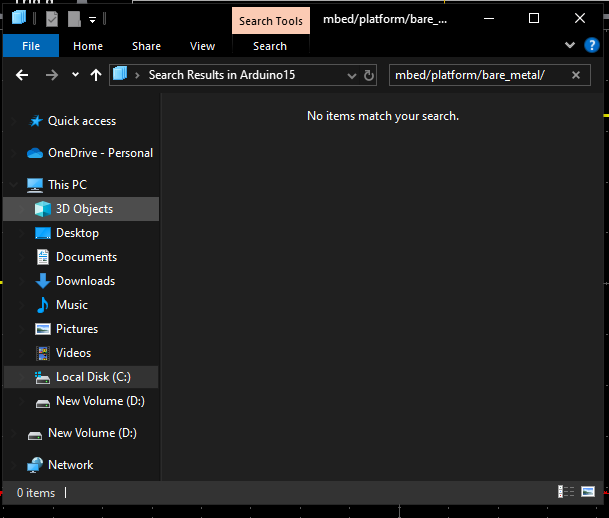

Well damn.AngelMarc wrote: Sat Jun 14, 2025 5:04 am Was stabbing in the dark with includes.
Gives a drop down of options.
SeenCode: Select all
#include <mbed/platform/bare_metal/
Looking for those files now.
File explorer has been searching the Arduino15 folder for about 20 minutes now...

Yes he covers the concepts very well and easy to understandAngelMarc wrote: Sat Jun 14, 2025 11:09 am
MPC001
- Posts: 188
- Joined: Sat May 05, 2018 11:41 am
Re: Coding my own aftermarket ECU
If it's the same subject/question, E38 etc does negatives using 16 & 32 bit signed numeric for +/- 127 upward etc and then factors the value. Guessing you probably already aware & I am misunderstanding the questionAngelMarc wrote: Sat Jun 14, 2025 11:09 am Was wondering how to do an array of bytes as my fractional fixed point numbers while allowing negative values. Apparently simple answer is, you don't. So those arrays of 8 bit values will be stored as 32 bit values... whatever, moving on.

I don't know why the hell I thought I needed negative. Multiply by a fraction like .95 gives lower, 1.05 goes higher. Both equal 5% change.
At least this time wasn't most of a day like the logarithm stuff.
