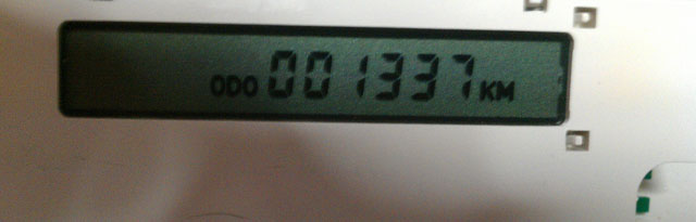

The1 wrote:Image
I was going to post the same pic, but wasn't sure anyone else would get it :mrgreen:
Congrats on nailing it - i imagine it's been driving you nuts being so close!

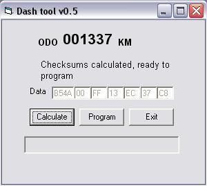

My program isn't much use without my hardware, and I don't have any plans to release either of them.
So I'll just share another screenshot for now ;)
