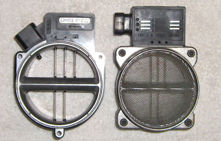

just an apology misinformation from me, i was calling the recommended MAF a LS1 MAF when it's actually used on LS6 engines. Here's a photo showing the LS1 Right and LS6 MAF Left. I am not sure what the LS1 MAF range is i believe they are 88mm, they also plug straight into the existing loom. The LS6 MAF needs a splitter as it has IAT sensor built in.
From the OP, this is the correct info on the MAF below and i have used it with enhanced MOD and will work upto 14710hz which matches the tables we have setup, the VS-VY PCM Hardware limit is 16,000hz we could add further tables if needed if a MAF that can scale that high is found.
Delphi Part AF10043 or GM#25168491 95mm.

so can you use the ls1 maf or will the frequency be off?
Posts: 4812
Re: Enhanced Factory Bins
you can use whatever maf you like ;)
It's obvious with using a bigger MAF you will get more airflow so more fuel and you will need retuning.

I have been using the ls1 maf but modified the tables using data from this thread.
https://pcmhacking.net/forums/view ... 9&start=20
Note that using the data it doesn't use all 12 tables so maybe less resolution in mass figures.
Has been working okay for me so far. :)
Posts: 4812
you can do it how you like, drop in a factory table for the MAF your using if you want, though there's no point really, the MAF will still output the same frequency per metered airflow regardless the code just needs a reference so it can change fuelling as airflow increases or decreases.
