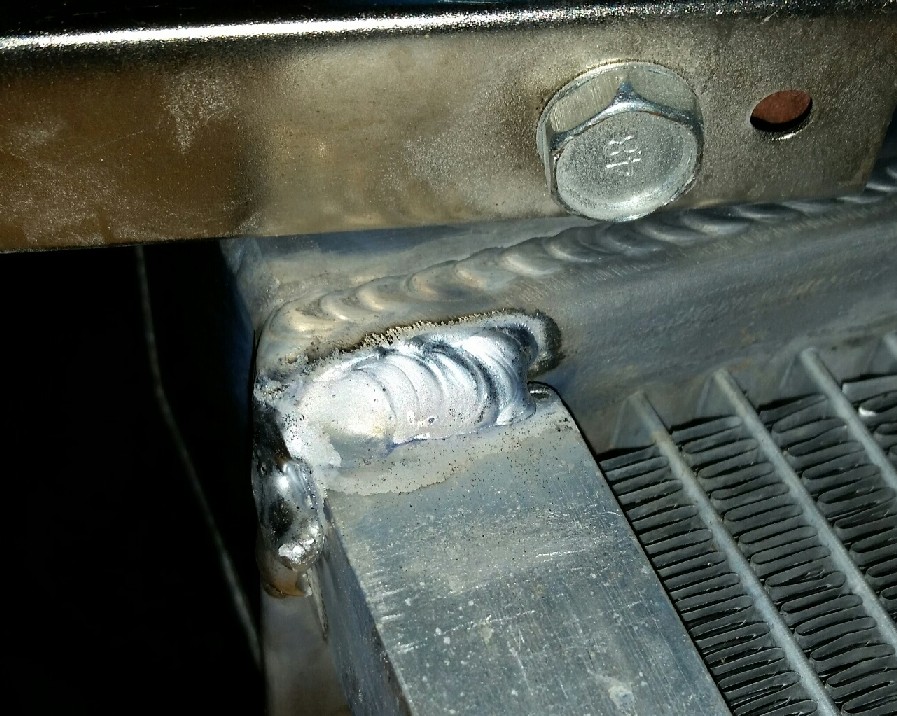

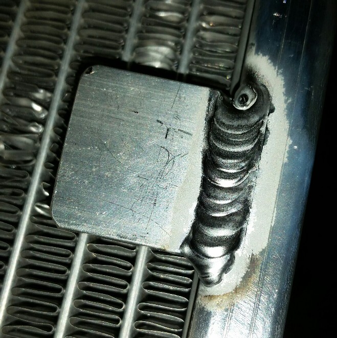

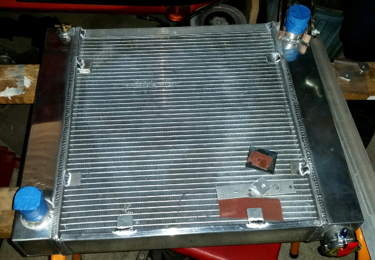

Firebug has been having some issues with his thermo fan attachment to the radiator, so he wanted to remedy it which required some welding of tabs onto the radiator to attach a proper shroud/fan assembly.
This wasn't my first attempt at alloy, but probably the first one i didn't want to fuck up
So there is a piece of angle welded to the botton of the radiator because there wasn't alot of options at the bottom for mounting, this also covers the entire bottom so it should stop air going around the radiator from the bottom rather than through. (the top of the picture)
This is one of the earlier welds i did it was ok but certainly not the most pretty.
And this was i think the last or second last, pretty happy with it!
I worked out as i was doing these that it works better with slightly less amps and heat for longer rather than having more amps which gets a puddle quicker but means you have to weld alot quicker after that and also makes a much wider weld.
Its all a good learning experience though and i believe the radiator is still structurally sound

- Posts: 5714
Re: Firebug's V6 Gemini
Bloody good considering its probably bad Chinese alloy
