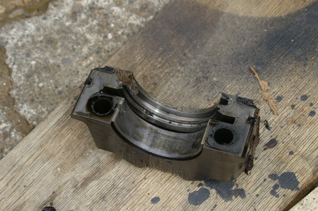

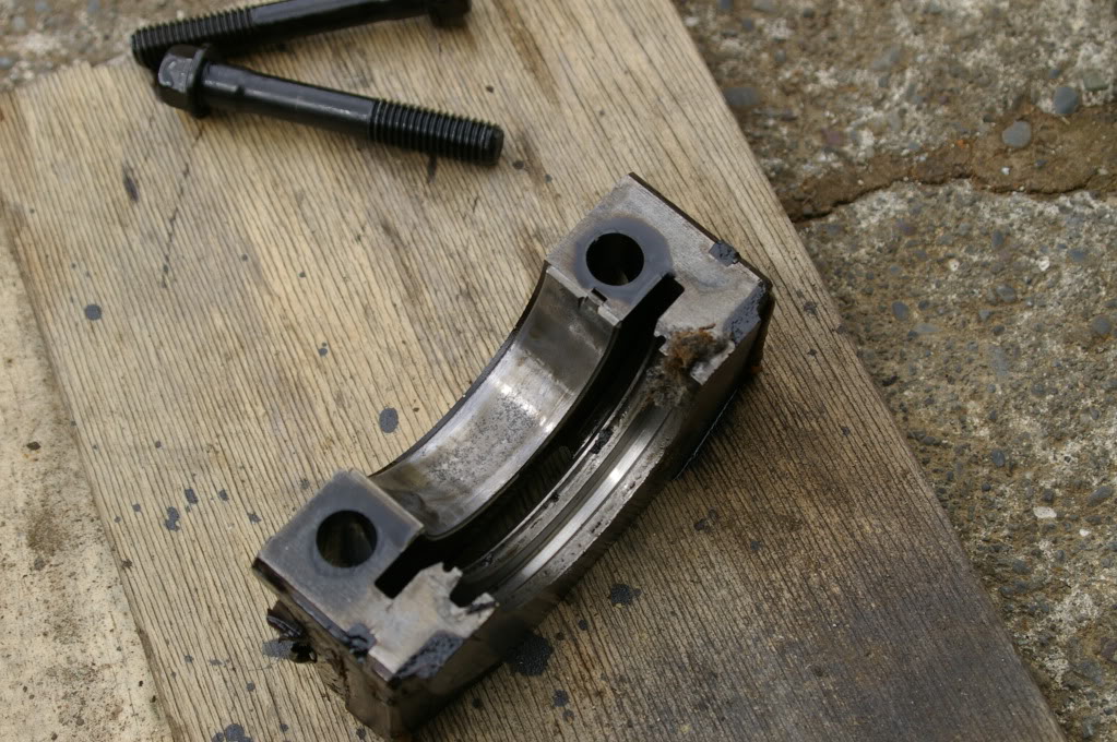

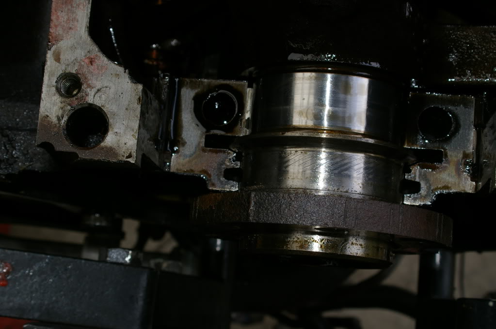

haha yeah.well we found out why the vb blows smoke due to the rear main there was no rear main seal left
just one little bit of fluff that wouldnt fill a teaspoon must of reved it to death LOL pics in a minute
- Posts: 5714
Re: DELCOS NEW RIDE
right found the leak was nothing major just the fact the rear main seal no longer existed at all LOL im not joking pics attached that peice of fluff is the only peice of seal that was in the rear main cap must of not liked high rpm after all these years bet my vn one is the same as i have the same leak LOL
also looks like boost on a 249000km+ engine has taken its toll on the bearings very nearly through to the copper on most bearings and one is on copper so a new set of mains and bigends going in while the sumps off looks like we caught it just in time if we had entered the burnout comp or had another day of racing it would of spat a rod out the side or something stupid
