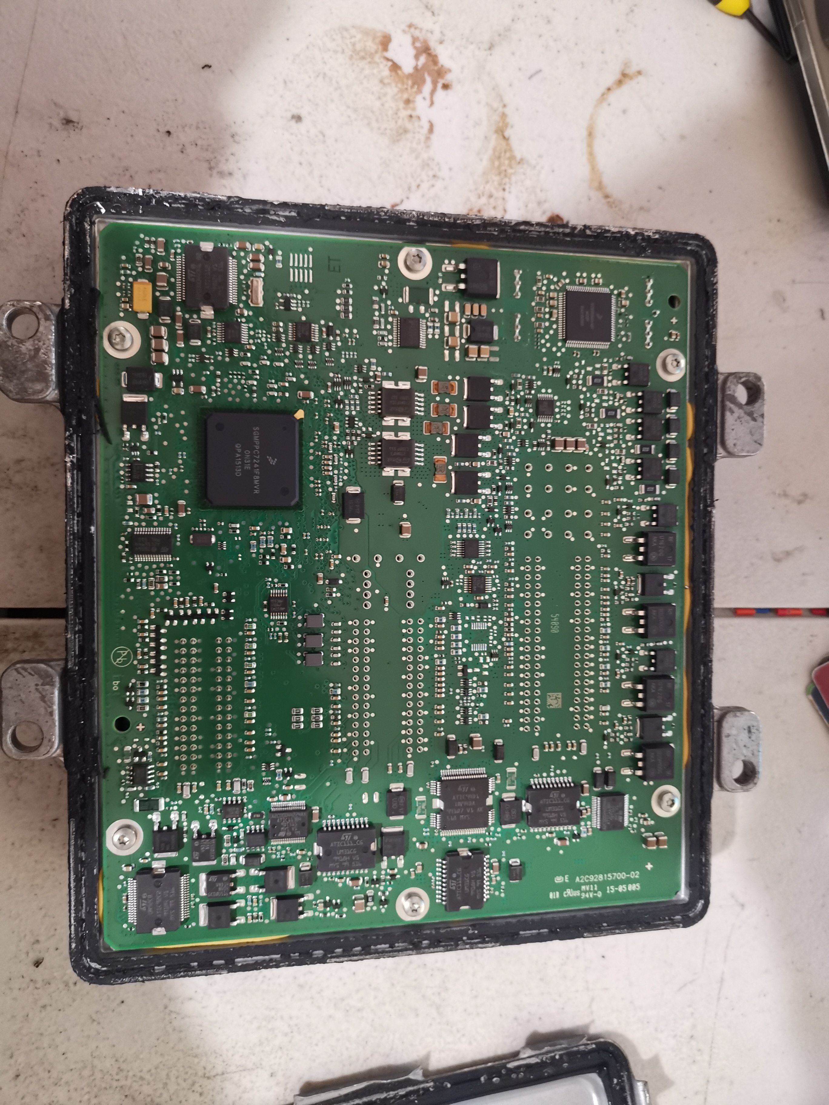

Re: GM E38 Kernel/Bootloader Development Extravaganza
Just cracked open an E98 ecu just now, picture below.
It appears all the parts appear on the back side, so I dont think I need to desolder the front connectors and look at the front side.
Has one of these SGM chipsets... so its time to do an SPS update and see whats actually happening!
