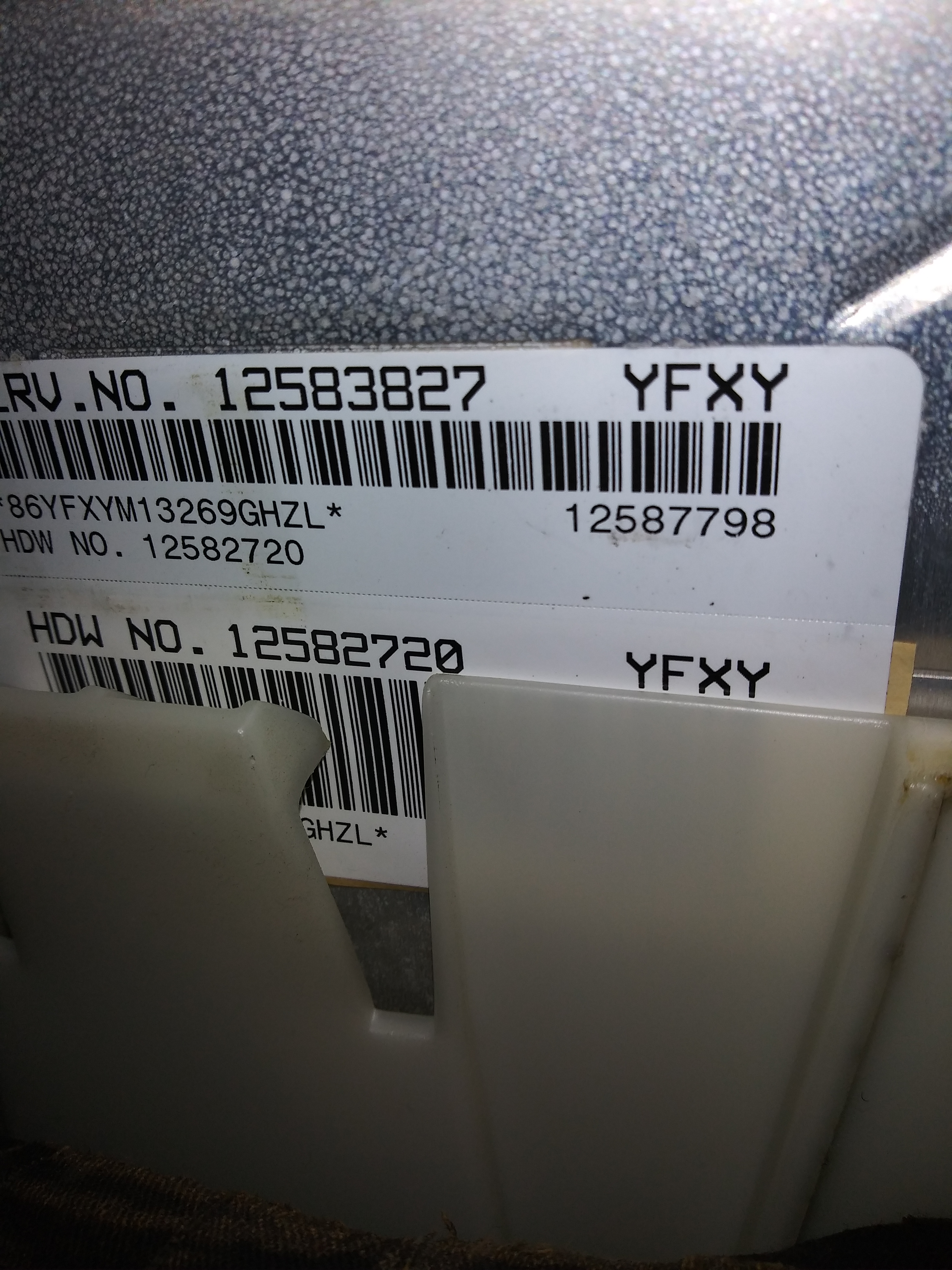

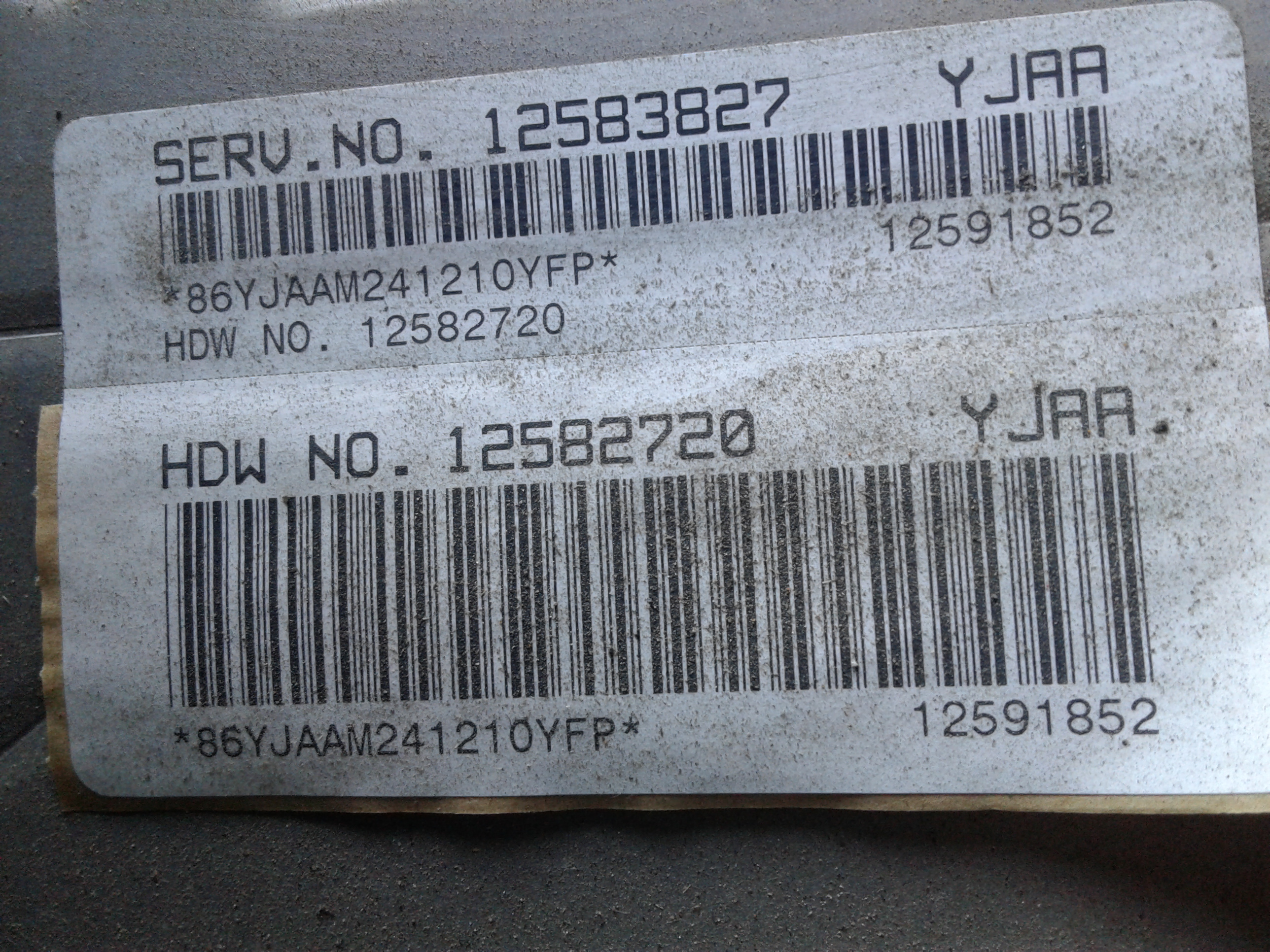

MudDuck514
Posts: 400
LD9 2.4l I4, 4T40E
2005 Chevrolet Venture
LA1 3400 V6, 4T65E
Location: North TX, USA
Re: V6 ability for pcm hammer.
Post by MudDuck514 »
Tazzi wrote:
Vampyre wrote:yeah my test harness uses 18,19 for power 59 for data and 60 for ground
its good for p01/p59 and p04
Same pinout I have, havent tried a P04 though.
Is there a few part numbers for the _04 that we can search/look for? Happy pickup one also.
Hi all,
Tazzi, both the 2004 Olds Alero I had, and the 2005 Chevy Venture that I have, use the LA1 3400 V6. They both use the same PCM:
I am sure there are others, but these two I know are used.
Mike
Posts: 3550
cars: VE SS Ute
Location: WA
Post by Tazzi »
Thanks Mike!
Just bought one now (https://www.ebay.com/itm/184108101526)
Come with some connectors too if anyone needs some here in Aus.
