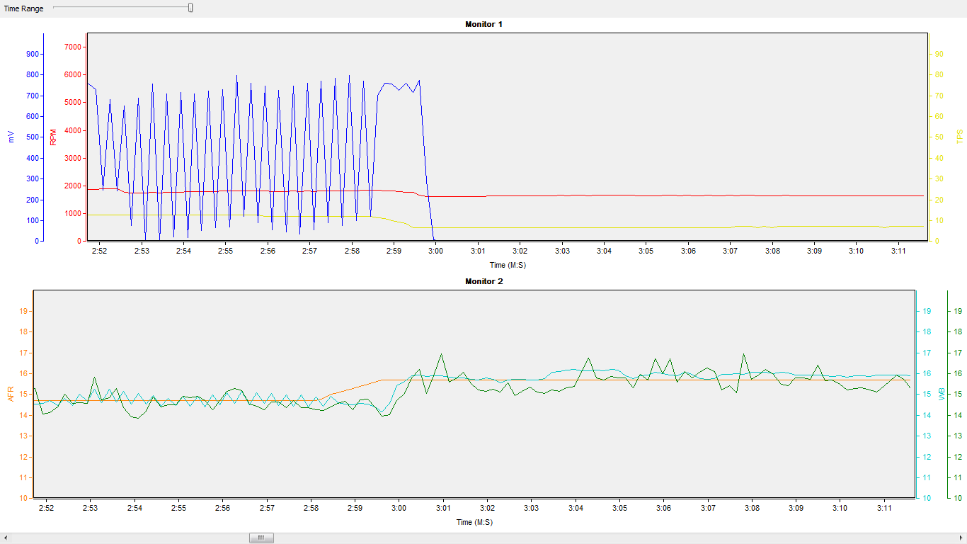

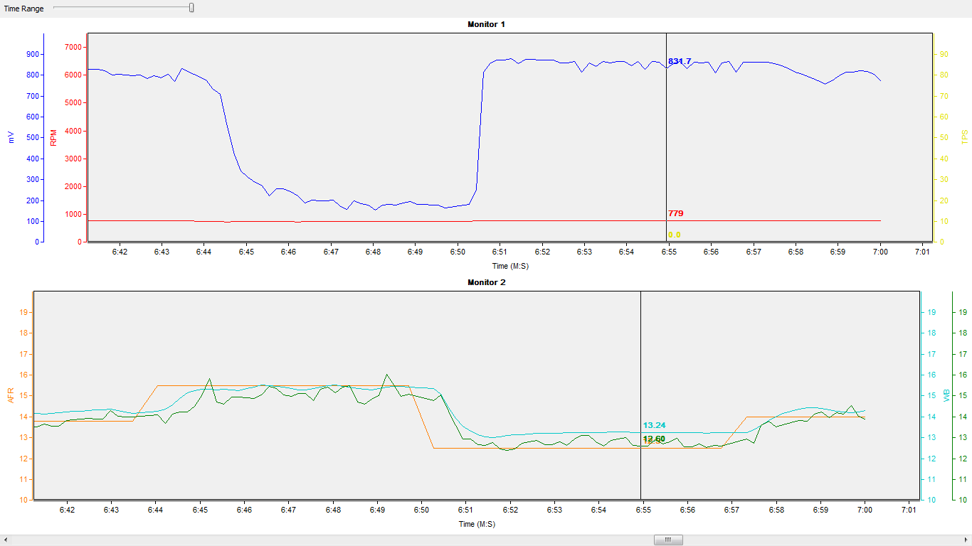

Getting more tuning KMs in and starting to run very nicely now. Can highly recommend the Spartan wideband, the sequencing is great for a quick sanity check and seems very accurate around stoich - its hard to check other AFRs. The MTX-L and Spartan do read very differently to each other, and its not an analog offset issue. This is a screen cap at stoich and lean cruise with the MTX-L (green) and Spartan (light blue) next to each other with the narrowband (dark blue) on the other bank...

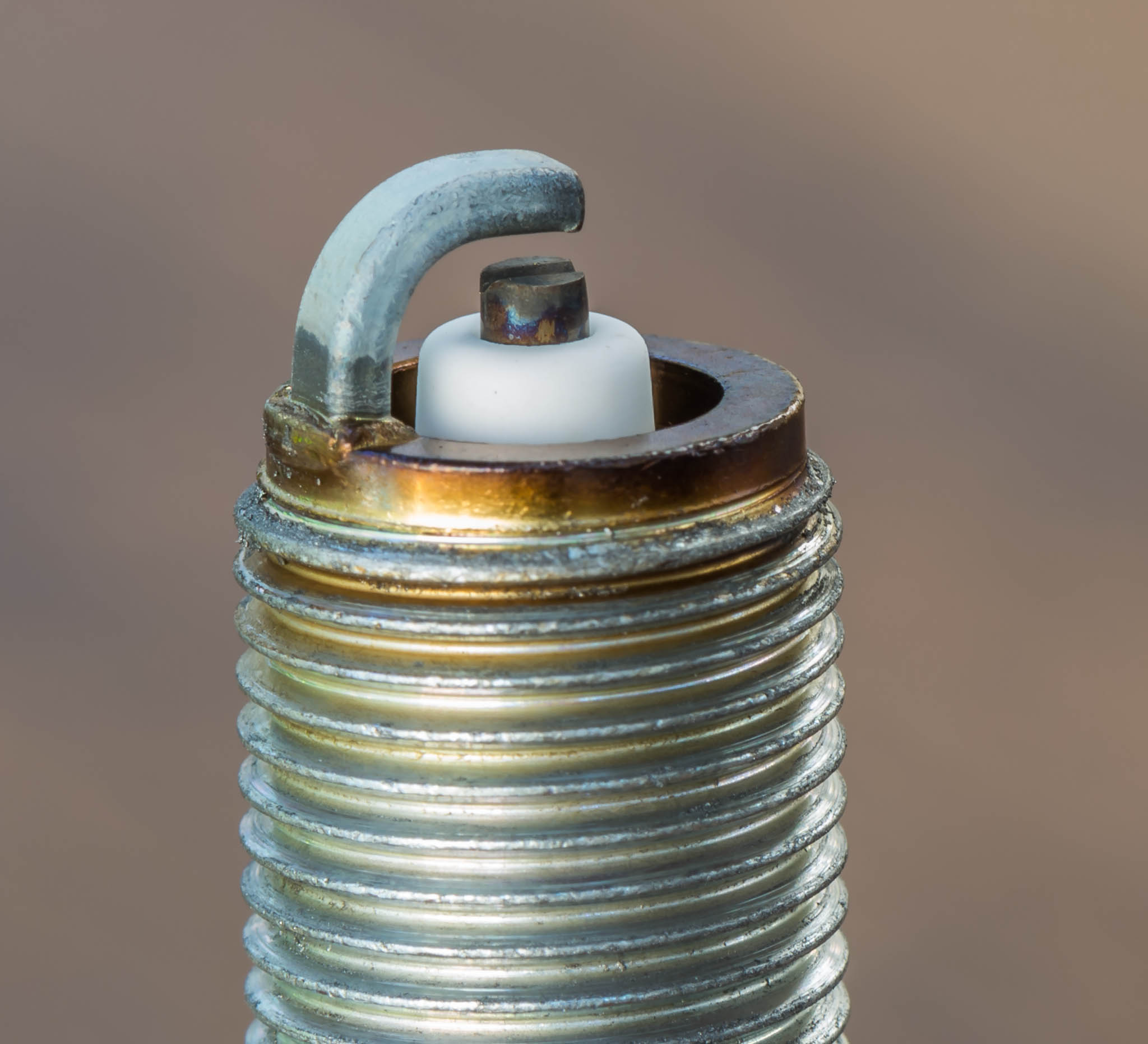

Put some new plugs in a few weeks back and pulled one today to check for any knock, looks ok but am no plug reading expert.

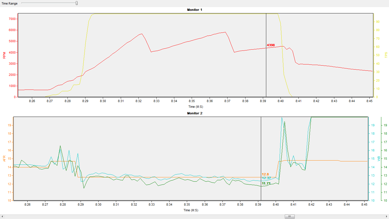

Seems ok, but got to WOT with a 12.8: 1 commanded AFR and there is a big difference...
The richer it goes the larger the difference, its not just WOT either (suspected exhaust back pressure) as it also happens at idle commanding various AFRs using mode 4. This was while setting up injector opening times (Spartan tracks much closer to target now)...
