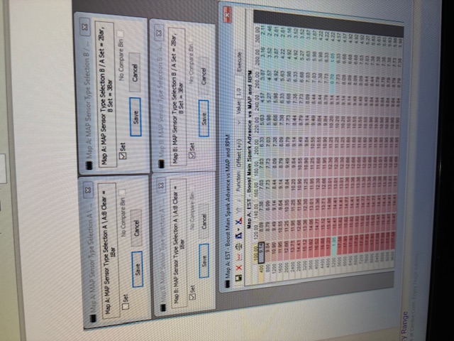

Thanks, I can't imagine its running on MAP B as the dyno guy would have said something but I will check that pin B9 is not wired.Holden202T wrote: Fri Jan 24, 2025 1:25 am i just had a look through your tune and theres a few things that look odd .... im assuming your running on MAP A settings, but if for some reason its on MAP B then theres some fucked up settings:
for starters the map sensor is not even configured right for it - both section A & B are ticked which is not a valid setting.
map b also has closed throttle VE set although the settings do look reasonable so it probably would work (if the map sensor setting was correct)
for reference, pin B9 is the map switch function and grounding it should activate map b ..... this can be easily seen when data logging it shows it.
i stand by my statement to try a fresh tune with just the absolute bar minimum to make it run changed.
I Assume this what you mean, that MAP B MAP sensor has both ticked.
I just need to go back and recheck the base timing settings first but I understand that a fresh tune will clear up a lot on unknowns.

Map a looks to be set for 3 bar map sensor map b is incorrect

the other thing too ... if you data log with the laptop, at key on the map sensor should be 100kpa, if its not that might indicate the map sensor settings arnt right.
im not sure if you've said if its a 2 or 3 bar map .... set accordingly.
- Posts: 10014
Re: 265 Hemi to efi
the ADX contains the scaling for the MAP when you are logging, so it is possible to have the wrong thing set in the tune and see the right thing when logging or vice versa. You def need the right settings in the calibration and the right ADX loaded for the MAP sensor you have.
