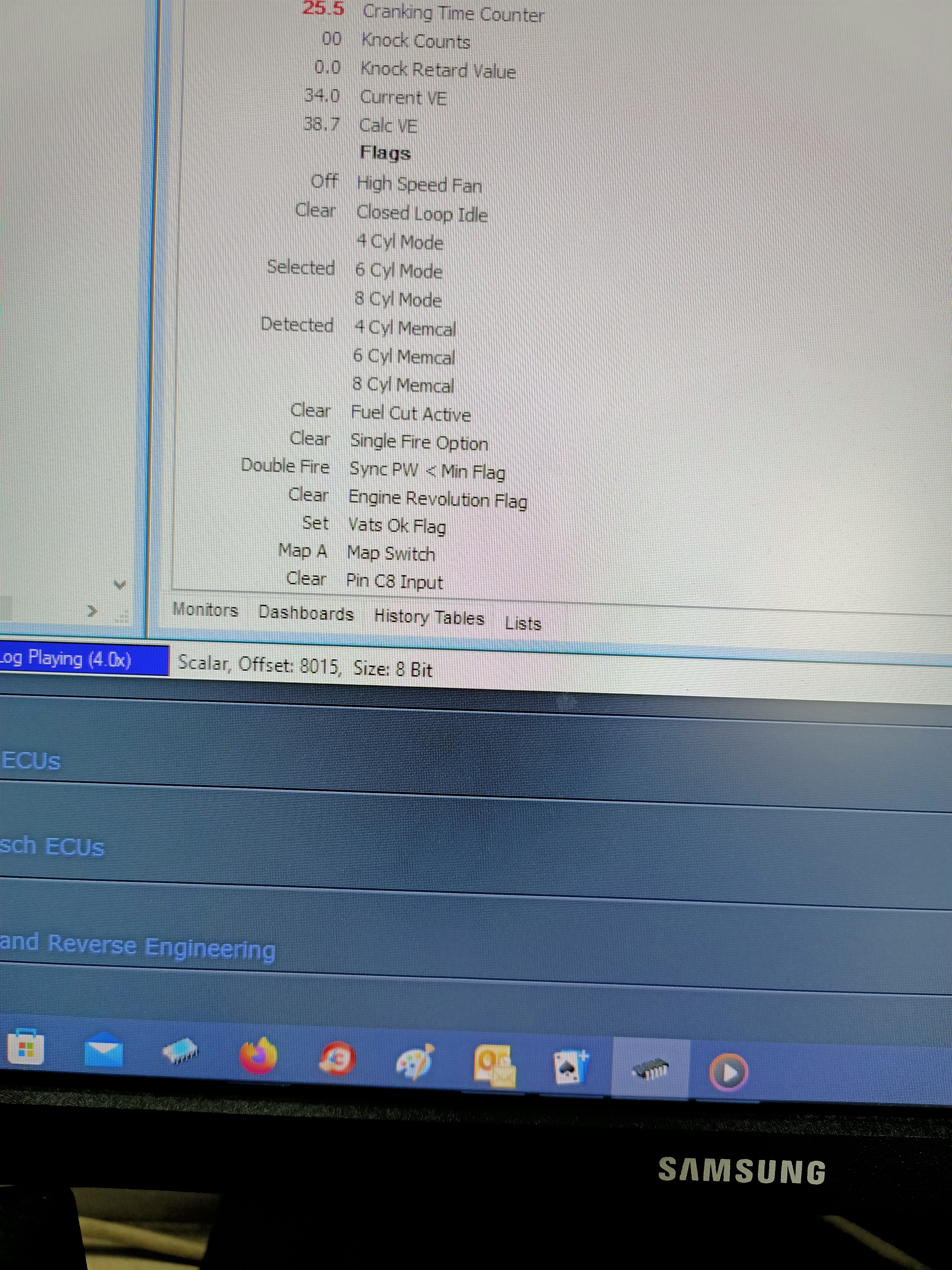

Without going into fine detail with the log I see someting with the memcal selection. Look under lists on the log and it says 6 cylinder memcal selected but it starts off as 8 cyl then jumps to 4 cyl for the rest of the log. Maybe I have the wrong ADX. I'm using 12Pver 112_3bar. Maybe the NVRAM is corrupted.

Post by Charlescrown »
This is what I mean.

Thanks for looking at the log file. So not the bin or the CAL, the actual hardware might be corrupt?
Posts: 10111
Re: 265 Hemi to efi
Detected is the jumper on the nvram. I think it always starts at 8cyl before you turn key, but when it runs it reads it and then they should both say 6cyl. So check that jumper is on the right pins.

I have never used a NVRAM so I can't comment but I will say my first coversion I did I used a 6cyl memcal on a 4cyl engine and it ran like crap and it was Kojab that helped me solve the issue.

antus wrote: Mon Jan 27, 2025 11:43 am Detected is the jumper on the nvram. I think it always starts at 8cyl before you turn key, but when it runs it reads it and then they should both say 6cyl. So check that jumper is on the right pins.
I haven't touched the NVRAM but maybe a jumper has come off?

If all the jumpers are it might pay to move them to make sure their making a good conduct.
