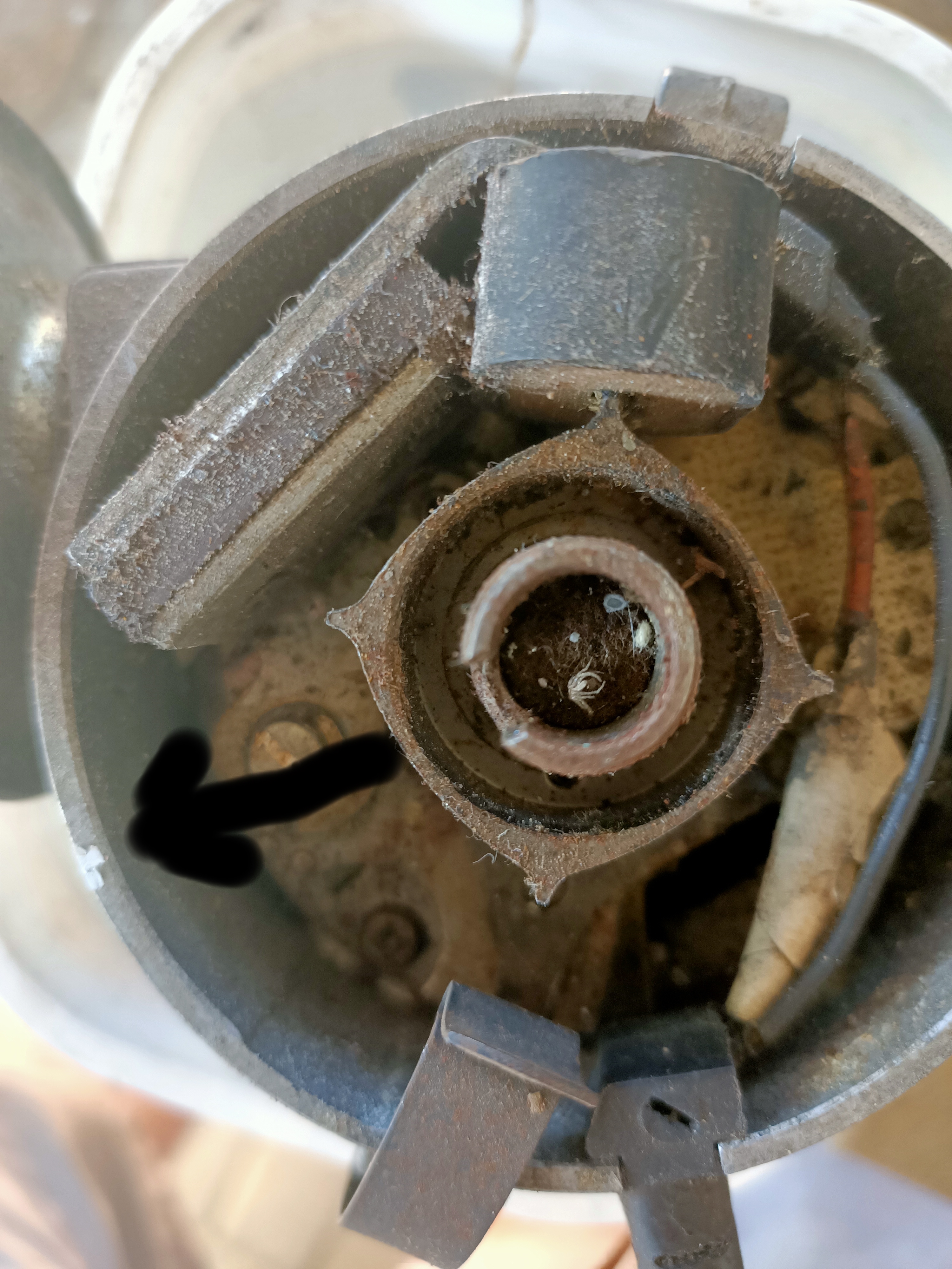

Re: 265 Hemi to efi
Post by Charlescrown »
Just a thought. Have a look at the pic. All those dissy's have a small mark to indicate where the reluctor and pickup coil should be when on N0 1 TDC. The rotor button should be pointing at the mark. It's a 4 cyl dissy but their all the same. Reason is I have seen a couple where the reluctor locating dowel has sheared off and the reluctor is free to rotate on the shaft. Grasping at straws now.

Charlescrown wrote: Sun Feb 02, 2025 6:51 am Just a thought. Have a look at the pic. All those dissy's have a small mark to indicate where the reluctor and pickup coil should be when on N0 1 TDC. The rotor button should be pointing at the mark. It's a 4 cyl dissy but their all the same. Reason is I have seen a couple where the reluctor locating dowel has sheared off and the reluctor is free to rotate on the shaft. Grasping at straws now.
Thanks I have lined the rotor up to that mark with the harmonic balancer set at 10 degrees before tdc. This is one thing I am confident of. It’s a new NOS dizzy with the reluctor gap correctly so should have no problems there. I also checked that the coil was getting 12 volts at ignition on and just over 10v on crank but that’s because the battery was going down.
I installed the fresh 2P bin into the NVRAM with Brindo’s help (cheers) and made the minor changes to get it running but still no good. It did fire a couple of times but it didn’t run at all. I tried using starting fluid and it made no difference.
But an interesting observation, I tried to check the base timing in diagnostic mode but there was no constant flash coming from the timing light only very rarely. I put in an inline spark checker and it was flashing as expected. I am pretty sure now that there is something not right with the ignition system.
