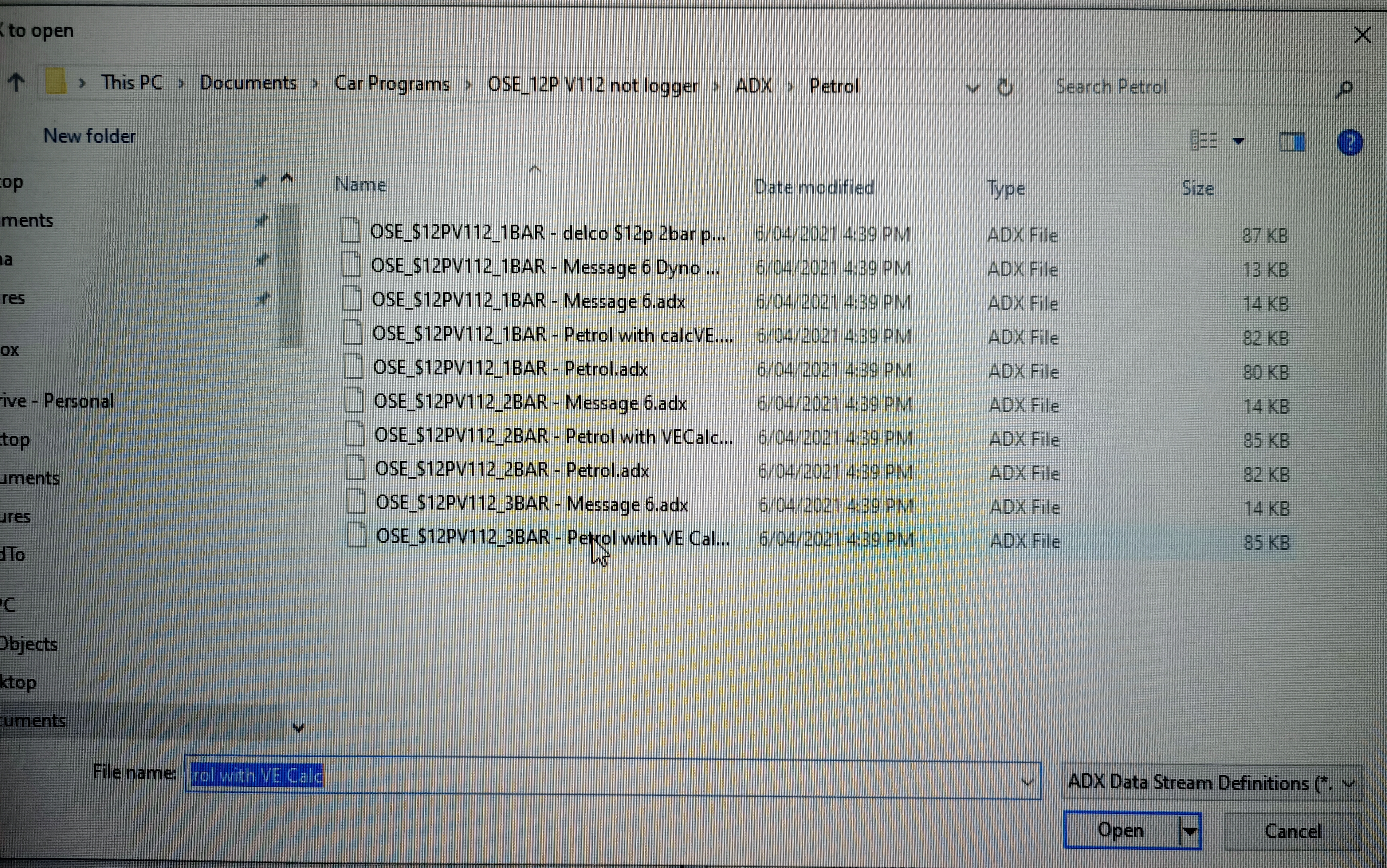

Hey Holden202T can you plese tell me if I'm using the correct ADX. It's the lowest one on this list. The reason is I can't see mAP voltage but can only see MAP which is stuck on 9.52 which if that's supposed to be the MAP reading insanely low (impossible) and scaled MAP which is stuck on 98.18 which by the ADX is supposed to be volts another insane figure. I'm not sure just what that really is. Also if I scroll down the data list it shows a code 34 MAP voltage low which would correspond with the MAP reding of 9.52 but when heff put it into diagnostic mode got code 12. Just wan't to clear up any incorrect info I might be passing on to heff.

I'm getting the same results on that same ADX.Charlescrown wrote: ↑Tue Feb 04, 2025 2:30 pm Hey Holden202T can you plese tell me if I'm using the correct ADX. It's the lowest one on this list. The reason is I can't see mAP voltage but can only see MAP which is stuck on 9.52 which if that's supposed to be the MAP reading insanely low (impossible) and scaled MAP which is stuck on 98.18 which by the ADX is supposed to be volts another insane figure. I'm not sure just what that really is. Also if I scroll down the data list it shows a code 34 MAP voltage low which would correspond with the MAP reding of 9.52 but when heff put it into diagnostic mode got code 12. Just wan't to clear up any incorrect info I might be passing on to heff.

I checked the log when it was running on the NVRAM back on 27/1 and can see that the MAP doesn't move from 9.52.
Also see that 4cyl Memcal is detected and MAP Signal Low set.
Lots of problems to deal with.
