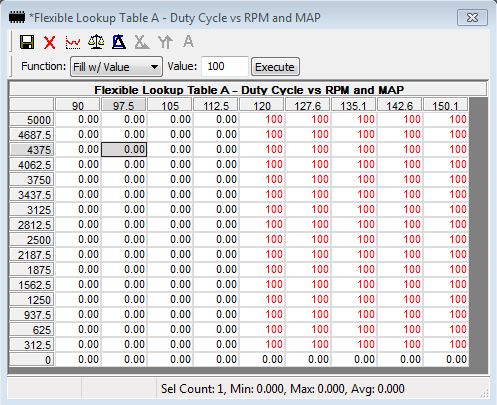

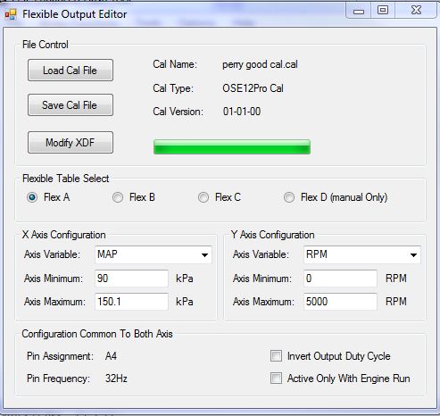

you can use a $12P flex table for that. hook one of the flex outputs straight up to the earth trigger on a relay that triggers the injector (assuming you are just holding the injector open using a relay when its triggered) then set up a flex table for RPM vs MAP and put 100 in all the cells to the right of the pressure you want to activate it at.
I would set it up somehtign like this, except set it at the pressure you want. the table just uses the value in the last cell if it goes off the edge of the table.
