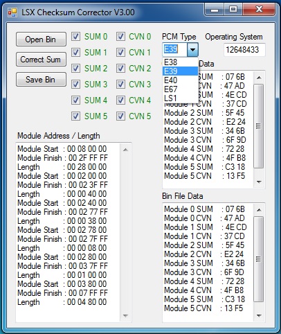

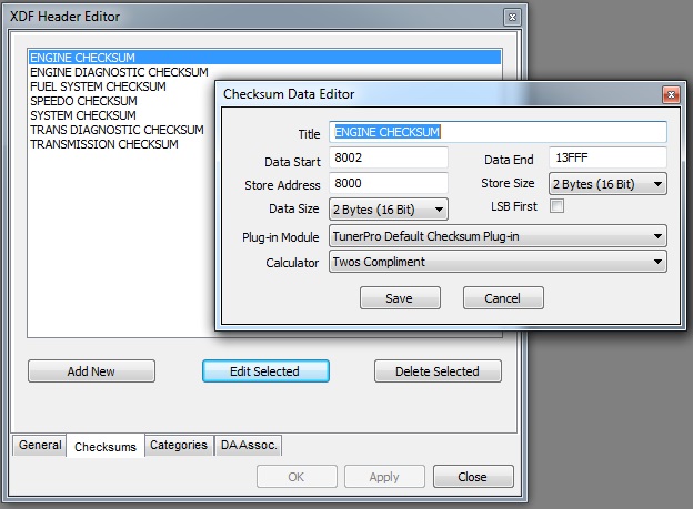

If you think it was me that edited your details from your ls1 chksum plugin then your very mistaken
All the ls1 xdf files I write do not need any external plugins , they use the default tunerpro chksum plugin to calculate all calibration modules checksums . I have never needed to use your plugin , edited it in any way or ever even distributed it.
I would suggest asking the person that posted the hacked version where they got it from .
I have sold over 300 of my ls1 flash tool cable and software , feel free to ask any number of the members on this site that have purchased it to verify that I don't distribute your plugin with my software
If I need to correct a checksum I have far superior software that ive written to do the job .
