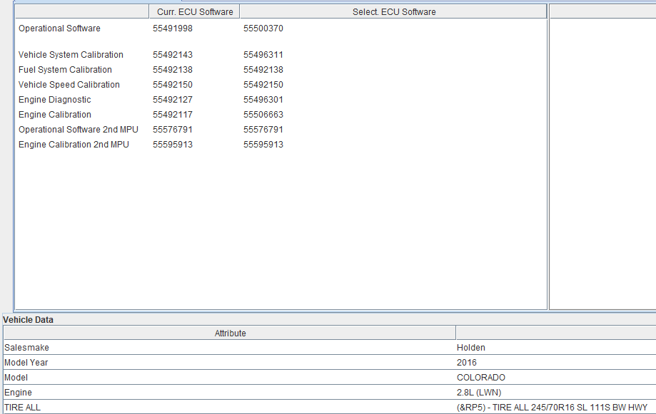

Looking at that E98 cals, I get the following.
Its interesting to see it talks about 2nd MPU. Looking at the board I can only assume its talking about that chip at the top left
Random note... 2000posts :thumbup: :lol:
