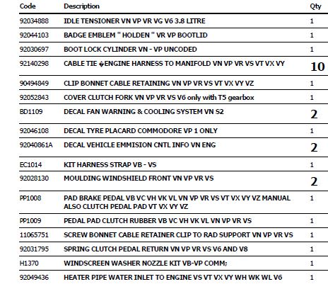

Did another order with speed spares. Stocking up where I can as usual
