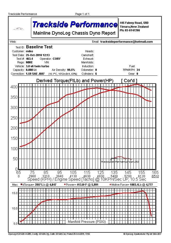

Just flew home from tuning this rocket v6 twin turbo touring car 413rwhp on 15psi good power for tiny little turbos you can fit the compressor housings in your hands

That would be fun to drive.
- Posts: 8549
Re: DELCOS NEW RIDE
noice!

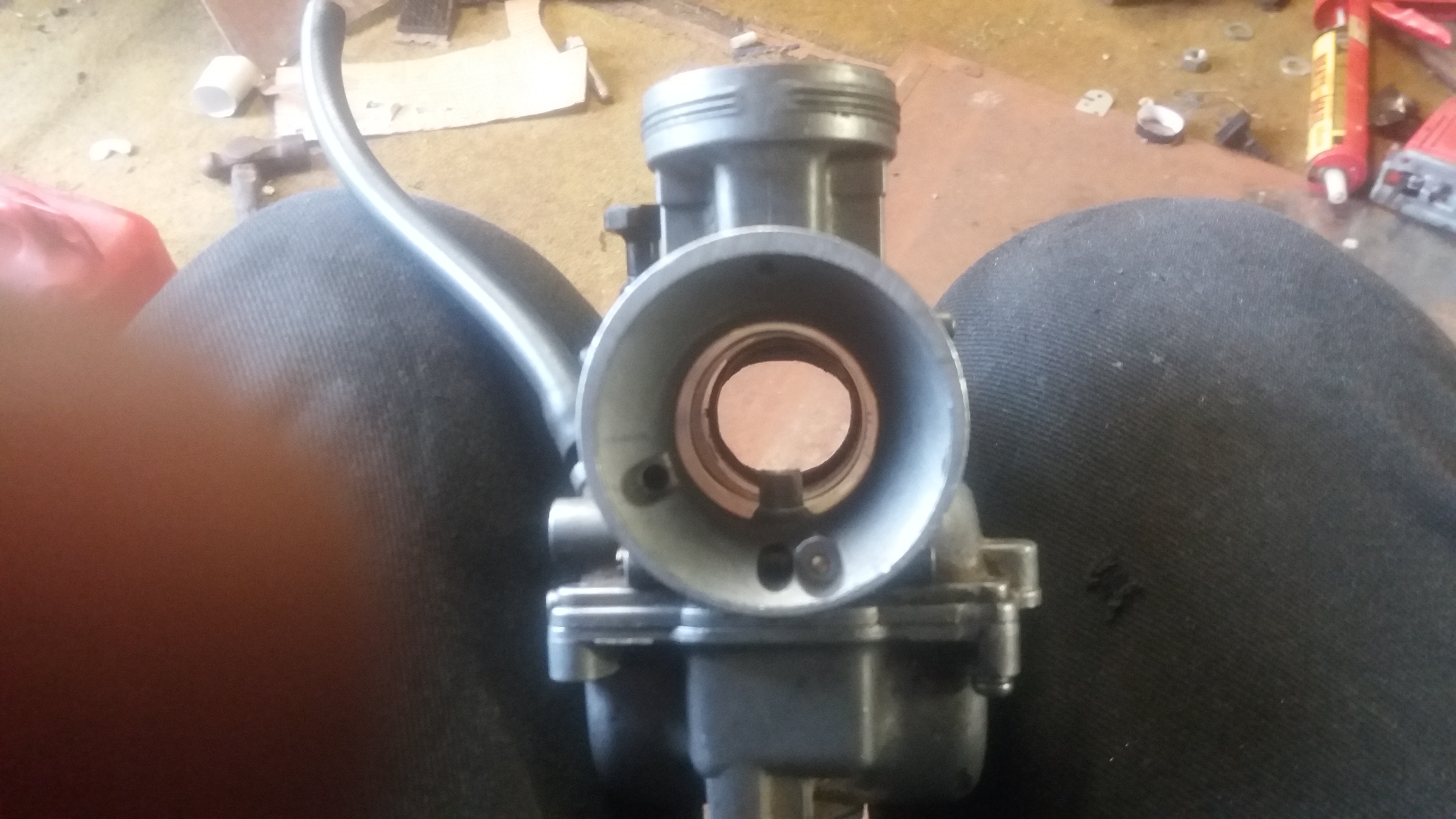

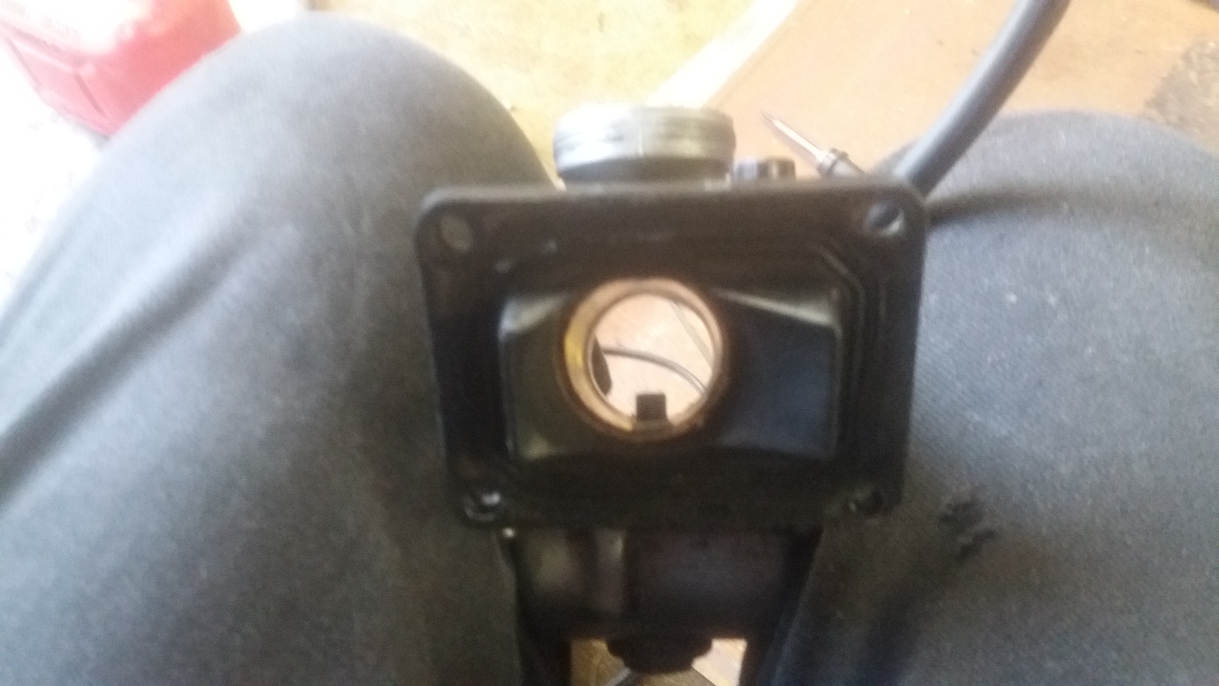

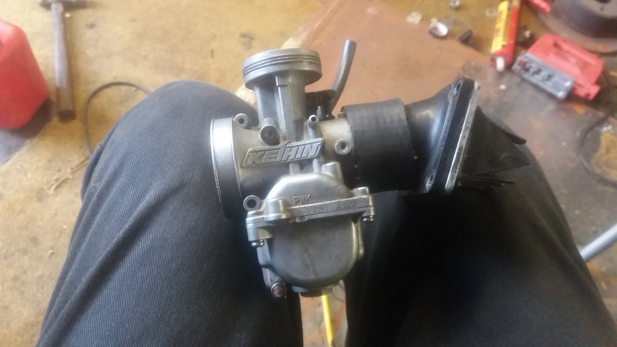

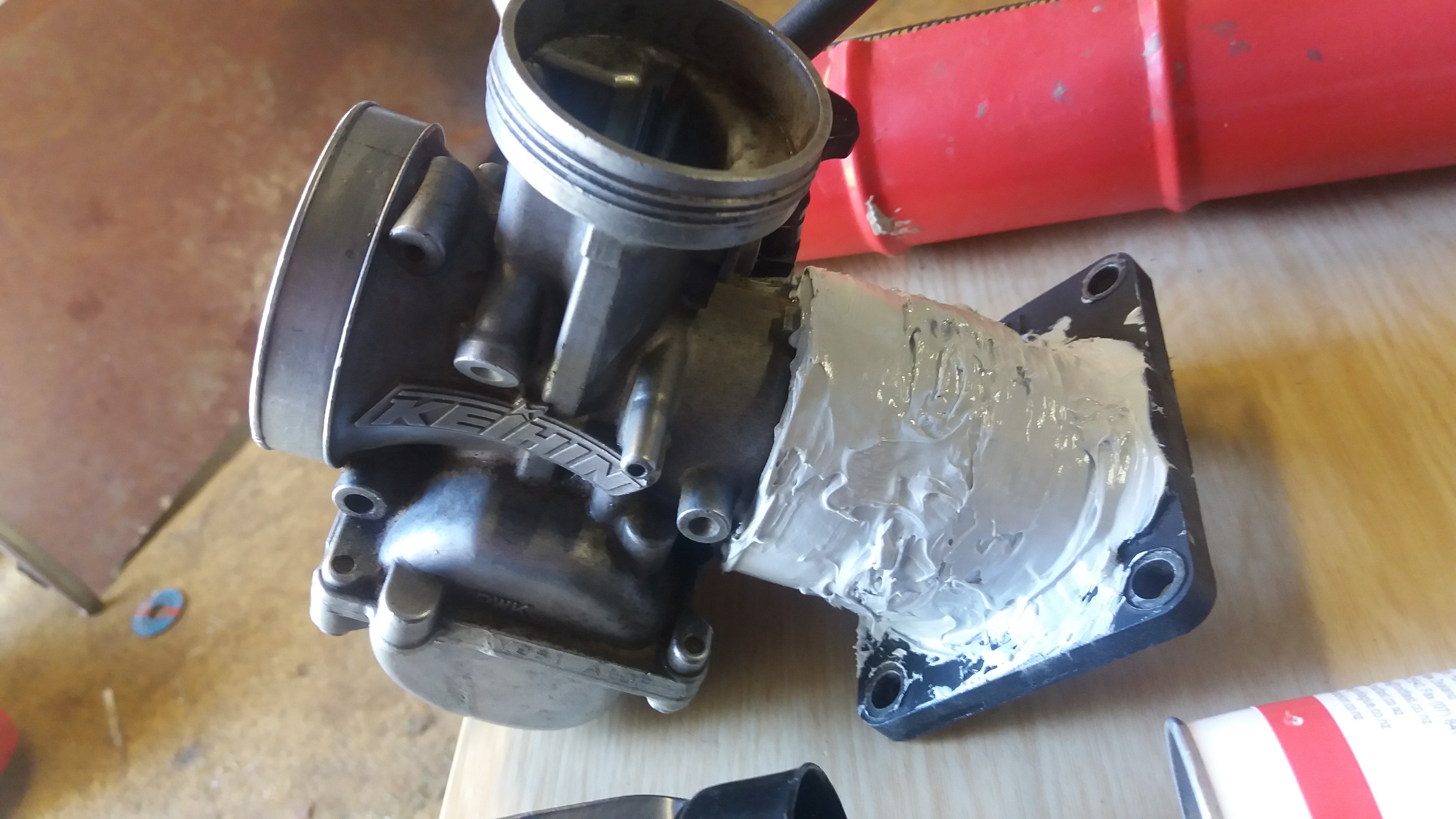

So the guy with the touring car owned a motorcycle dealership and had an flat slide carb lying around that he gave me to go on my dt250.was bigger than stock so I had to make a manifold to go from 28mm to 34mm carb size .now starts and idles mint for the first time ever just needs a different diameter needle and a new main jet and should be a rocket.oh yeah and a throttle grip assembly cause the stock one won't pull the slide full open
