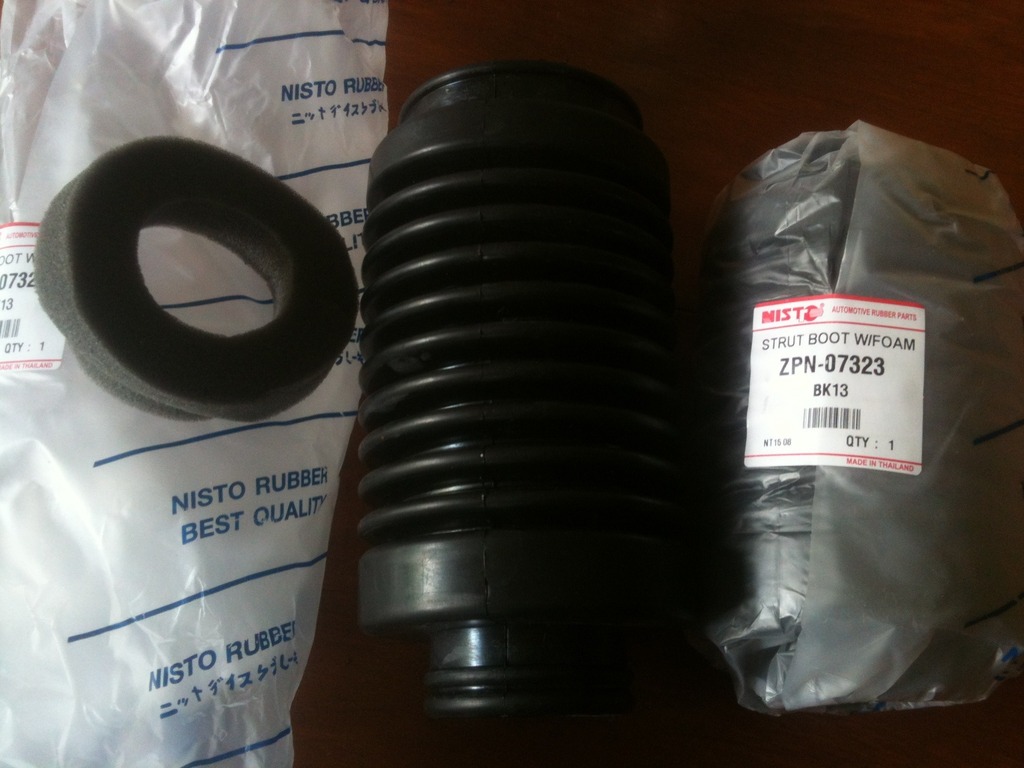

I managed to find OEM style aftermarket boot, and they are virtually identical to the originals.
even comes with the foam and the breather holes are moulded in but you need to punch the thin bit of rubber out.
$25 each so pretty pricey compared to other ones so hoping the quality is good based on that.

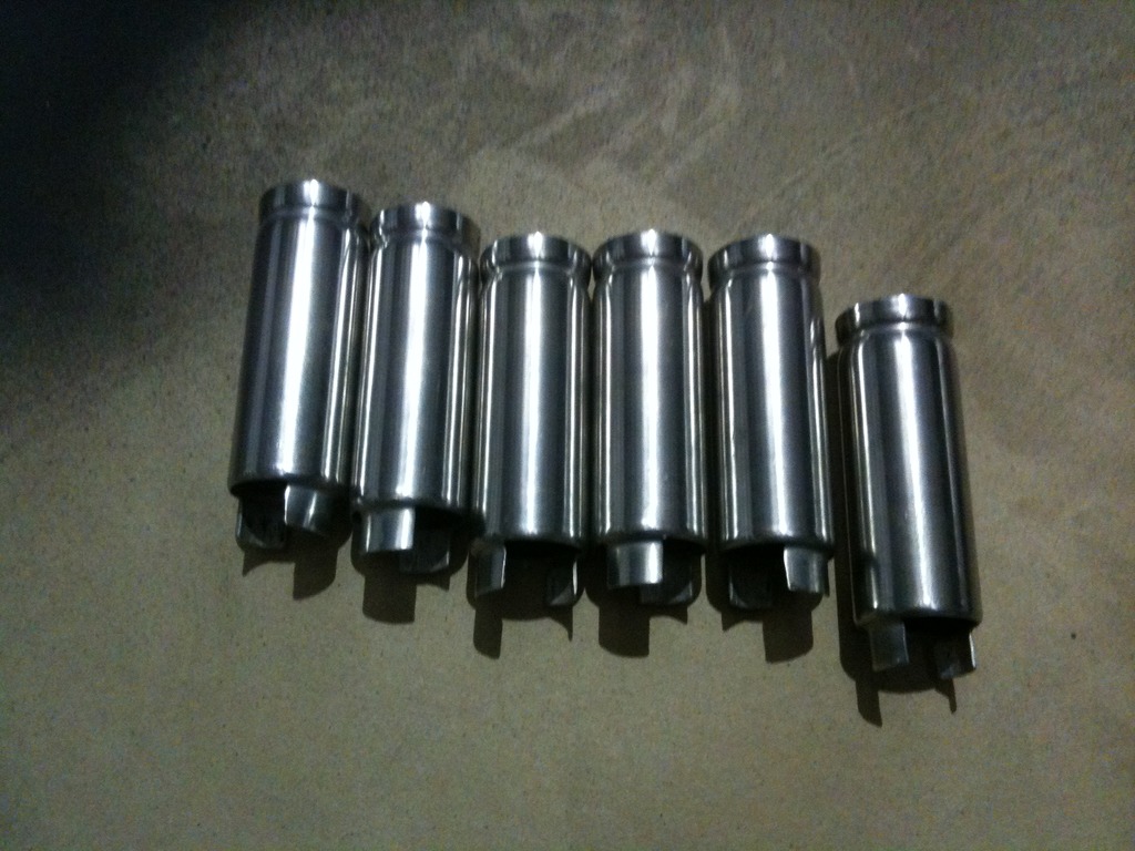

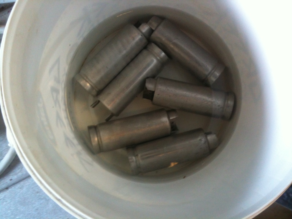

Cleaning up some ignition lead insulator tubes and their liners.
tubes in some acid i don't know but it only cleans off oxides of alloy leaving alloy perfectly untouched, leaving them super clean and bright.

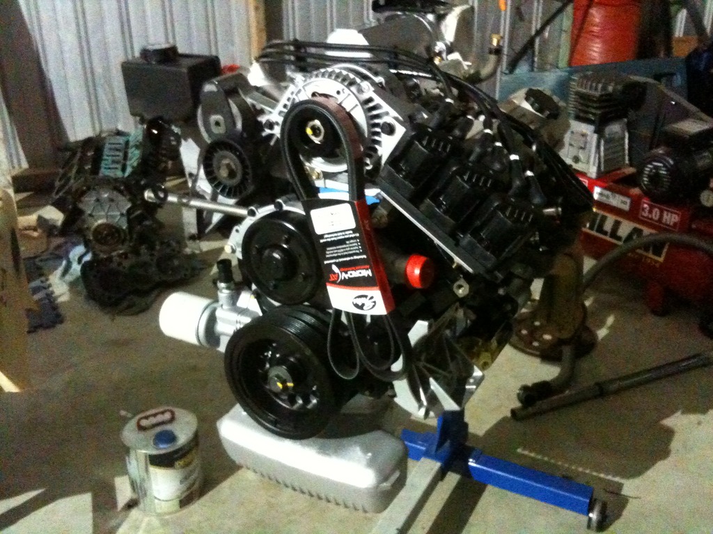

TdracerTd
- Posts: 488
Mitsubishi Evo IX

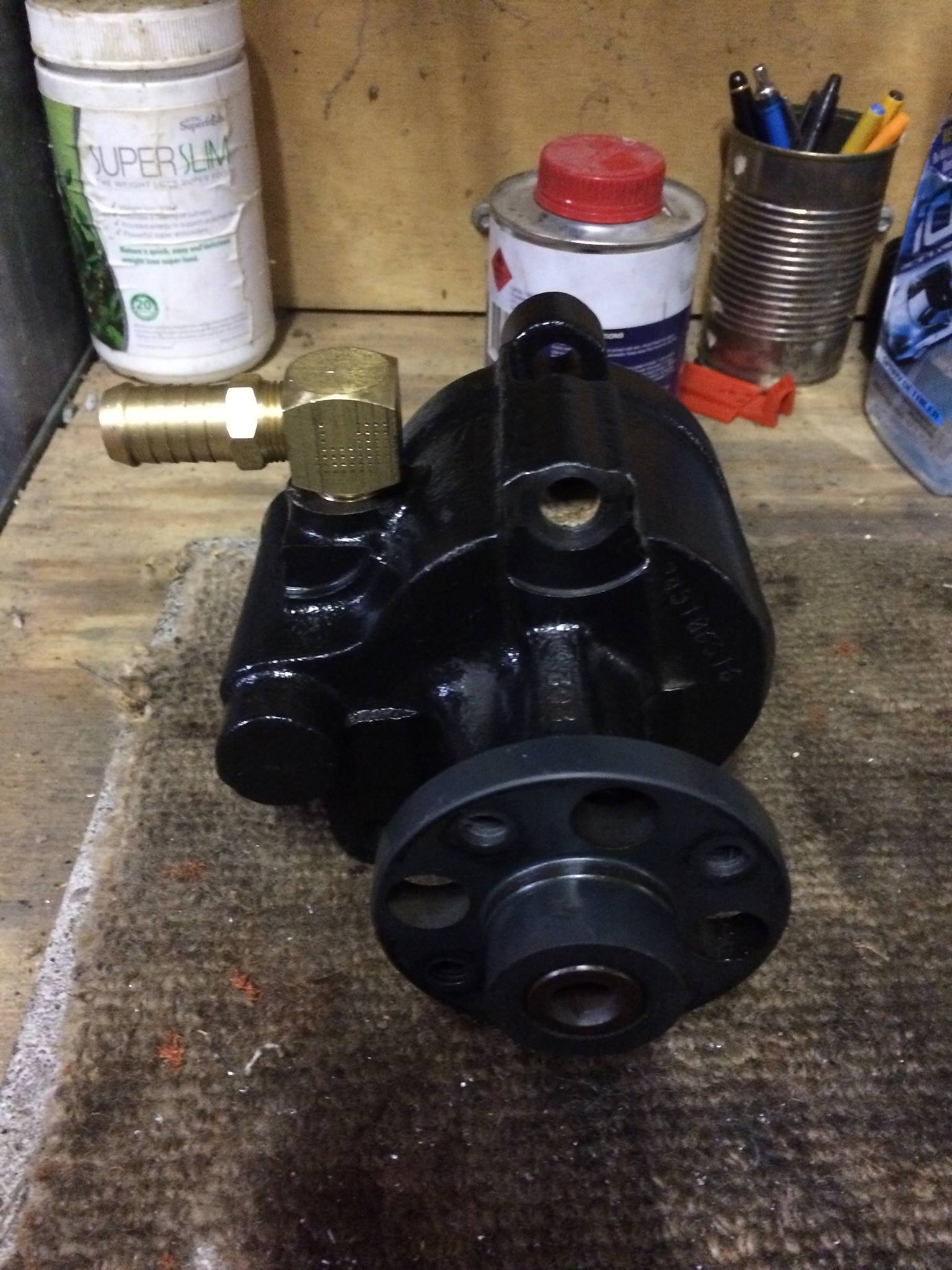

That engine looks mint! Are you going to HPC coat the Headers? Also another suggestion, have you considered modifying your power steering pump for a remote reservoir? Gives you the option to add a cooler later if you suffer cavitation. On the racetrack, its chronic.
- Posts: 8550
TdracerTd wrote:That engine looks mint! Are you going to HPC coat the Headers? Also another suggestion, have you considered modifying your power steering pump for a remote reservoir? Gives you the option to add a cooler later if you suffer cavitation. On the racetrack, its chronic.
This is what I plan to do on my VP S with ecotec conversion one day as new PS pumps for ecotec dont often some with the fitting pressed in, like where the hell am I suppose to get the fitting from? you destroy them getting the old one out. So tap and screw a standard one like that in and you're done!
But no, I haven't even had a problem with the PS, when I have issues the pump is f**ed and I buy a reco unit with 3 year 75k warranty and damn! does it make a difference! Only costs me something like 100 bucks or so.
For other news I got me insulators done. looks

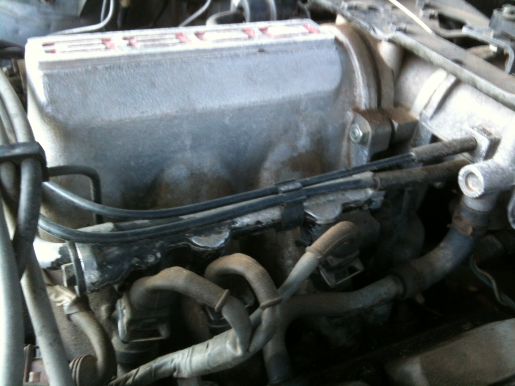

Engine is getting there.

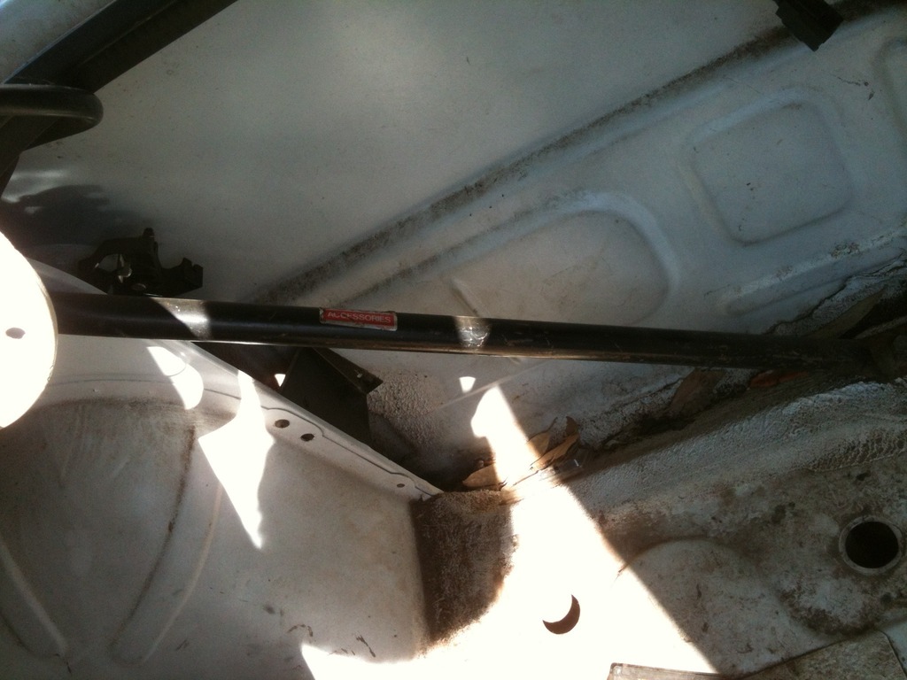

I was at the wreckers in bendigo today getting a roof lining board for my nephew.
I saw this. Lexan with a "toyota genuine accessory"
What are they? crash bars or some form of roll bars?
