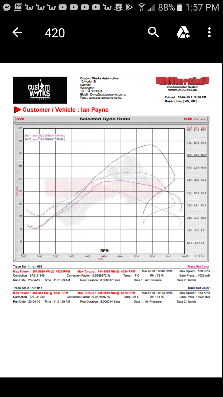

Something different this week p72 chip tuning session wish I never sold my ostrich would of come in handy but 4 or 5 chip burns we got it in line and fixed the 14:1 wide open fueling problems lol and made it a bit smoother

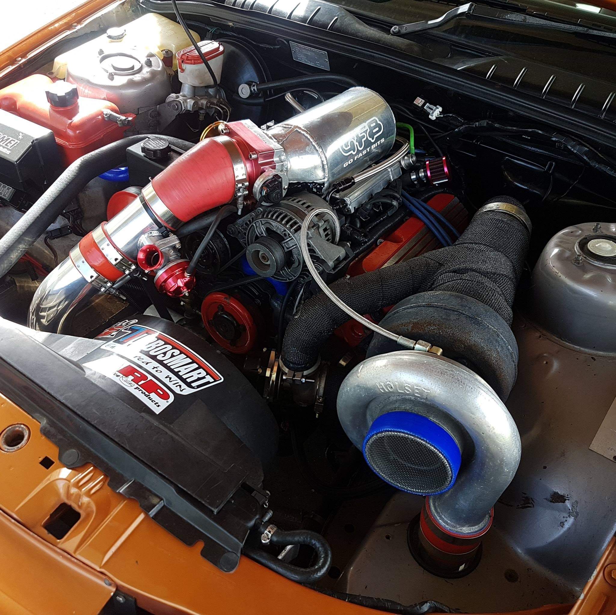

Another 300+rwkw v6 hits the streets after a couple of hours on the dyno.huge Holset on this one I don't know how the 3.8 gets it on but it does lol

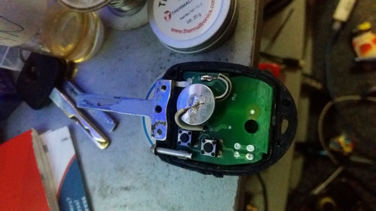

Thought I would see if I could fix my 2nd vx key that I drowned in bourbon years ago camping lol.removed the corroded battery and cleaned out all the pocket fluff lol tested the buttons with a multimeter 1 was quite flaky the other was a little better.so I fired up the bench power supply and feed it 3v and fired up my software defined radio and low and behold I got a bit of action the more I used the buttons the better they worked but 1 is to far gone .I'm going to fit 2 new buttons and stick it in a new case it can unlock the car but won't lock cause of the other high resistance bottom.i can lock it bridging the pins of the push button so I know it's going to work.tough little key this one
