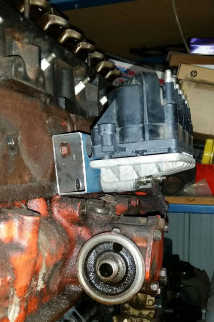

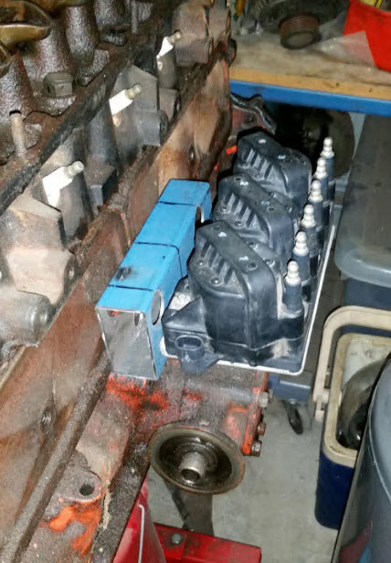

another option for doing a delco onto a 202 is to use a distributor-less ignition system (DIS) and for a long time i have had a D1928A module to try this out on a 202, but never got around to progressing it.
I have found that using an ecotec alloy base plate makes a good option for mounting this module to the 202, i then used some steel tube i had, and drilled a heap of holes in it to allow it to pick up the two side plate bolts to hold it to the motor and then fitted some long studs out the other side to mount the coil pack base to it.
i am currently in the process of modifying a VN wiring loom to suit a 202 with this module, and the plan is to test it on a stock 202 i have and modify the 202 base tune thats in the $12P custom tunes thread to suit its requirements.

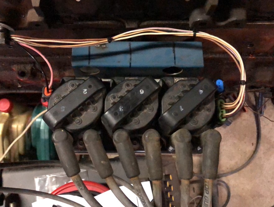

so i've re-routed the v6 coil pack wiring to my location and cut the commodore v6 dfi module plug off, and fitted the required plugs for it.
I got the plugs from EFI Hardware, below info.
C-03FR4-8HALF2 - GM 3 Pin Coolant Temperature Sensor Connector
C-06FR4-8HALF - GM Holden TPS Flat 6 Pin Connector Female
H-WTDC - GM Holden 2 Pin Water Temp Sensor Female

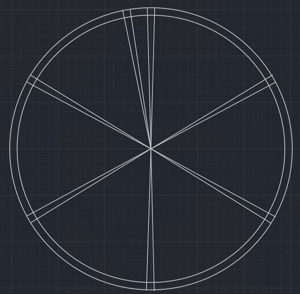

I am currently in the process of mounting a crank trigger.
it looks like from roughly sitting the template over the top, that the sensor above will be ~60-70 degrees from TDC
Also making the required slots in a balancer to suit it
Once it is all complete and confirmed as working i will be able to post more information as to what settings are needed to make it work and i will update the autocad file with the balancer bolt holes and TDC marks for reference.
