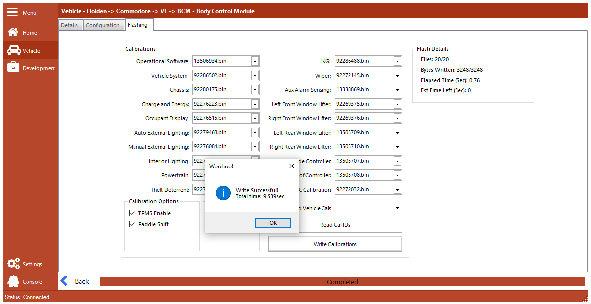

Post by Tazzi »
Its now been correctly implemented for extended addressing... and flashing now works actually faster again :lol:
The OBDX GT flashes 20 calibrations including kernel onto a VF BCM in 9.5seconds.
For reference, the fastest J2534 I have ever found has been the Bosch MDI which usually flashes calibrations only on BCM in around 12ish seconds.
Technically... it can be made to go faster, but the issue then comes to if the module can handle receiving information that quickly :lol: :D
Both GMLAN and HSCAN have been tested with my own flashing software. Next is to test 'high speed' gmlan programming (83.333) which is only on a few GM modules that I know of. Assuming that works.. we have full GM compliancy.

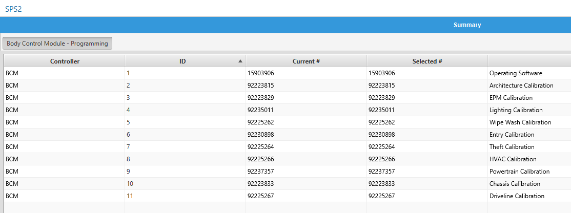

Posts: 3558
cars: VE SS Ute
Location: WA

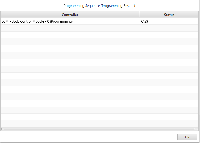

Post by Tazzi »
Techline flashing has been a success!
After going through a few more stupid hoops.. including having to implement a 'loopback' mode... we are flashing with techline 8-)
