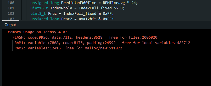

Fixed. Compiles for Teensy without braking Pico.
Haven't tested teensy and don't plan to any time soon.
the ";".
"UL" in the RPM averaging, rev limiter, and constraint line.
Backup had the rev limiter but not the 20RPM minimum.
Added that to backup.
Double checking those features now.

Compiles for Teensy 4.
And the constraint for indexing the array was set above zero, to same value I wanted to cut fuel; so it was never "less than".
