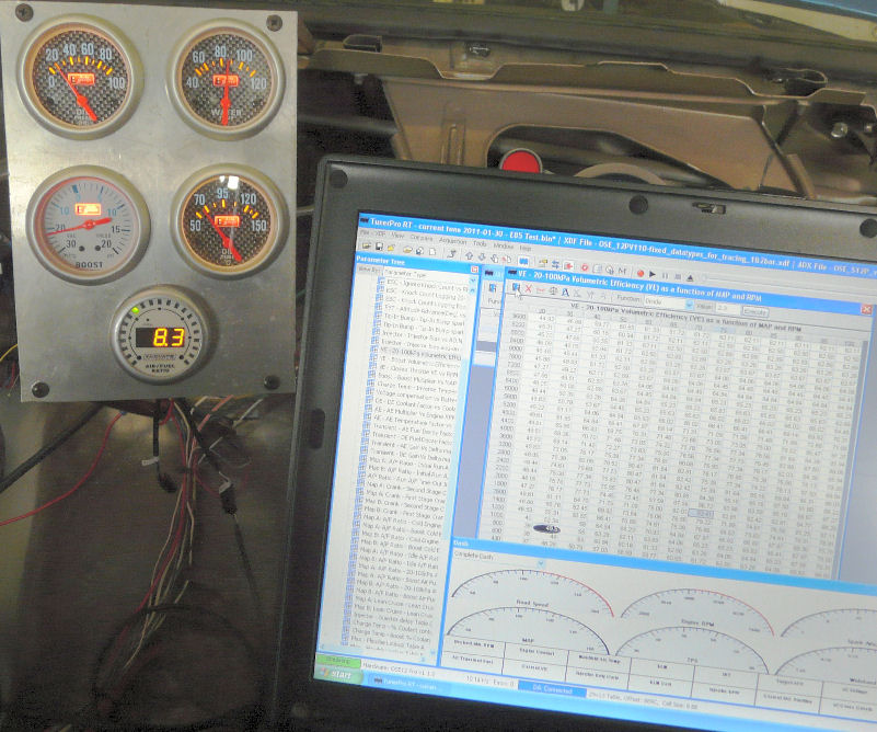

well i decided to shout myself a birthday present this year :D got myself an Innovate Motorsports Wideband gauge to replace the wideband i had in the gemini before, basically it was the same thing without the gauge, so i will use it for logging when tuning cars and the new one is a fixed install in the gem!
used it to test out the idle tune of the gemini on E85! the commanded was 8.6 and i was adjusting the table to get it right (started at 7.6)
I highly recommend these, they look very well made and so far everything of theirs works fine!

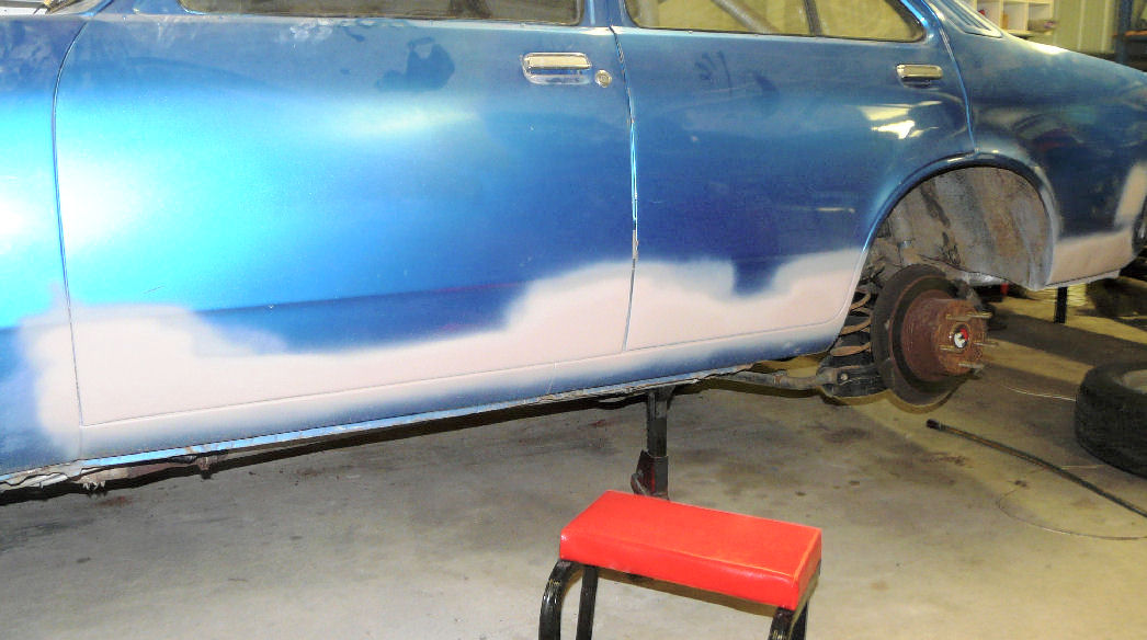

in the mean time im filling in some time till i can see the tech inspector.....
was some dodgy rust holes so they have been patched up in an effort to have the car look half professional :P

wow nice graphics LOL nah seriously now she have more cancer in the doors or just dented
Re: My Delcoed Rides
the whole car has always been pretty straight, just had a lot of rust in the doors and they are not worth fixing so for the moment just bog and smooth them to make it look respectable and hopefully one day i will find some good doors for it!

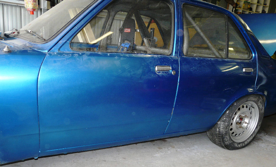

So seeing as i had tech inspection today i had to get stuck into fixing the primered panel, i then had enough time to give it a quick wash and as it turns out i finished it about 20 minutes before i was due at the pub with mates sunday arvo so that was perfect :thumbup:
so with that done i was ready for tech inspection and on that topic, got a big tick of approval from the tech inspector so that means once all the paperwork gets processed and returned i have a valid tech inspection and can race!!!
