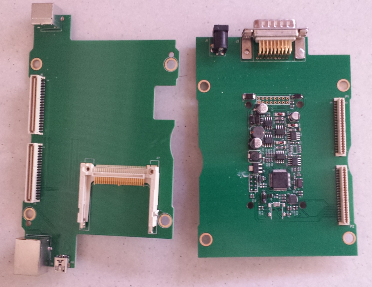

Posts: 10016
Re: Open source GM OBD2 flash tool using a ELM327 device
I'd say one of the problems. Ive seen 'cracked' VCX-NANO clones which dont work and cant receive firmware updates inside clones of completely different hardware too. Really obviously a fake and bin-worthy, but until its in your hands you cant see you were ripped off :(
Posts: 10016
I got my money back, and the seller stopped touching these, but it happens.
Posts: 3626
cars: VE SS Ute
Location: WA
Post by Tazzi »
Oh wow! Thats a joke!
I bought directly from the manufacturer, so maybe thats the difference.
