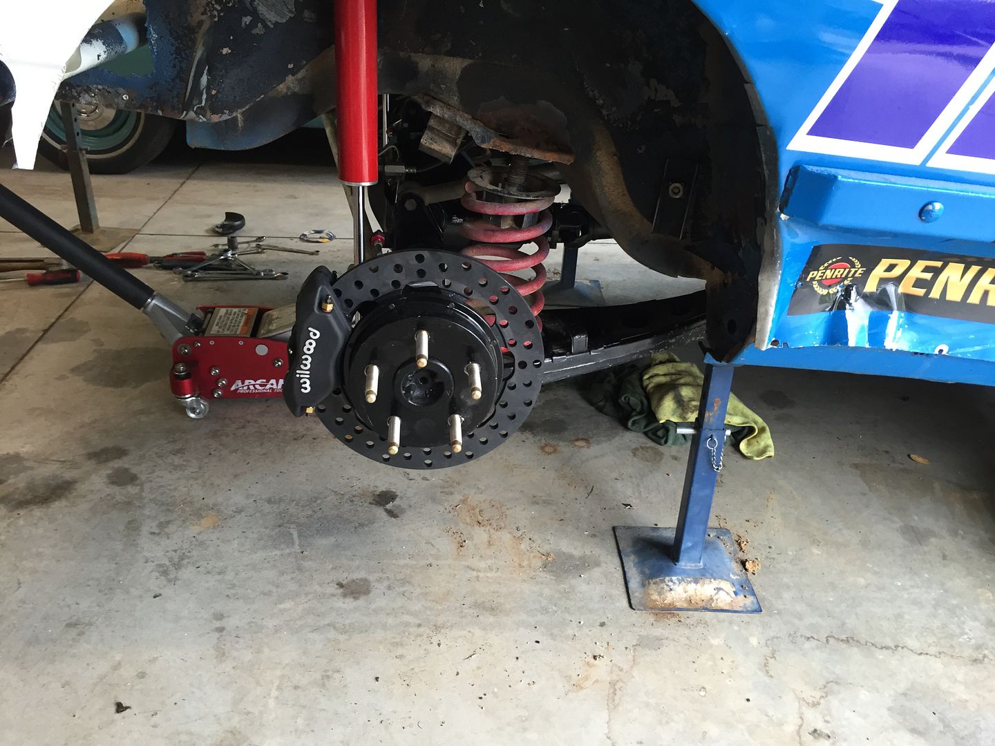

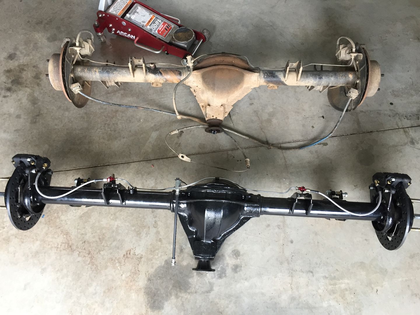

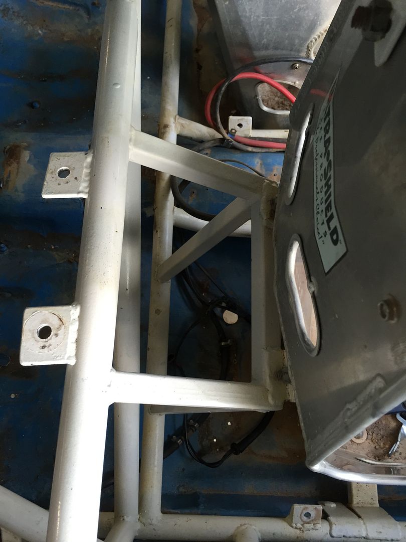

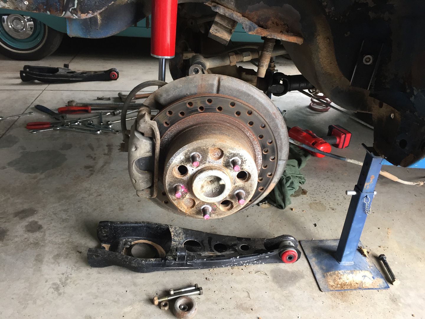

Had a good day today, swapped the diff out and found this on the way...
The rear end went from this...
To this...

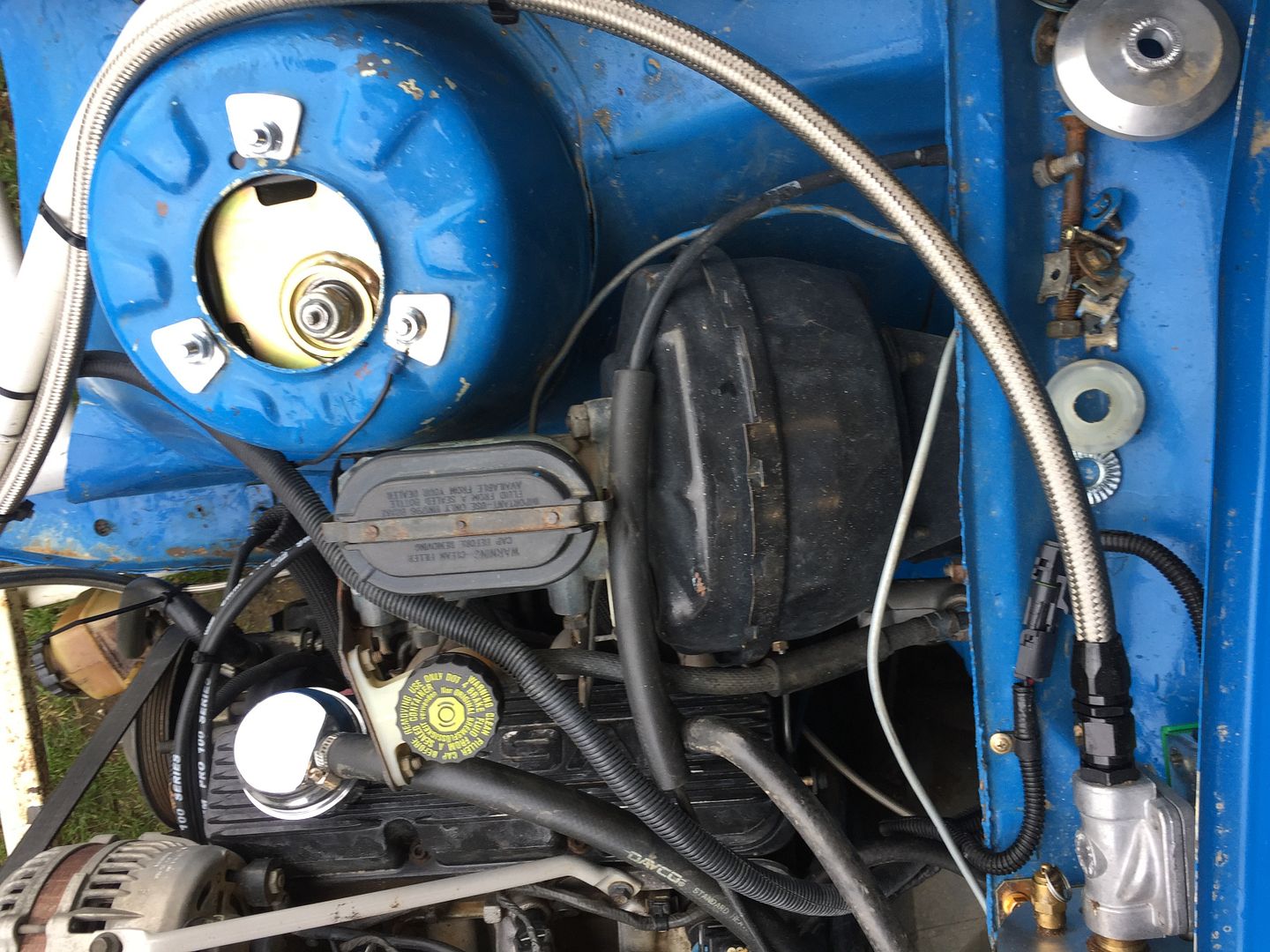

Then ripped this junk out...

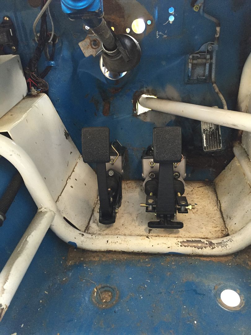

To be replaced by these...
And moving the rh seat back this far for better weight distribution and to suit the new pedals

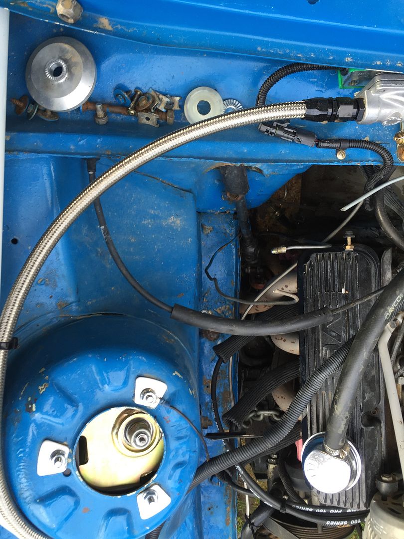

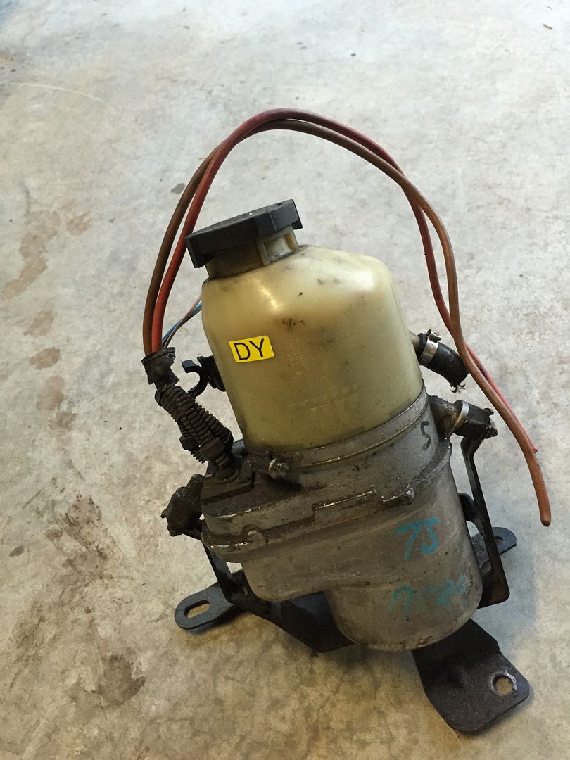

So im looking for thoughts, power steering is going electric (weight of the pump is about half!!!) and wondering weather i should mount the pump where the brake booster used to be or in the boot?
Can anyone see any problems with mounting it so far away from the rack?
yoda69
Posts: 1226
2005 VZ Monaro CV8 manual
Location: Geelong, VIC
Re: How to loose 200kgs?....
Post by yoda69 »
Only weight of additional hose, fluid and hose retaining clips.
Potential advantages are fluid cooling.
