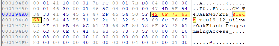

Taking a scroll through the bin.. and I spotted this... Maybe its indicating its a MPC562 processor?? Same as the E38??
And some more interesting stuff Id say if it doesnt have its own kernel.. its using a MPC562 and similar flash being 2Mb.. so thats going to be pretty straight forward.

00006050 4F7A FFFF 3922 4441 2020 424B 594C 4E4D Oz..9"DA BKYLNM
00006060 4B30 3631 3233 3633 3237 4300 4150 4142 K061236327C.APAB
00006070 4158 0171 C28A 0171 D686 0171 C287 FFFF AX.q...q...q....
00006080 0171 CD4D 4141 FFFF FFFF FFFF FFFF FFFF .q.MAA..........
00006090 FFFF FFFF FFFF FFFF FFFF 2006 0522 FFFF .......... .."..
000060A0 FFFF FFFF FFFF FFFF FFFF FFFF FFFF FFFF ................
000060B0 FFFF FFFF FFFF FFFF 5043 4D4F 5354 4E23 ........PCMOSTN#
000060C0 3536 3632 3334 3439 3635 3147 4E45 5331 56623449651GNES1
000060D0 3348 3136 3233 3434 3936 35FF 8E9F FFFF 3H162344965.....Code: Select all
00018F60 0001 A050 5434 3220 5443 4D00 4E56 0000 ...PT42 TCM.NV..
