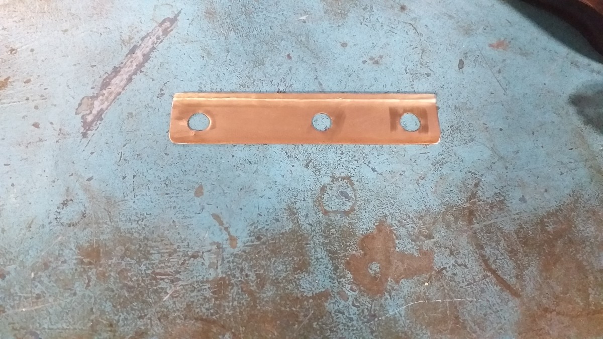

Had a spare moment this evening.
Was a real pain to drill. First attempt turned into a banana...
I'll test fit tomorrow and if it looks good I'll make a few more.
Probably the best it's been in a while anyway.Gareth wrote:This poor old bombadore is going to go the best it ever has soon![]()
Re: Project Rescue
maybe make a template out of steel that you can clamp the copper down to and then drill ?

Re: Project Rescue
Believe it or not but that is actually steel, it's just a really bad picture. For some reason the lighting at the asylum seems really odd/dim atm.
If I had the time I would possibly make a die of some sort with 2 holes and punch them out but simply don't the materials or time at the asylum these days. We made that by clamping to a piece of 4x2 and drilling it out in small steps.

Re: Project Rescue
yep thats some funky lighting then hahaha

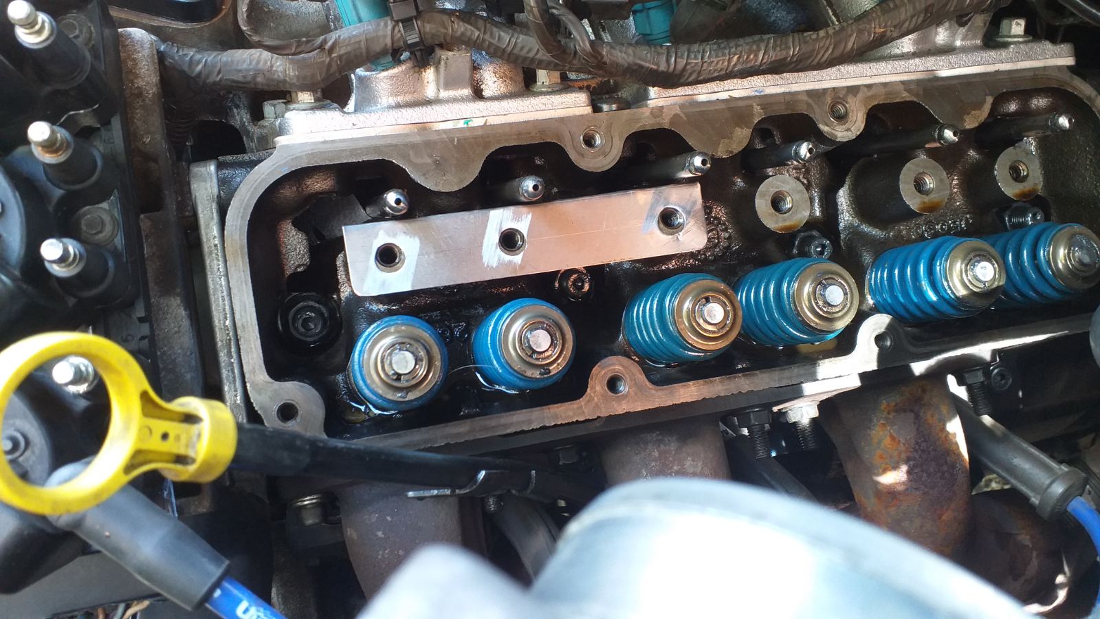

Re: Project Rescue
It should do nicely.
Now to make a few more.

Re: Project Rescue
That's interesting. I set my LS lifters to the factory spec of 2.09mm or 82 thou. But real LS7 lifters might be different? Most marketed as LS7 lifters aren't actual LS7 lifters but the regular LS lifters.

Re: Project Rescue
I really can't understand why anyone would use LPG these days. Anyway good to see you fixed an issue and got it running. Interested whith the push rod plates. What are they for I would think the lifter would be ables to accomodate.
