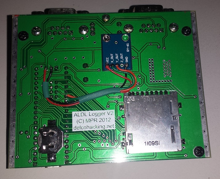

So Holden202T sent me a new toy to play with, an accelerometer! Its one of these http://www.hobbytronics.co.uk/adxl335-breakout and looks like this installed...

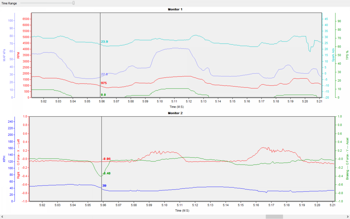

Slight mod of the firmware and ADX so 2 spare analog inputs inside the logger also get shoved in to the data stream (not logging the Z axis yet). And then this happens, hours of fun...
[youtube]https://www.youtube.com/watch?v=WYLxURvMn_Y[/youtube]
First lap of the block just to check things are ok. Medium braking and light accel, followed by a couple of left hand bends...
Should be a very handy addition to the logger
Time to get some more data.

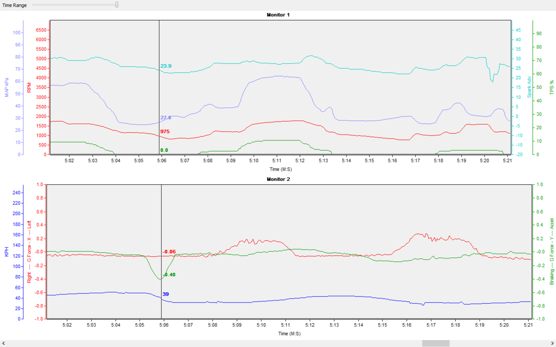

Re: Toyota Powered VL Calais
I have also been looking in to adding GPS, really the only thing stopping it is how to display the data. TunerPro does not really allow for it, needs a google maps plugin! Would certainly be useful for track work, even road tuning its often useful to know where you were driving when looking at data.yoda69 wrote:Very cool.
Without an XY display its about the best I could come up with in TP. And without the text I will forget my lefts from rights, and forwards from backwards.Holden202T wrote:I love the descriptions on the monitor VL400!
- Posts: 2585
- Location: North Coast, NSW
you could export the tunerpro log to CSV and import that into a mapping program? bit of a pain tho. be good to see all the engine data with a track map next to it when stepping through the data.
