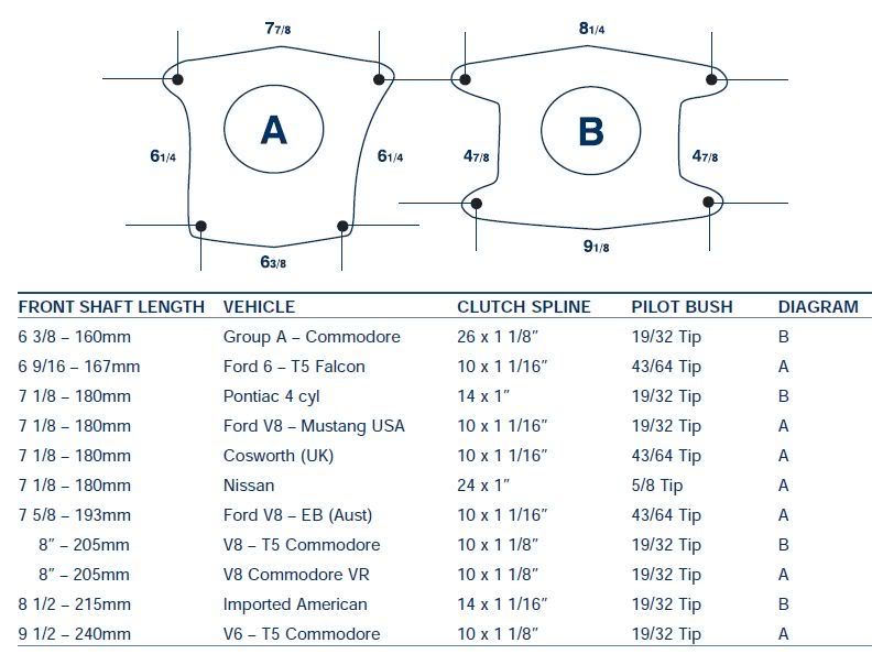

For the V8 guys a G-Force gearset to suit the WC T5 would hold up to a rated 600 hp. I looked into getting a G-Force gearset to fit into my V6 T5 box, but unfortunately a special input shaft needed to be made to mesh up with the V8 gear ratio sets. The V8 input has one extra tooth on the gear & 26 fine spline for the clutch, compare with the V6 input. G-Force would make me the special input shaft if I bought 25 of them as that was their lowest production run they would do. Unfortunately that was when our dollar was almost equal to the yank dollar & I didn't have a spare $6500 or 24 mates that needed a special 9310 input shaft for a T5. I ended up finding a special V6 input shaft to mesh with the OEM V8 T5 gear sets. Left over from a special order Mal Woods put in with ATC & never collected so the story went.

Ho hard is it to fit a v8 t5 to a v6? Is it just a matter of a custom clutch plate and a bell housing change or is the input shaft too long/ short?
Posts: 3678
The problem with the V6 T5 is that the case is different to the Aussie V8 T5 so you can't just swap over the bellhousing as well as the input shaft been a different length. There is one exception to this been the VR V8 T5 which uses the same casing.
