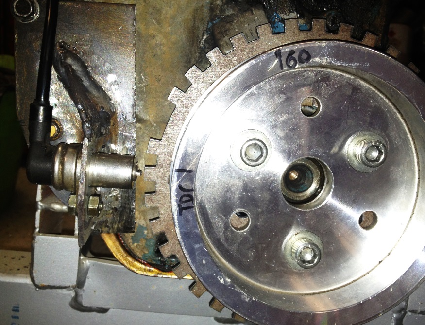

nice setup, is that a magnetic or hall effect sensor you are using?
Re: How to convert a 202 to Delco
Yes magnetic - VS commodore ABS wheel sensor :)

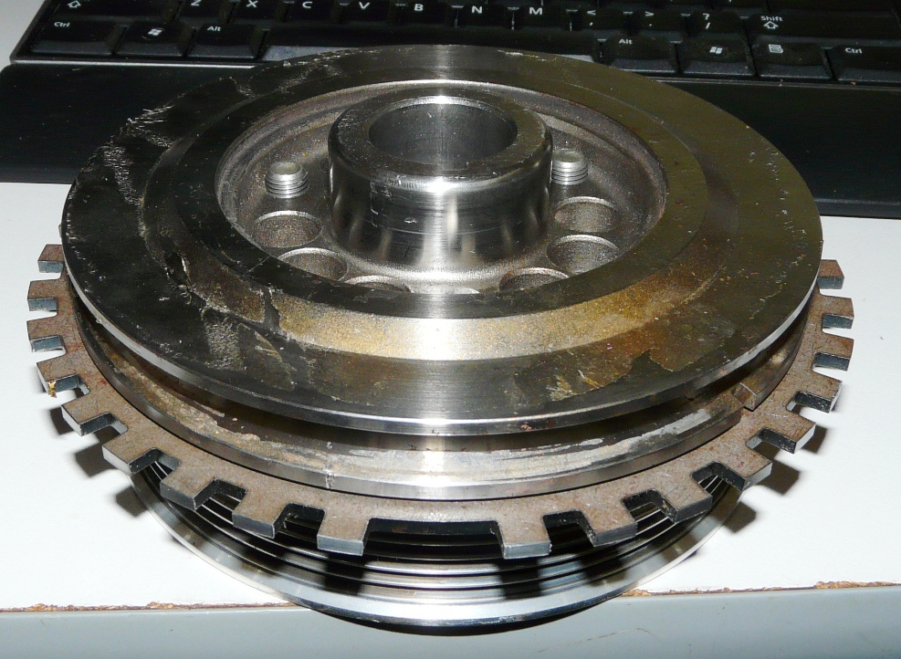

i wouldn't recommend machining the balancer for a few reasons:
1. its hard to get the sensor close enough without the fan belt rubbing on it
2. the outer part of the balancer is actually able to spin on a 202 balancer so would eventually offset timing to the point it might not run.
if you are referring to cutting a wheel larger than the balancer then that is ok!
i've used the 36 - 1 trigger just larger than the balancer and it works very well, if you did the 6 + 1 one the same it should be sweet.

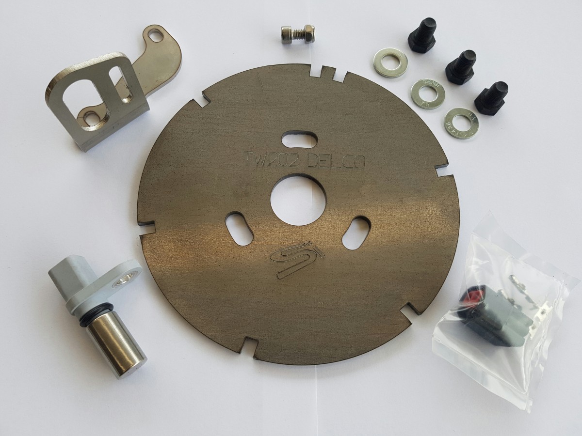

new trigger mount 2.jpg (257.91 KiB) Viewed 9036 times
if you didn't want to make your own, you can get a kit from here https://sonicinjection.com.au/product/t ... olden-202/

What is that serpentine pulley you are using from?
Also not sure whether to go for magnetic or hall effect sensor. From what I have read magnetic is easier to setup but may suffer from noise/interference issues. Most after market wheels seem to be magnetic yet the factory such as LS1, delco etc use hall effect.
the pulley is just a 6 inch unit from a chev that i found on summit racings website, i then got the balancer machined to accept its grove, and re-drilled the pulley to suit the balancer bolt holes.
