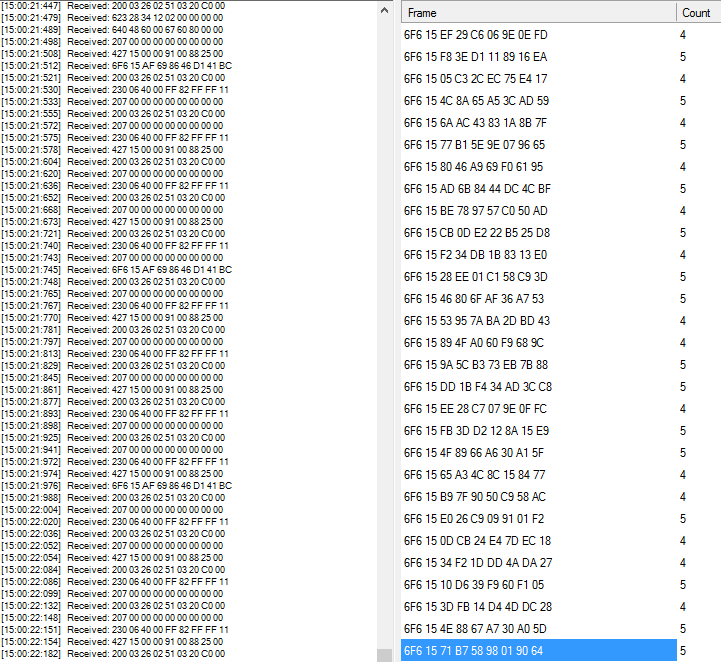

Thought it was kinda interesting to monitor the security chatter, seems to spit out 4-5 times of the same message then moves to the next.
I actually thought all that data came from the BEM, but its actually the ECU!
Also, the ECU I currently have on bench (BA 6cyl), comes up with a blank vin when reading.
Confirmed by monitoring at the same time, whats being read out is:
7DF 02 09 02 00 00 00 00 00
7E8 10 14 49 02 01 00 00 00
7E0 30 00 00 00 00 00 00 00
7E8 21 00 00 00 00 00 00 00
7E8 22 00 01 01 01 01 01 04
So its all blank.. except those ending bytes.
