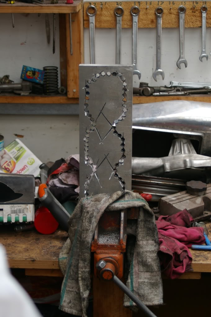

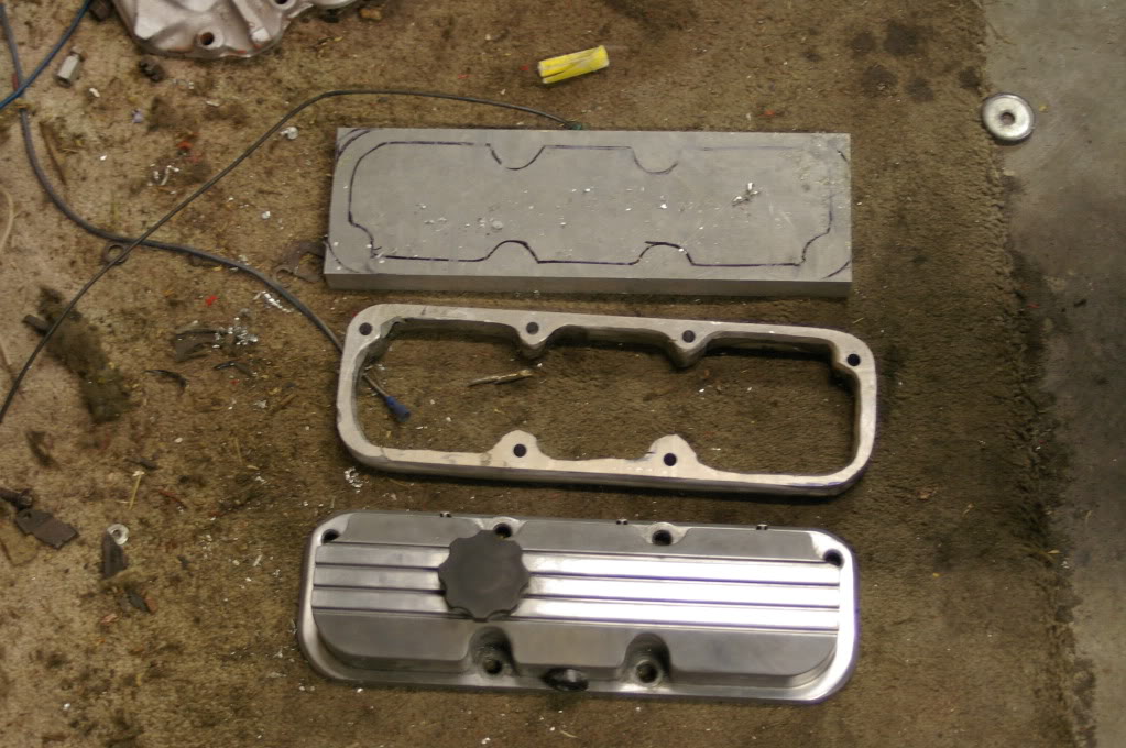

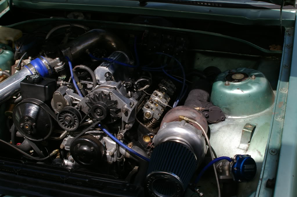

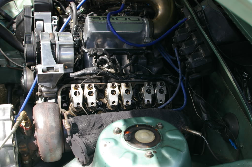

right the hunt for 10's in the VB has begun today started fitting the new 1.65:1 yellow terra shaft mounted adjustable roller rockers :cool: but to fit them we need to lift the rocker covers for clearance so begins the epic kiwi battle against alluminium in the trusty shed :biggrin:

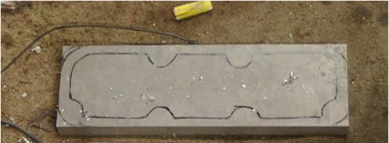

take a peice of billit alloy 25mm thick LOL and draw a shape

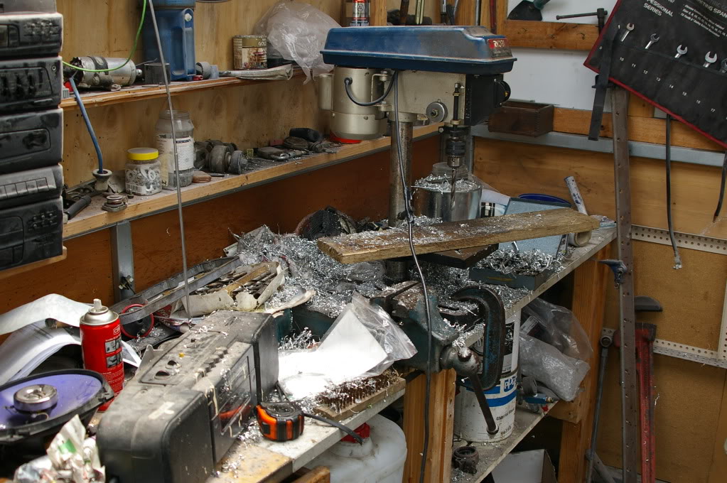

prepare the precision milling machine seen here mid use

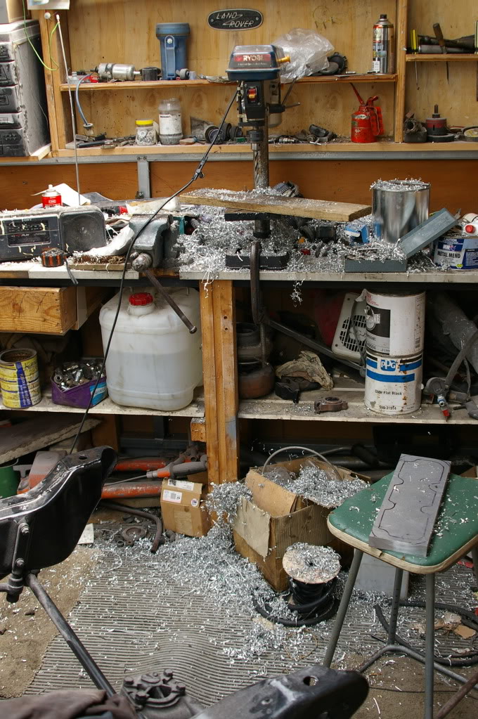

mid alloy battle fallen soldiers everywhere and i mean everywhere but we are winning LOL
finish drilling all 107 holes with said precision mill and attack with 1mm cutoff wheel

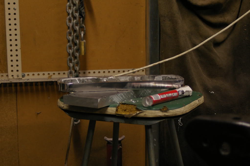

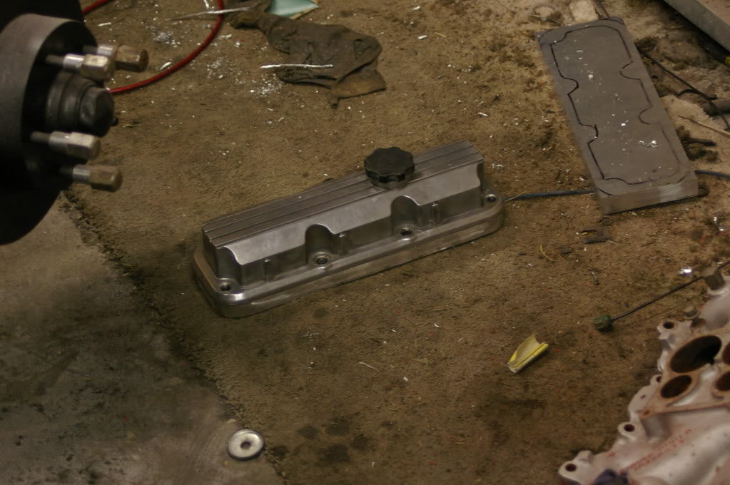

after a number of hours with the above tools and grinder and flapper disks you now have a spacer ready to polish but only after drilling yet another 6 holes LOL few only one more spacer to make :frown:
bit of a polish :P
not looking forward to the second one :tongue:
Re: DELCOS NEW RIDE
you can actually buy the aftermarket alloy tappet covers which come with those spacers :P

soon to find out :P they did something it idles way different when we started it without covers on :mrgreen:
Re: DELCOS NEW RIDE
wouldn't be the breather hose on the tappet covers changing things ?

lots of drinks mate lots of drinks LOL. rockers should gain us 1.2mm of valve lift bringing us up into the sweet spot at 0.495" lift or 12.57mm i can tell you there isnt much room left before coil bind on the springs :mrgreen: just hope they havnt made the ramp rate of the cam too hard out with the extra ratio.should hopefully eliminate any rocker flex if we had any a head cam and inlet 350 chev can gain 17hp with roller rockers over stock pressed steel rockers with the same ratio and 22-27hp with 1.65 compared to 1.5:1 so we may just gain a little when all said and done :mrgreen: find out tomorrow might even spool the turbo differently

delcowizzid wrote: 350 chev can gain 17hp with roller rockers over stock pressed steel rockers with the same ratio and 22-27hp with 1.65 compared to 1.5:1 so we may just gain a little when all said and done :mrgreen: find out tomorrow might even spool the turbo differently
That'd be because the stockers are notoriously innacurate with what the 'actual' ratio is.
