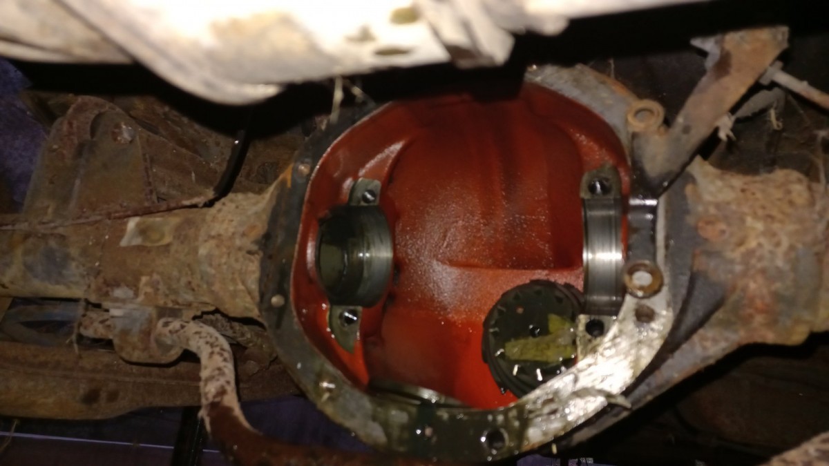

Jumped into the cabin and removed a few items there and then it was onto the main parts required for the VT. First job was to jack the old girl up so I could get access. Normally this would be easy but the old girl is very suspect structurally and my driveway concrete is crap so the jack doesn't roll to well but we got there in the end. Time to get the diff and gears out.
Got the diff cover off and drained the oil. Oil still looked good, green and not contaminated except a little at the very bottom of the housing.
Pulled the axles and dropped out the center.
I also noticed the diff housing has been painted on the inside, never seen this before? I haven't cleaned anything, just drained the oil and popped out the center.
Got out my little LSD testing rig and tested the unit. Averaged between 160-180Nm to cause the LSD to slip. Not bad considering it has been abused in my years of driving.

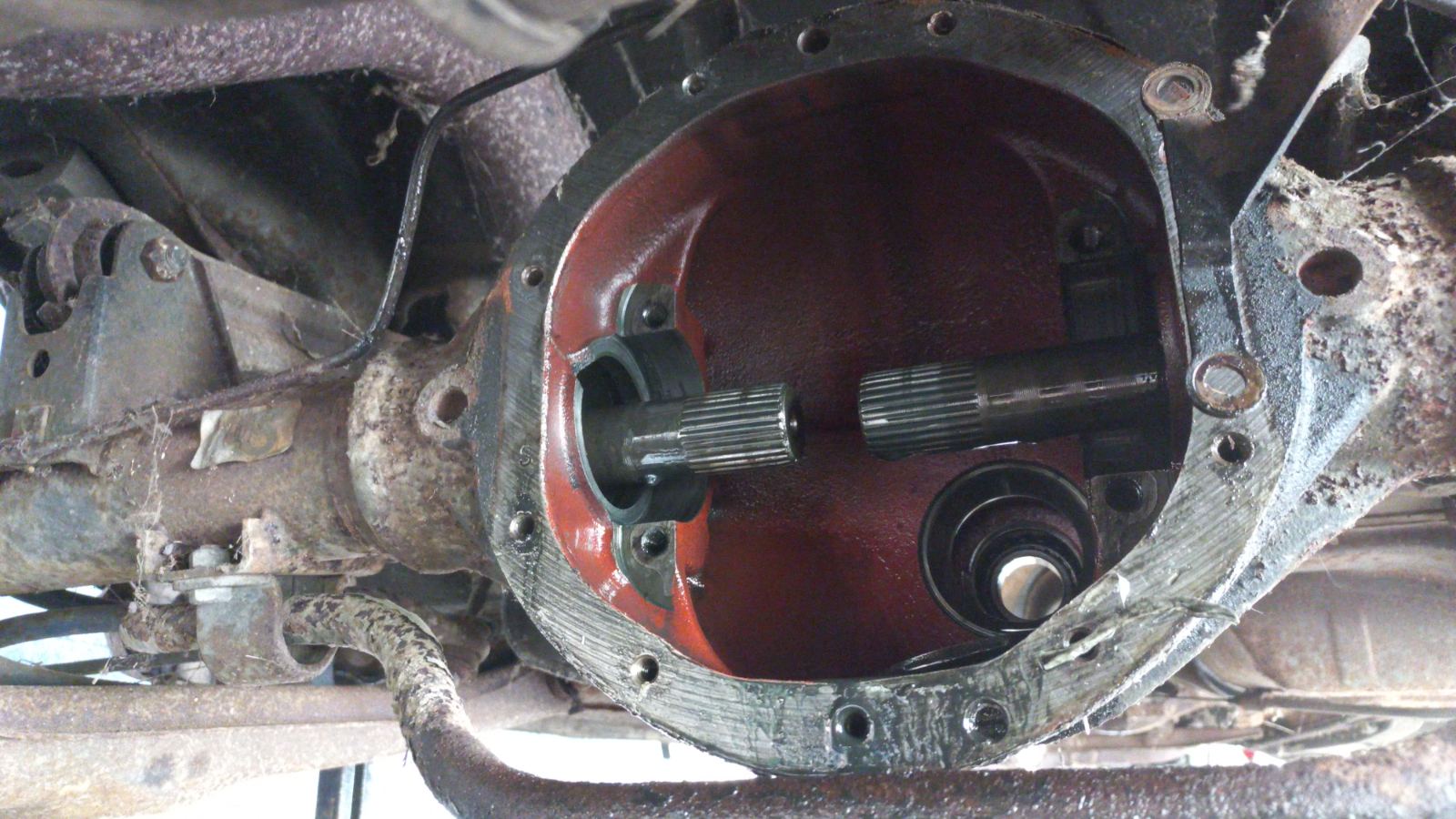

Didn't get much done today, Pulled out the driveshaft (forgot to get my spare slip yoke) and now have a large patch of transmission fluid under the car. There was also a lot of oil between the diff and driveshaft flanges. The Pinion nut didn't seem that tight and the flange pulled off the pinion splines by hand (which were saturated with oil).
Re-assembled the rear end with the new bluetooth center. Have listed the car as a wrecker on Trademe as well as some various parts. Hopefully it'll be one soon and then I'll have room on the driveway for the VT.
