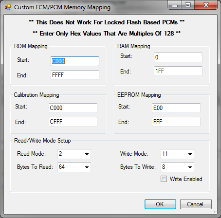

Got one now. Flashtool can read it fine, it wont be detected as a Kalmaker device (its not easily possible with how the flashtool works to ID either as the bin has no identifiers) but when you get the popup asking for custom memory mapping use the following settings to allow read and write...
SP2 Read.png (36.49 KiB) Viewed 6032 times
To setup the flashtool in the user preferences select the vehicle type (OSE 12P '808 for VN and VP or VR in Vehicle for VR and VS manuals), the interface type and lastly untick "Validate File Before Writing" and it will allow bin writing.

Good work! But I'm not getting that far as for asking for memory mapping. The car will run off the real time board.
When ecu is powered up the tx led is on (red) when trying to connect the rx led blinks.
Maybe my settings are need altering, should I post a screen shot of the log and settings?
