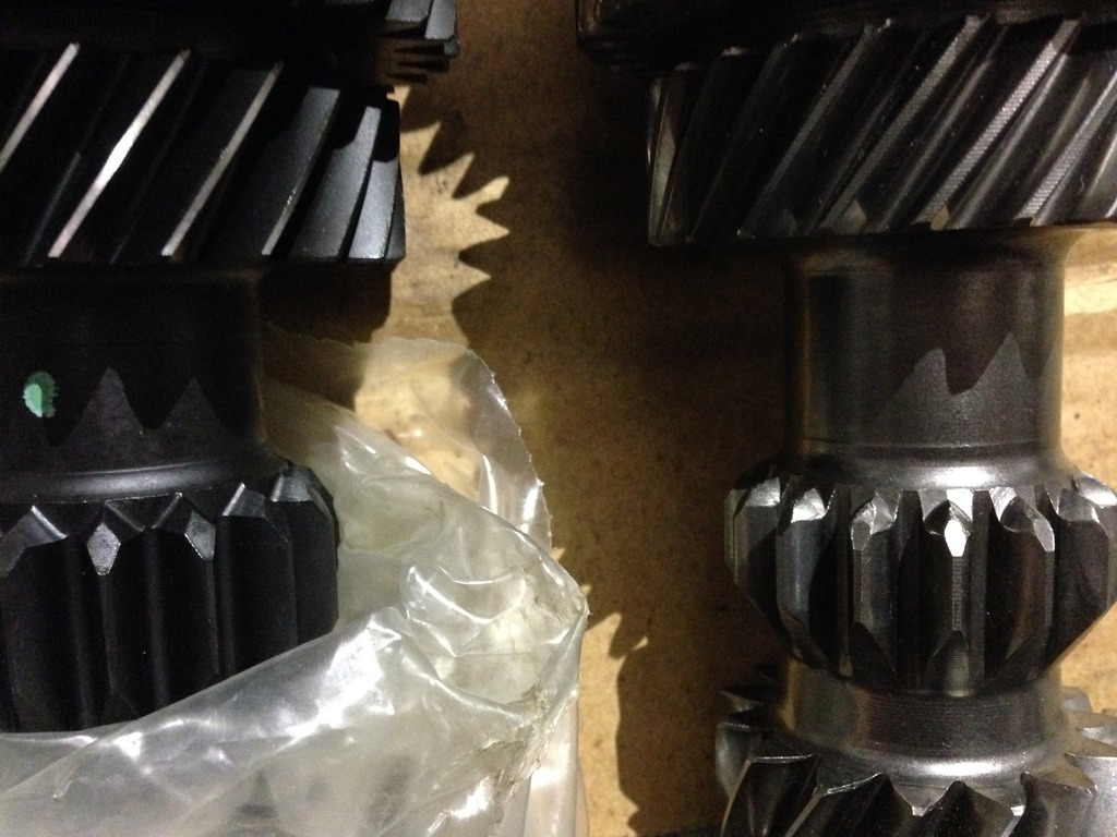

other news the gear set arrived. very happy! input shaft meshes perfect.
My hypothesis of the profiles being different for the clusters on the same tooth count/ratio was correct, they don't mesh at all lol.
So when replacing the cluster you must get the correct corresponding matched gears to suit even if the tooth count and ratios are the same.

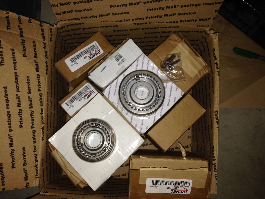

gear set is here, so sorted all the new bits to make sure its all going to work and put them in a box for now.
picked up the plated bits. Don't really need half of the stuff as my vacationer box was very clean so what I don't use I will put aside for future use.
now you can see the difference in R teeth. note the diamond shaped face on each, old one munched up a bit.
