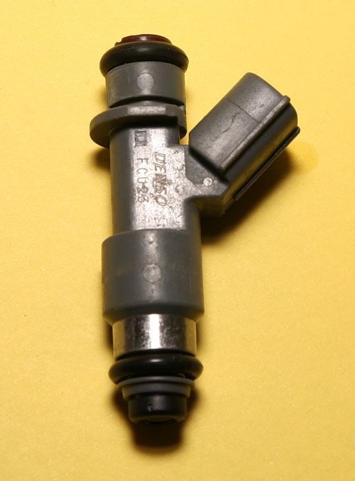

here's this denso injector, part numbers are 12594512 which is a GM number and denso is 063078720 there appears to be 2 versions of this injector, 36lb which is 4 hole and this one. But pretty much no info around about it, i have a set of 6 on the way which i will fully test and see if these are indeed OEM or Factory Denso.

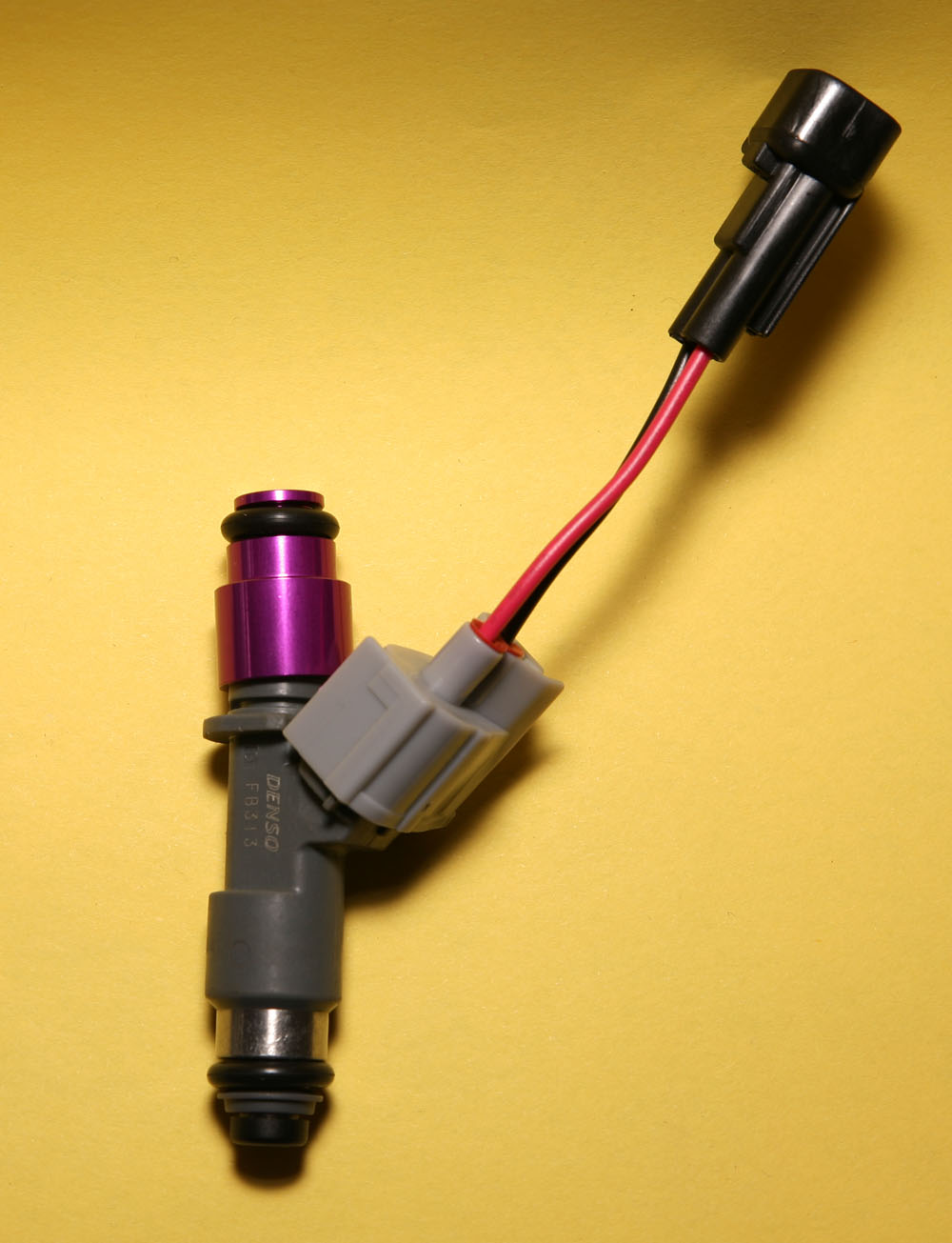

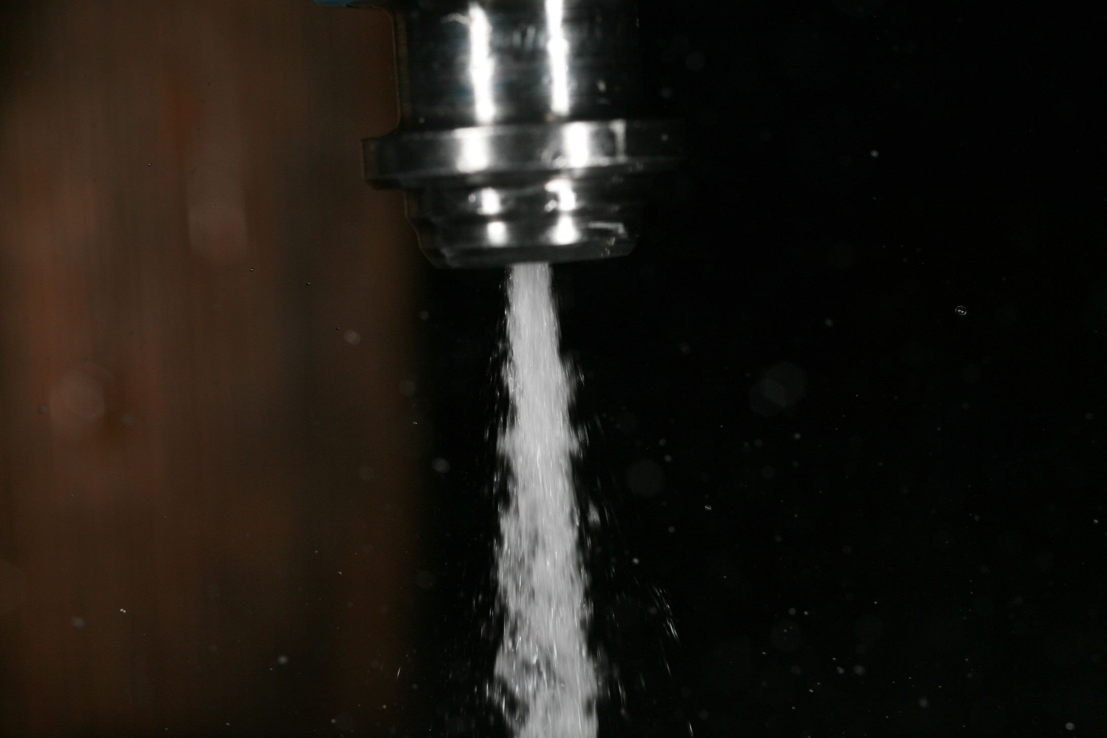

Have been testing a new Denso injector on a turbo ecotec for the last couple of weeks with good results, the injector needs a 14mm extender and a loom gender changer from Denso plug, it's a nice 12hole output, it's 81LB @ 3.5bar, pics below. Have just flowed a batch which i will put up on ebay, prices are very good.

Re: Injector Flow Testing Data
Thats a great spray pattern especially for the flow. They'll sell real quick. Got many?

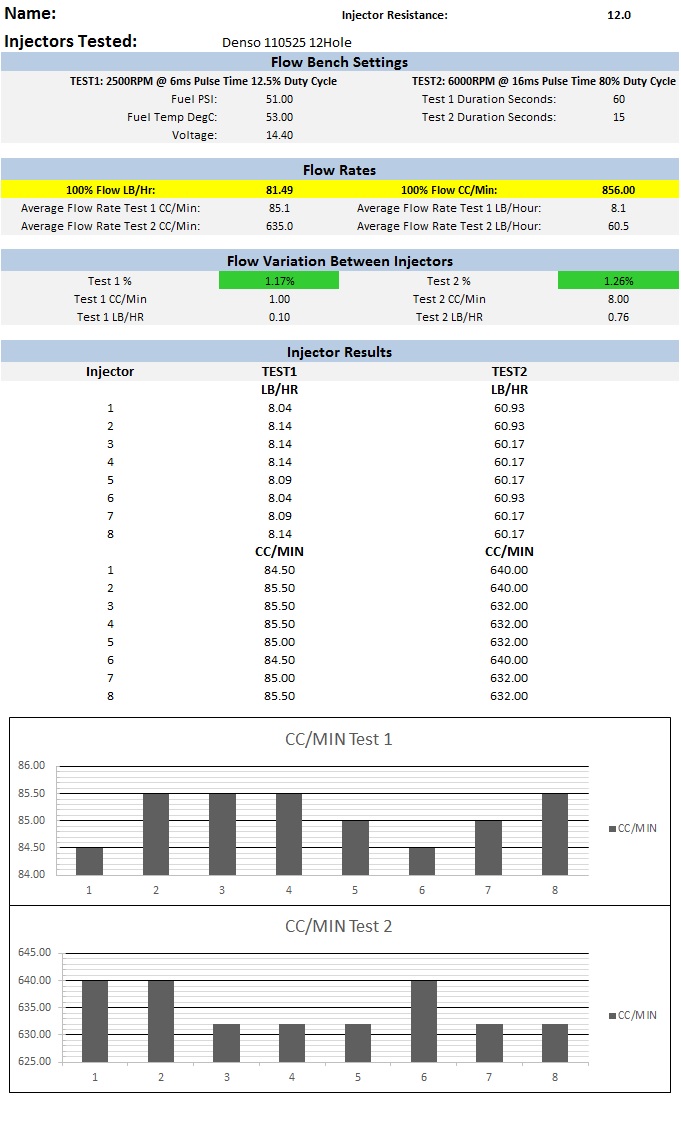

I have so far done testing in the one car, they fit perfect in ecotec manifold, i have done the deadtime testing also so the data comes with the injectors, i have a set of flow matched 6 and 8 see flow sheets attached, with 14mm extenders and adapters for either ev1 or ev6. For pcmhacking members they would be $295 and $360 i have someone getting back to me on the set of 8 no one yet on the 6, if these dont sit to long i will think about making more sets up.
