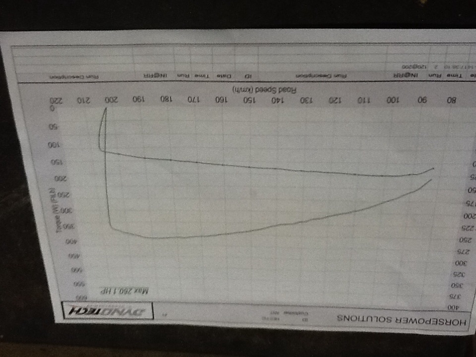

We made 260.1 hp tonight. One problem though, clutch is stuffed! Fuel only has been tuned, and only a little bit of timing, so hoping to see some more gains with a new clutch. Makes lots and lots of nice torque and it comes on strong straight away. It would be great if it made 300.

Anyone have any thoughts on what may be the most we could get out of this thing running the same basic configuration?
