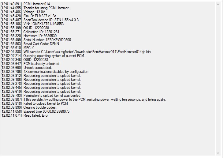

Attempting to read a 2003 SRV 12576106 HDW 12570558 PCM (P59?).
Get a timeout error. I have done several p01's before this no problem. Thanks in advance for any assistance
[06:52:29:822] PCM Hammer 014
[06:52:31:214] Voltage: 13.2V
[06:52:31:222] Elm ID: ELM327 v2.1
[06:52:31:262] All Pro ID: Copyright (c) 2009-2018 ObdDiag.Net This is free software; see the source for copying conditions.
[06:52:31:342] All Pro self test result: PWM wiring is OK VPW wiring is OK ISO9141/14230 wiring is OK CAN wiring is OK
[06:52:31:350] All Pro firmware: 1.22
[06:52:31:550] Thanks for using PCM Hammer.
[06:52:44:294] VIN: 1GYEK63N43R234520
[06:52:44:390] OS ID: 12593058
[06:52:44:438] Calibration ID: 12579403
[06:52:44:486] Hardware ID: 12570558
[06:52:44:638] Serial Number: 2CC1WZR23042
[06:52:44:702] Broad Cast Code: YCTJ
[06:52:44:750] MEC: 0
[06:54:05:407] Will save to C:\Users\Greg\Desktop\stock tunes ebay pcms\2003 86YCTJ923042WZR2.bin
[06:54:08:872] Querying operating system of current PCM.
[06:54:08:920] OSID: 12593058
[06:54:10:432] Unlock succeeded.
[06:54:10:488] Attempting switch to VPW 4x
[06:54:10:576] Module 0x10 (engine controller) has agreed to enter high-speed mode.
[06:54:12:952] Requesting permission to upload kernel.
[06:54:12:992] Upload permission granted.
[06:54:13:560] Kernel upload 9% complete.
[06:55:11:217] Failed to upload kernel to PCM
[06:55:11:321] Clearing trouble codes.
[06:55:12:537] Elapsed time 00:01:02.0735573
[06:55:12:537] Read failed, Error

Hey guys,
Had success reading and writing with LS Droid, then my phone updated to android 11 and the app crashed... Downloaded PCM Hammer and gave it a shot but cannot get past the kernel. Have done every combination of power cycle, battery charger, etc. P01 ECU in a swapped car with almost no electronic equipment, Red ECU connector unplugged, using an OBDLINK LX and I have tried firmware from 4.0 to 4.7+ Attached is a debug log.
Thanks!
Thanks!
