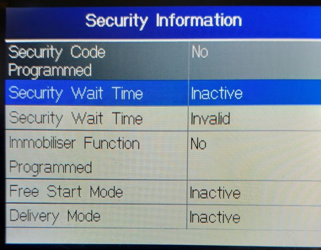

Messed with the kess v2, here's some CAN logs, not sure if there'll be anything of interest, lots of random chatter...... sorry.
Read takes roughly 1.5 mins, write a bit less and ID just pulls the security info.
CANBUS.7z
When I get some more ecu's that have faults but still have comms i'll mess with changing/cloning security details and get logs but it's a knockoff and has killed a few ecu's doing this so I'm hesitant unless it's sacrificial.
In case people missed it in other threads, the chockoff is a horrible flakey hit and miss piece of hardware with hacked drivers/software (with versions that don't exist) that will fubar an ecu.

Not sure what its reading in this section:
7E0 8 7 23 0 0 60 0 0 80
7E8 8 10 85 63 0 0 60 0 30
7E0 8 30 0 0 0 0 60 0 30
7E8 8 21 32 36 31 32 30 39 30
7E8 8 22 32 34 31 30 33 39 53
7E8 8 23 30 35 35 37 31 8 10
7E8 8 24 11 78 9 86 2 11 4
7E8 8 25 7 36 22 FF FF FF FF
7E8 8 26 FF FF FF FF FF FF FF
7E8 8 27 FF FF FF FF FF FF FF
7E8 8 28 FF FF FF FF FF FF FF
7E8 8 2A FF FF FF FF FF FF FF
7E8 8 2B FF FF FF FF FF FF FF
7E8 8 2C FF FF FF FF FF FF FF
7E8 8 2E FF FF FF FF FF FF FF
7E8 8 2F FF FF FF FF FF FF FF
7E8 8 20 FF FF FF FF FF FF FF
7E8 8 22 FF FF FF FF FF FF FF
7E8 8 23 FF 0 0 0 0 0 0
7E8 8 29 FF FF FF FF FF FF FF
Seems to be a completely different range to what normal read/write is.

Tazzi wrote:Not sure what its reading in this section:
HW Ver, Upg SW are in there.
This is also the ecu that is stuck/linked with 00 00 00 00 security pin.
Date SW is the date it was flashed with tech2.

Well success for resetting 00 00 00 00 ecm.
7E0 08 07 AE 7D 08 00 00 00 00
Posts: 4852
Re: VZ V6 E55 ECU Brute Force Reset Tool & PIM Relink
thats surprising, tazzis ecu didn't like it.
