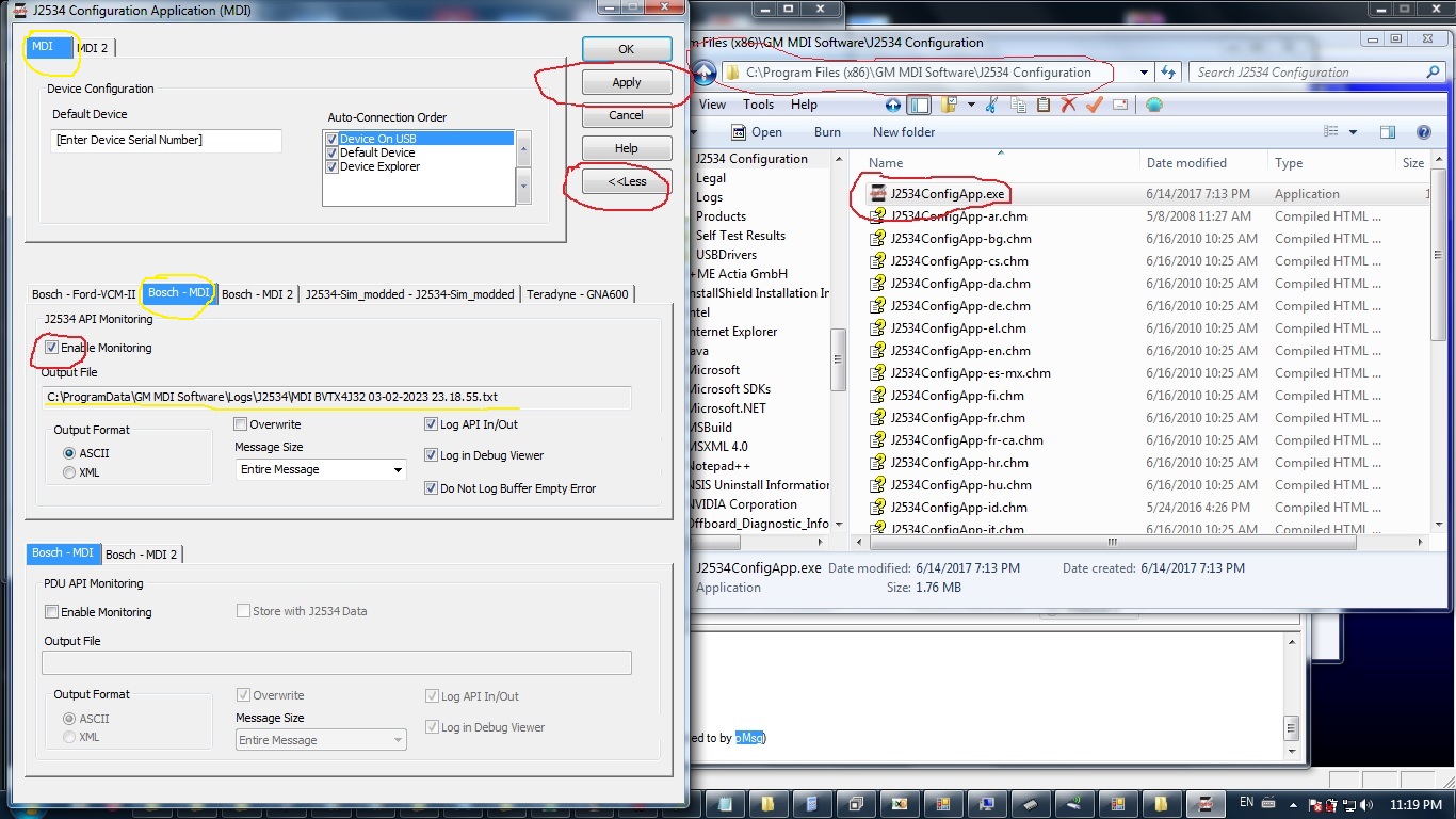

before you connect with tactrix device open the app
Follow the screenshot and click apply Leave app opened.
There will be a file and path where log will be saved.
After that do some data logging or CAN script with universal patcher using tactrix device.
Log will be filled when you use the device.

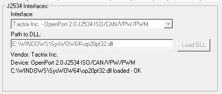

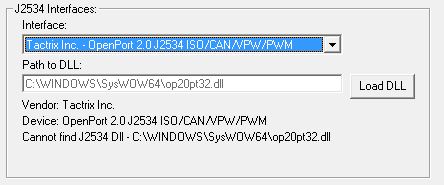

I'm also getting an error in DrewTech:
The file is in that folder, and it works find when I disable the monitoring.
