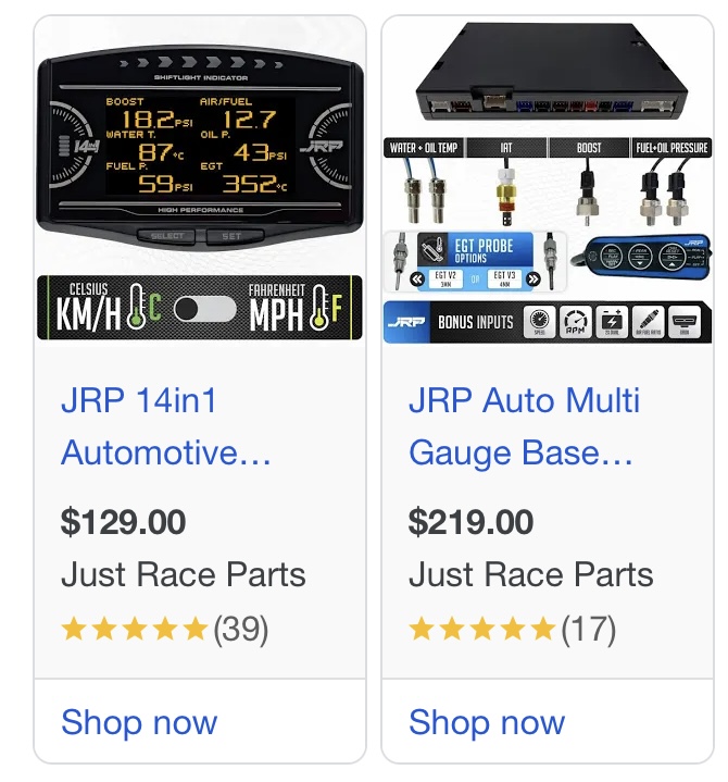

I’ve also got to incorporate some jrp 14 in 1 gauges. So things like exhaust manifold pressure, egt’s, afr’s, fuel pressure, oil, pressure, temperatures ect ect. Monitor boost pressure before and after the intercooler as well as temperatures. I don’t really want gauges everywhere in the car but I’ll need to monitor everything until I’m finished. So that kinda gives an indication of where I’m heading 👌😎

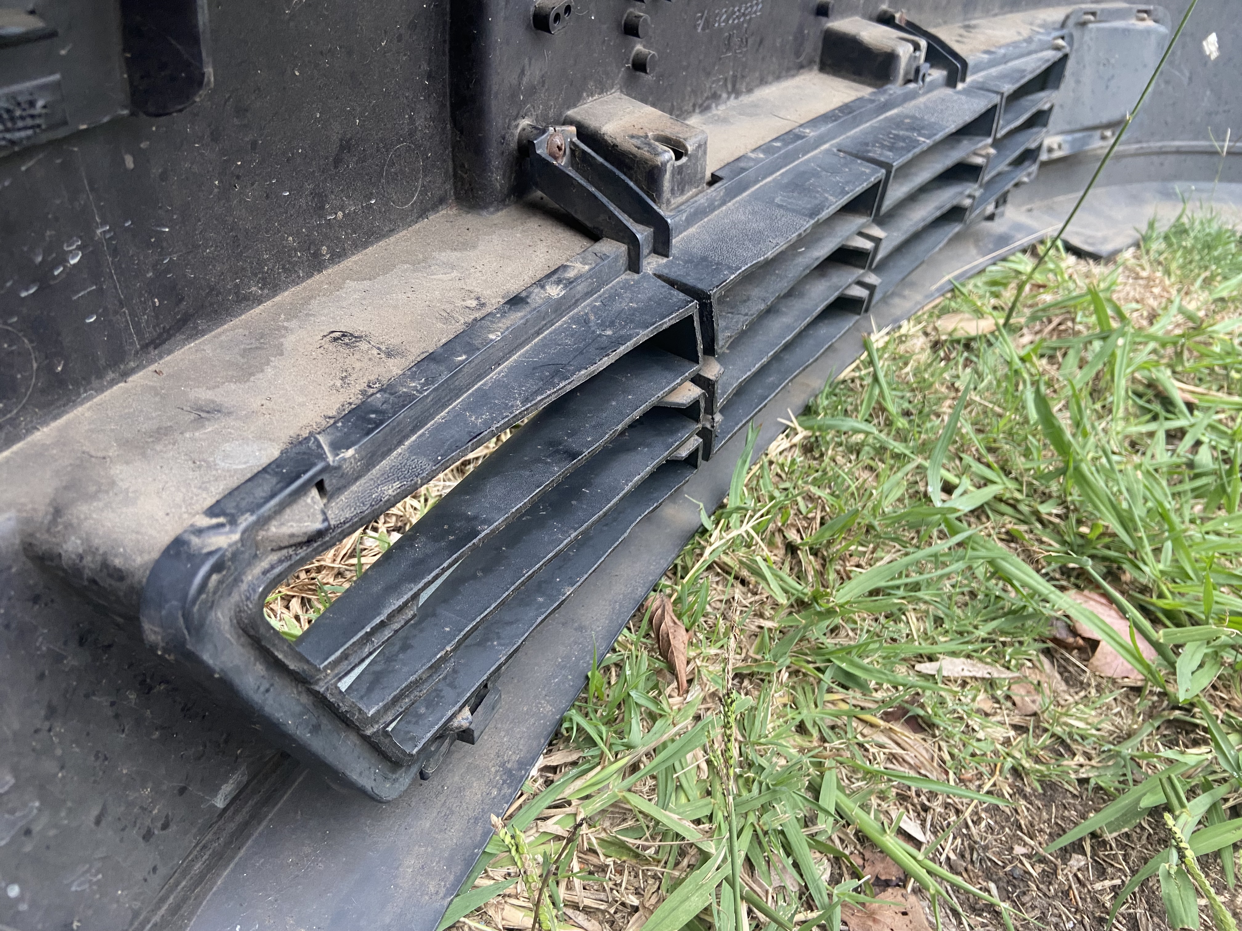

Thinking something like this printed in some better colours would be a cool touch 😎
Posts: 3820
cars: VS,VT,VX,VE
Re: Vy commodore
Nice!
Posts: 2678
Re: Vy commodore
That's pretty cool!!

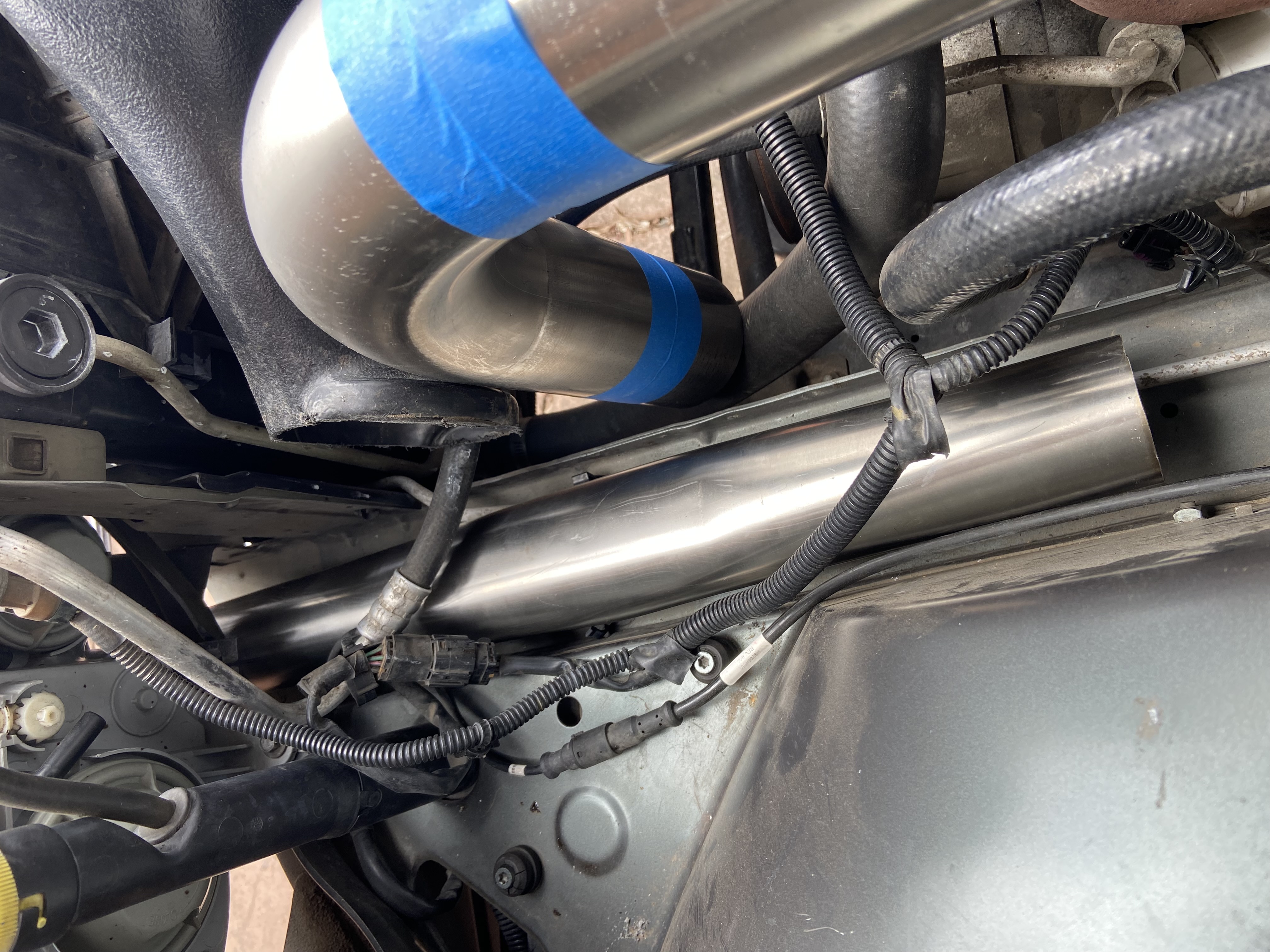

Not much progress lately as I’ve been sick. But managed to get a little more done. New top intercooler bracket done. And some more progress on the bumper support. Remembered to take a picture of the bar insert that I grinded back to give me clearance for the intercooler.

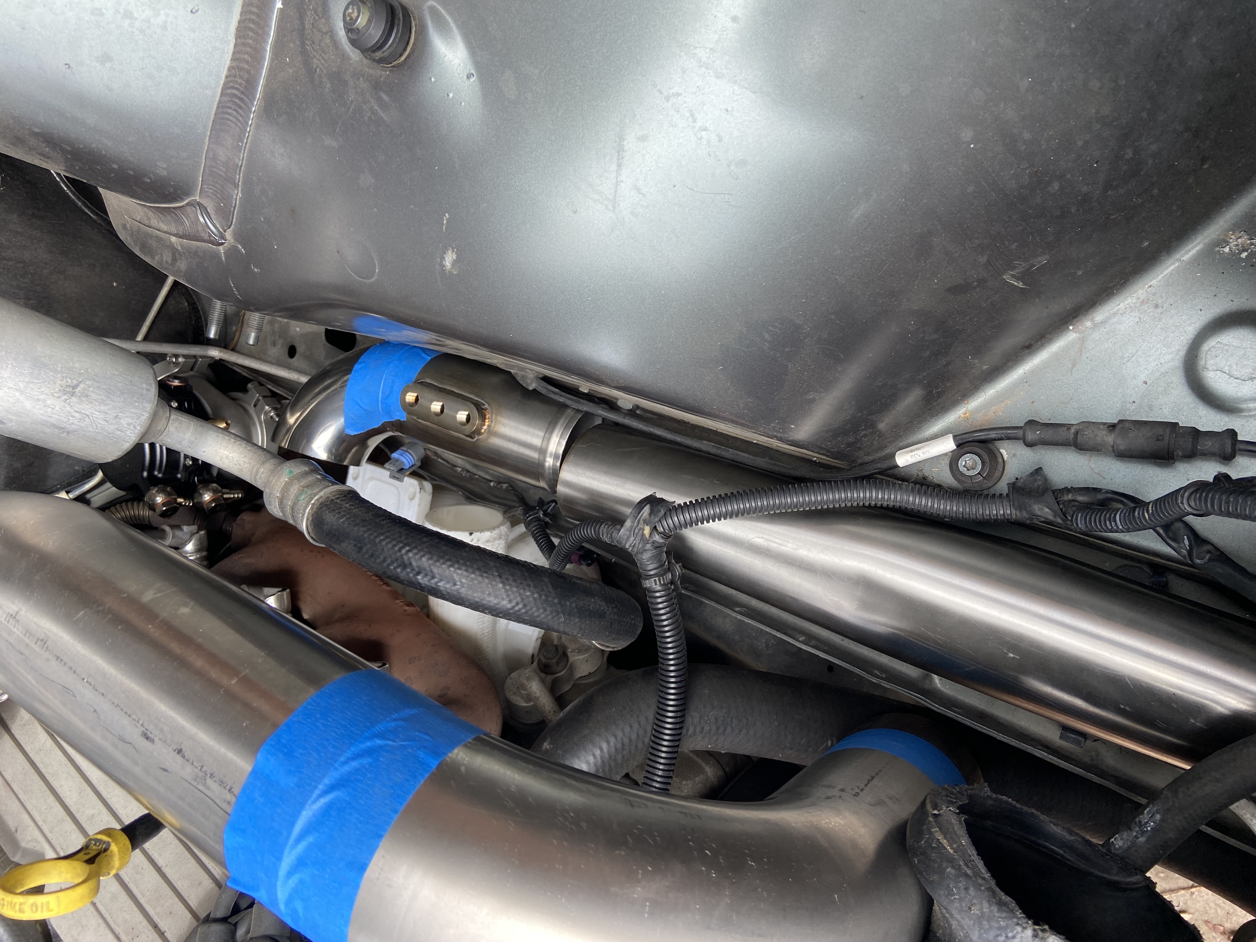

Had to put a slight dent in the hot side intercooler pipe, to clearance it for the engine crossmember bolt that protrudes through the chassis rail. Ended up just marking it out and chucking it in the press with a socket.
