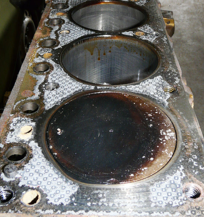

you can also see in the above picture that there is still plenty of hone marks in the bore so it doesn't seem to have worn too bad, not that i was expecting it to have done as its only been together for about 30-40,000kms in the street car before it went in the gemini for the track so hopefully the bottom end will just be a rings and bearings rebuild!
also i am quite happy with the way methanol has treated the motor, theres very little corrosion issues, and the castor oil in the fuel seems to be doing its job, all the inlet ports and valves are all nicely coated in castor oil so happy with that - i will have to pull the injectors out and see how they are in the filter area and such!
