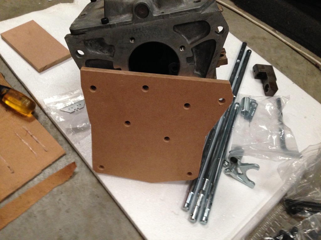

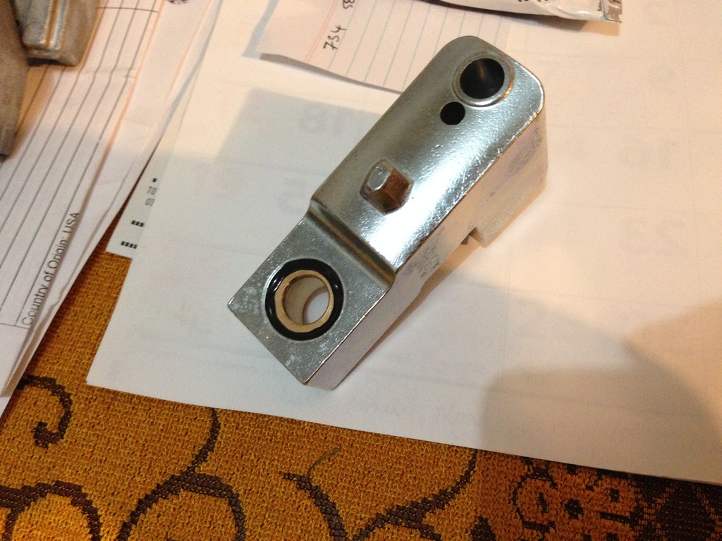

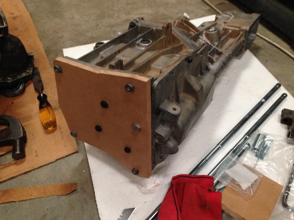

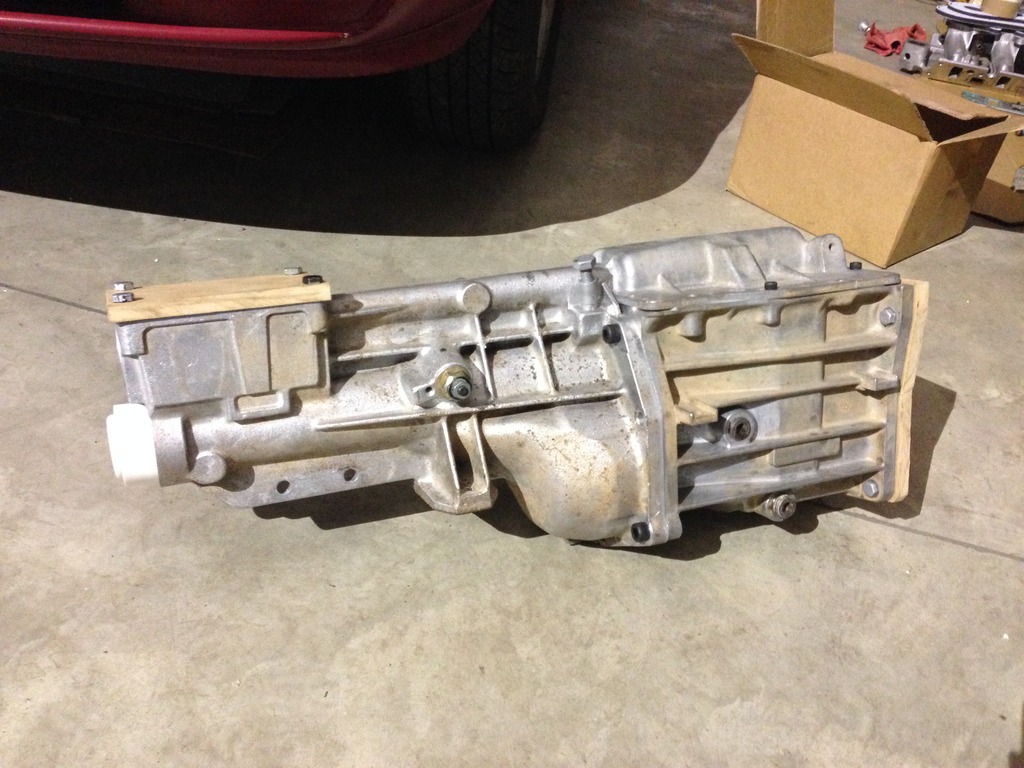

Anyway some more progress.
epoxy'd the shifter bush in.
The box is just about ready for the blaster.
Just need to get 2 cap head screws M16 X 1.5 to block the reverse switch and reverse pivot bolt holes.
Quickly made up some masks from 12mm MDF for protection from blasting and so I don't get a ton of dust in there, especially the shifter area as there is lots of trap areas in the detent plate which is virtually impossible to clean out.

Do you reckon mdf will stand up to blasting ?

HQ355 wrote:Do you reckon mdf will stand up to blasting ?
Yep. I normally use duct tape but it's fiddly and time consuming and often peels off before I even take it to the blaster.
