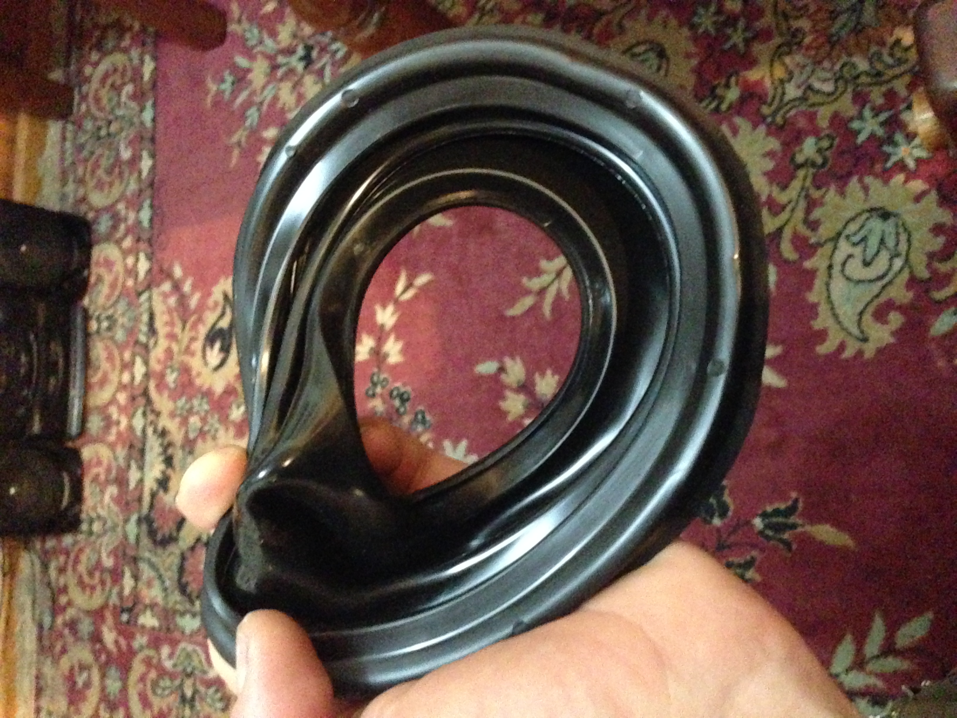

Finally found the elusive VL-VN s1 polychloroprene? outer plate boot. I have one of these stashed already for the VP S but has been very hard to find another for this car, I actually need a 3rd for the VR in the future as I am finding not so old 4blok repros completely fucked in wrecked cars and conversions floating around for say as of recently, must be made from cheap china rubber. My VR has one of those in it as it was the only option at the time and it will probably perish sooner than latter.
http://www.ebay.com.au/itm/GENUINE-VL-V ... SwhMFXlF2g
Problem with the later VN s2 onward outer plate boot is that it was of a different design and rubber type probably natural rubber and have all long perished from ozone cracking.
Interestingly the inner plate boots are all made from the same resistant rubber, so there is a massive surplus of them around. I have like 6 of them including NOS one which I'll probably never use them all.

- Posts: 8124
Plate arrived so I harvested the boot I was talking about.
Still like new! Can see now pliable and shiny the rubber is.

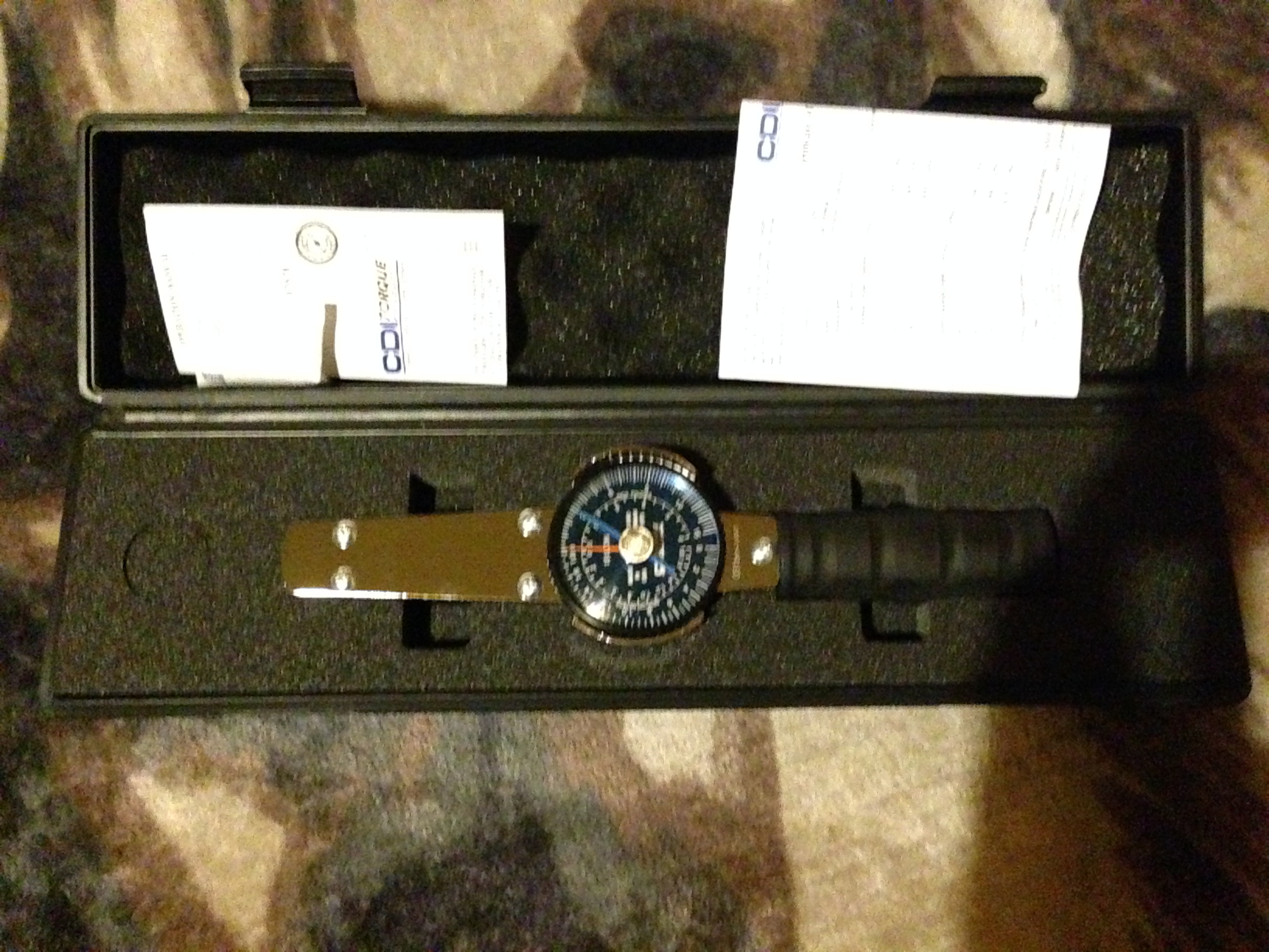

- Posts: 8124
Picked up my torque wrench.
